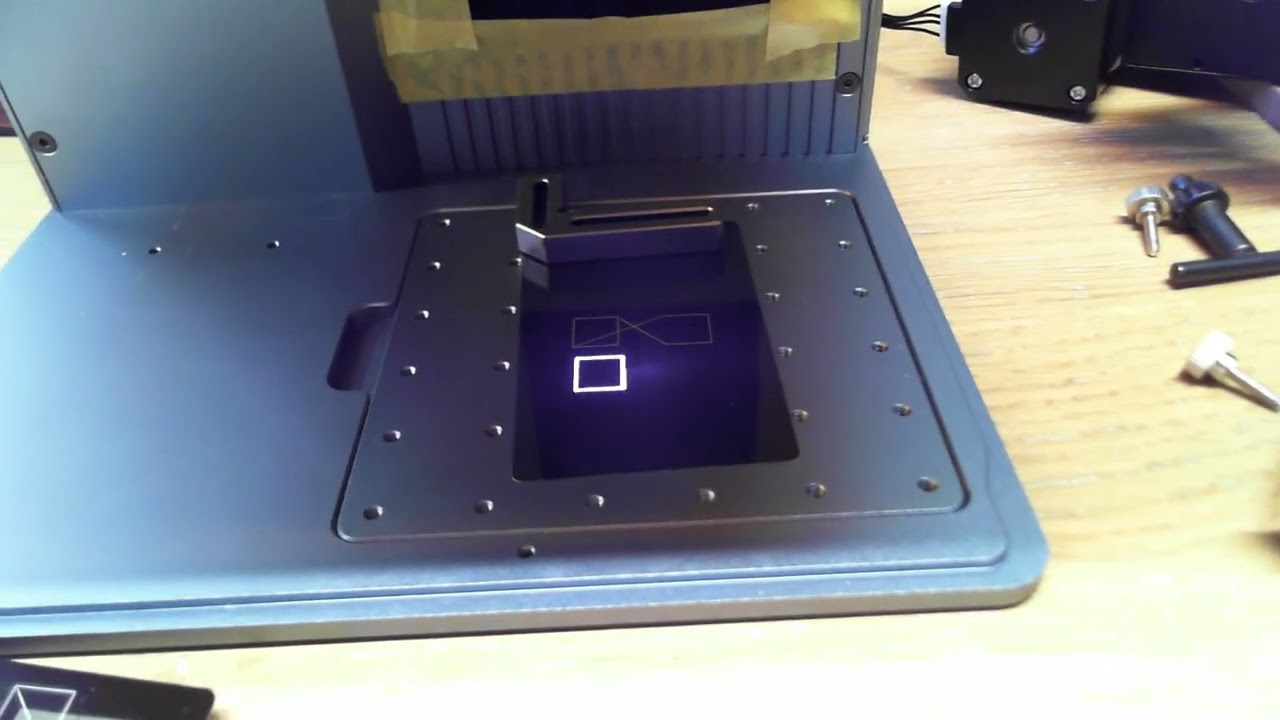

The Sculpfun G9 galvo has only recently had full Lightburn support but I’m finding some odd behaviour with framing that I’m hoping can be resolved.
The issue is that while framing works as expected most of the time, every now and then it does something odd like increasing the power output so it marks the material or uses the IR laser instead of the usual blue light at low power.
Not only is this ruining material but is also dangerous as the enclosure is up when framing.

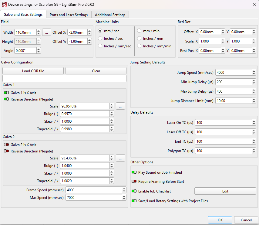

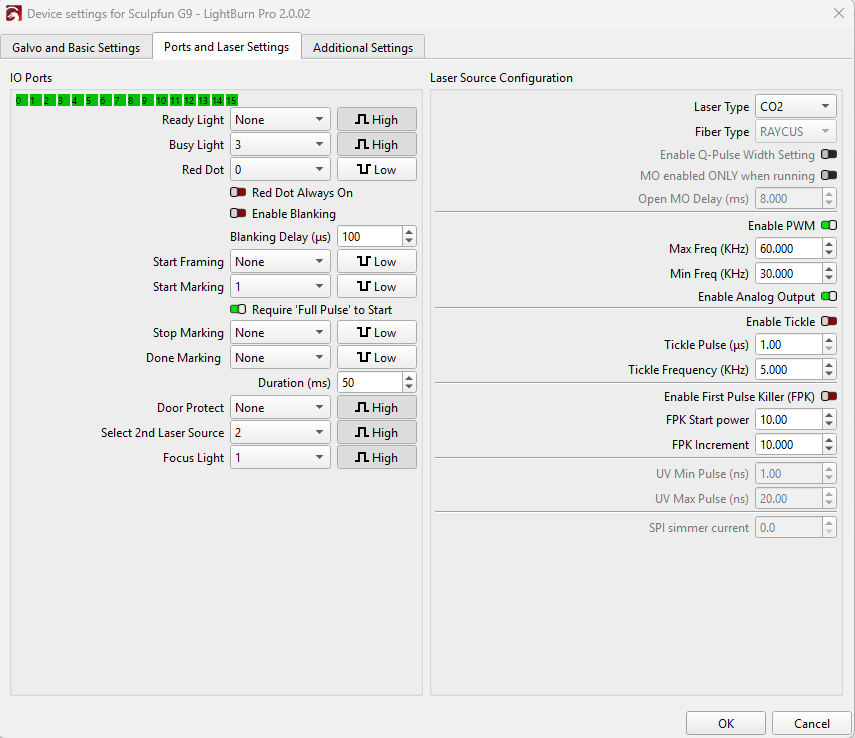

I’m using the device profile and settings provided by Sculpfun but I’ve attached screenshots of the settings as maybe something needs to be changed.
Something else I have noticed that may be related is that after framing if I try to focus the machine the 2 dots won’t line up. Turning it off and on again resolves that.

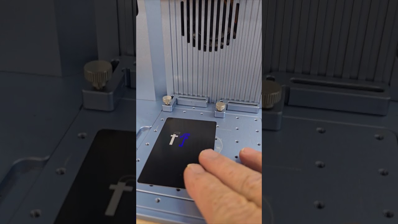

Before Lightburn 2.02 it would happen if you framed a job, stopped the frame and then framed again. That pretty much always caused the IR laser to turn on rather than the blue light, like in this video by another user.

Do you see anything in my settings that differs from yours?
Thanks
My settings seem very similar. I uploaded my device profile here:
SculpfunG9_misken.lbzip (5.5 KB)
Maybe try if it works differently. Your issue seems similar to the ones that I thought should have been resolved in the latest versions.

I’ve made a video showing the issue
As you can hopefully see the first frame of the square object uses blue light but the second turns on the IR. After that all framing uses the IR, you can also see the new odd framing lines that started after updating to 2.04.
There is a bit of a pause as I reset Lightburn, then I run the square engrave using the IR (untick laser 2) and after that it allows multiple frames using the blue light again.
Turning the laser off / on reverts to the behaviour at the beginning, 1st frame BL, subsequent frames IR.

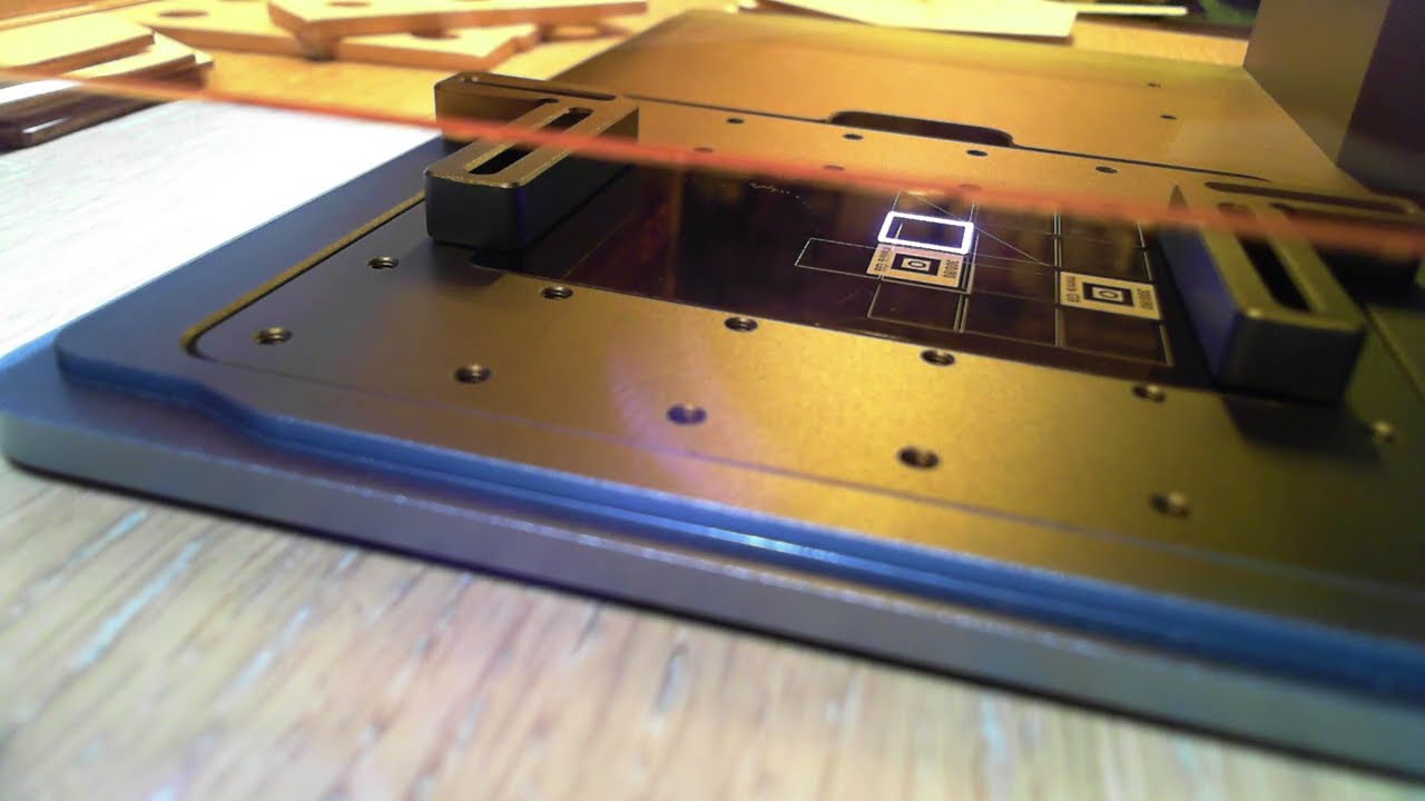

So Issue 1 is the G9 switching to the IR laser (laser 1) for framing after initially using the Blue Light laser at low power for the first frame.
Excuse the shaky video but I made a simple demo of engraving a single small square:
So the first frame uses BL at low power but on the following frames it uses the IR laser at a higher power which marks the material.
After running the square using the IR laser (laser 1) I can then frame properly again using the BL at low power, even after running the square using the BL (laser 2) as a job.
I can’t find a certain trigger that starts this behaviour but once it starts it will do it consistently even after turning the machine on / off.

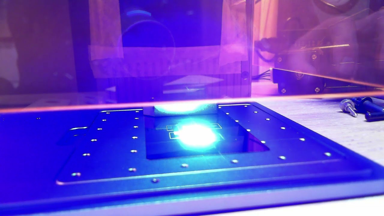

The second framing issue I’ve found is that if I stop a job before completing, it will then frame with the blue light at low power once but all following frames will use the BL at the power level set in the layer (think this was at 60%).
I believe this caused the changes in framing power as I haven’t seen that happen again outside of this second framing issue.

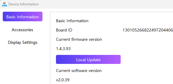

I’m sorry, I was busy the last weeks and had not much time to deal with my lasers. Just in case, here is the version of my G9 model:
Does yours look the same? The first batch of G9s had a different rotary port that was unable to take the slide extension. What does yours look like? I have the newer model with the current port.
That works perfectly fine every single time.
No, it still frames normal.
