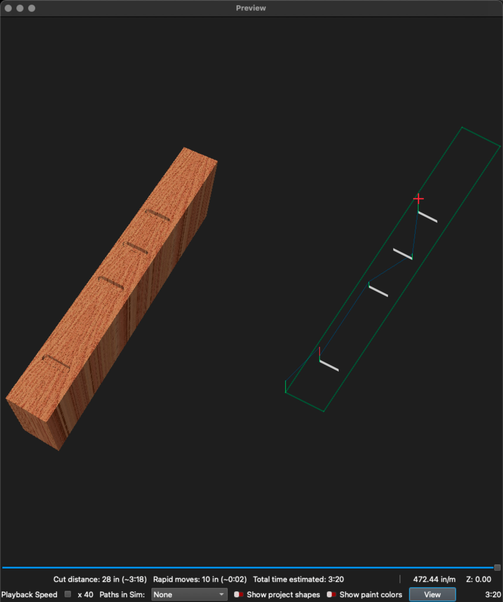

Five items selected and assigned to operation. Preview shows only four items. Have deleted three middle items. Duplicated either end item and placed in middle positions. Preview still shows only four items. What is going on?

When I mess with settings, I am getting strange results. More investigation needed…
When I copied the design into Lightburn to look for oopsies, I found none. I copied back into MillMage, replacing the original, and now the middle slot is missing.
Unpredictable usually means a bug.

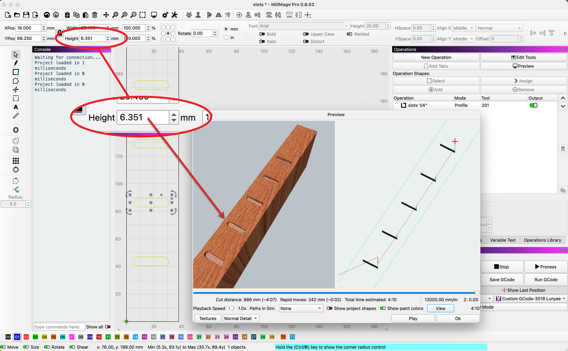

Well, that was not easy to find. There is a floating-point error on our side. The slot is 6.350 mm. The bit is 6.350 mm. For this one case, it somehow decides not to build the cut because it is microscopically over the limit (no error happens because the error fails to show as well). Identified in the report, and we will address.
To fix your file for now, I made the slots 6.351 mm wide, and the file will now produce as expected.

As a general rule, a pocket that is exactly the width of the bit will not work - Use a line, or make the pocket a tiiiiny amount larger than the bit, like 0.01mm.
This is normal, and likely to happen even in high-end CAM packages. If you offset the lines from the shape by 1/2 the bit diameter, the resulting shape has no area, so there’s nothing to pocket.
