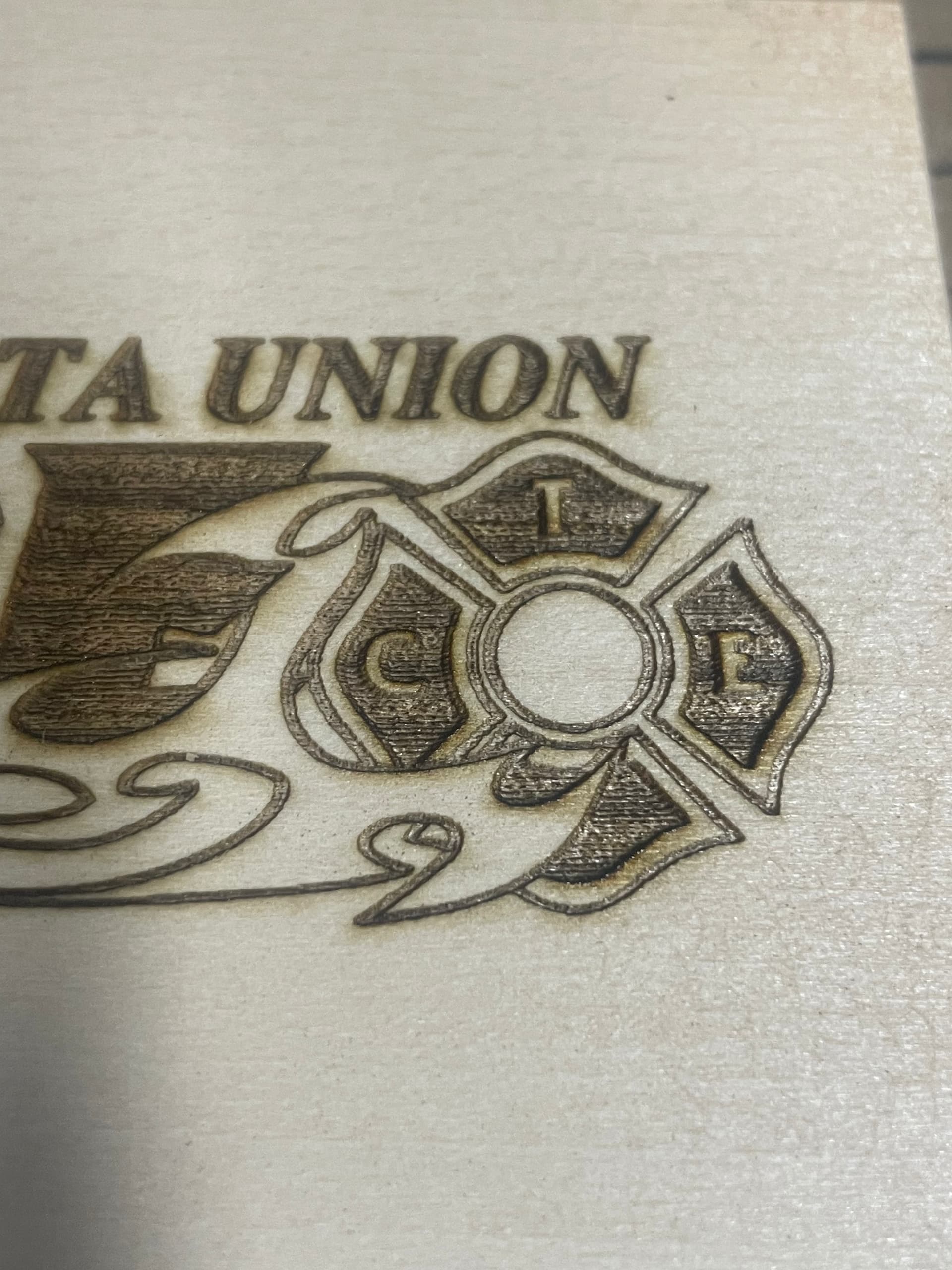

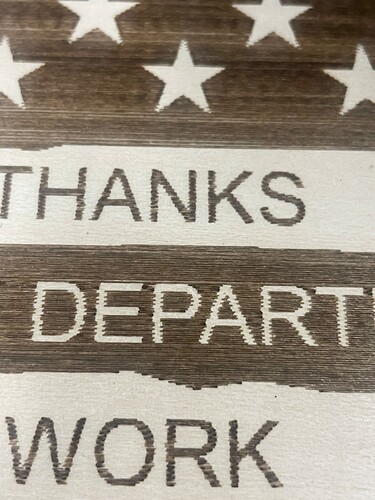

I have imported a DXF graphic file which I added some text lines to in light burn as well as a PNG file. The PNG file came out flawless but the rest was jagged. Any help with settings or suggestions would be appreciated.

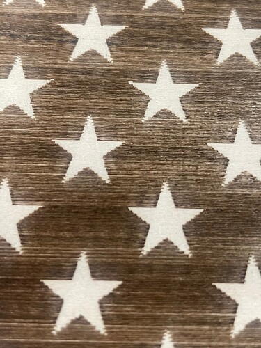

This looks like backlash. Suggest you try that. The last image doesn’t show this… are they at different speeds.?

Same speed. Kind of new to software. What is backlash?
