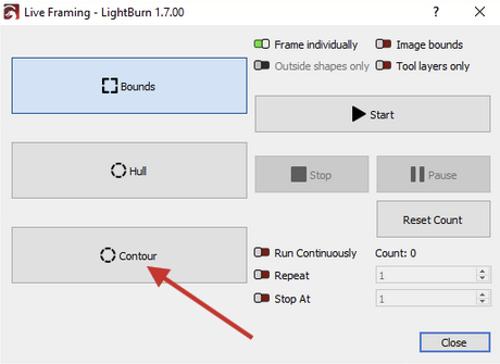

It sounds like you want to change the framing mode to “Contour”
Due to the limited speed of any galvo, it might still be easier to frame it accurately when using “Bounds” on more intricate shapes.
