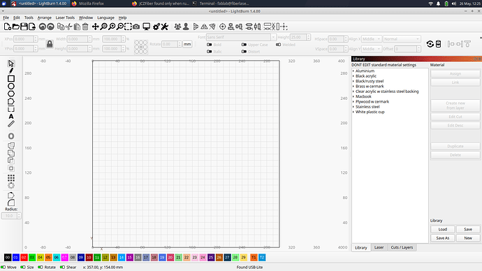

The screen shot that might help would include the laser window… that’s where all the connections are shown…
Under Laser, it shows Ready … the port is set to Auto

My options on the pull down port is auto or port#:1. I know what auto means… the other one I’m clueless as to it’s meaning…
