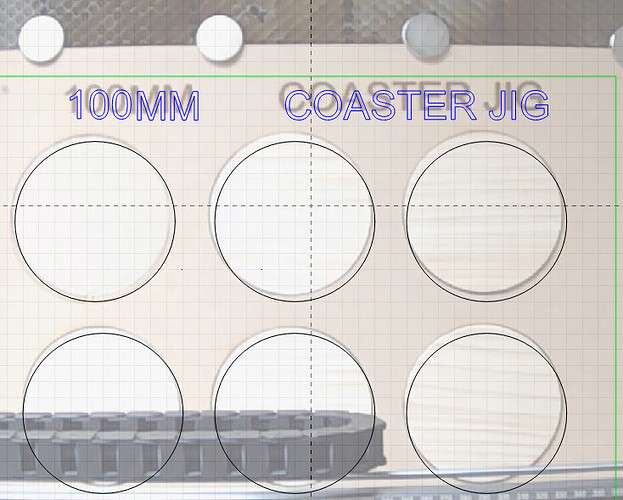

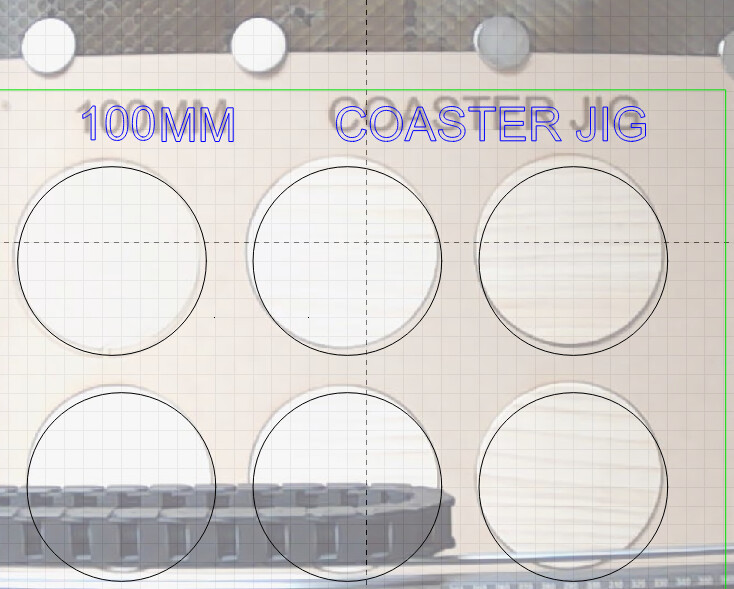

Anyone have this issue? I have a reference point setup for the jig, but after putting it in this morning, it doesn’t line up when I update the overlay. The honeycomb and laser gantry are in fixed spots so that is always in the same place.
Bit confused with this and whether if I now place what I am engraving on what is shown it won’t be a true reflection of the actual positioning of the item on the coaster and this will then start causing wastage of product.

Maybe you need to calibrate the camera again.
Anyhow, if you have such a jig, do not use the camera at all. The workflow using jigs is that you position your laser at a reference spot on the jig (regardless of where it is placed) and then start your job. Ignore the camera.
