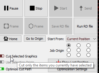

It’s not normal, but it’s not uncommon. Make sure all the plugs and electrical connections are securely seated. If anything is loose at all, or getting any kind of electrical interference, it can cause this.
You can’t start a job in the middle, though you can select just the stuff you want to cut, then toggle the ‘Cut Selected Graphics’ button shown here and re-send it:
