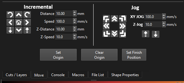

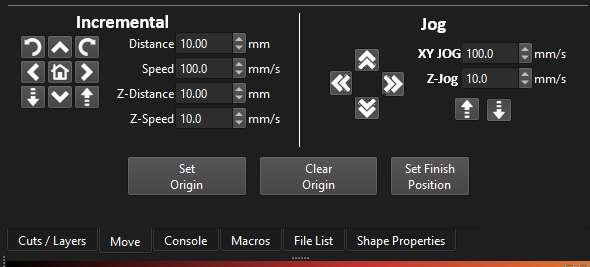

If I were to ask for a feature, it would be if jog mode is enabled in the settings, then a set of new buttons should be displayed on the move panel with separate Jog speeds from the incremental speed. This way I could quickly jog to the area, then using the incremental button and shift incrementally fine adjust the start position EDIT: I submitted a feature-request HERE: when-j-jogging-is-enabled-add-jog-buttons-to-move-panel
I find myself flipping between these a lot now that LB got the continuous functionality working in CNC-based machines. But I’m early with my usage of the new-to-me machine, so this may become less later when I use the system more.
Did you include diagonal jogging? :nerd_face:
$J=G91 X[distance] Y[distance] F[feedrate]
No but I will update it. Thanks for the suggestion.
