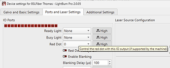

OMG! It’s working!
Turns out it was something SUPER dumb, and I have to admit that I resorted to using ChatGPT to figure it out.
The solution was to turn off the Red Dot Always On switch.
Apparently, if you keep it on, it always acts like it’s framing, and never activates the laser to do an actual engraving.
I literally tried every other switch!
Thanks so much for helping me out with this!
Your suggestions and guidance got me 99% of the way there, and I’m very grateful!
-Thomas

One interesting side-effect is that now that I have the red-dot (really violet) turned off, it doesn’t show the violet dot by default so it’s hard to get the focal length. (I usually do this by making the external fixed red dot align with the internal violet dot). I guess I’ll have to turn it on when focusing and then turn it back off when I’m engraving. Slightly annoying but still 100000000% better than using SeaCAD!
Does your machine actually have a red assist laser which goes trough the lens?
It would require a separate red laser diode with a beam combiner between the galvo head and laser source.
This section of our Galvo Red Dot Alignment video shows this part:
Not every UV source has this, but they are framing with the UV source instead.
It would require a very complex coating of a crystal prism, which:
  • reflects one wavelength (red ~650 nm)
  • transmits another (UV ~355 nm)
  • does not distort the UV beam quality
  • survives UV energy
The “red dot” appearing purple suggests that it doesn’t have an extra red dot.
Although importing the LmcPar.cfg file you sent earlier did populate the “Port 0” for “Red Dot control”!
This aligns with your screenshot of the SeaCad parameters.
Can you frame a job in SeaCad and let us know what happens?
