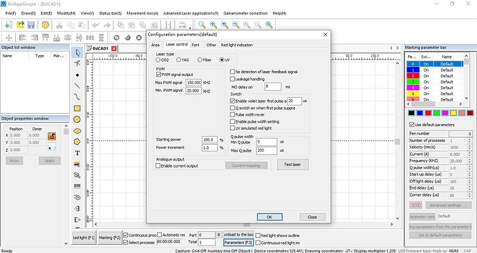

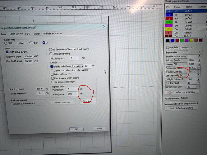

  1. I don’t seem to be able to connect at all. Or, at least I can’t tell if I am connecting.
    I have tried the “Find My Machine” but it just hangs and I have to restart lightburn.
    I have also tried to “Create Manually” with the new device wizard, but I’m not sure what controller I should use. I tried selecting JCZFiber and then selected UV as the type later on in the process. It looked like it might be the right thing to do, but I’m unsure. What should I select from the “pick your laser controller from this list” prompt? In the USB device tree I see cypress, SEA-LASER, SEATHINKING for the device, so I don’t think it’s an issue of needing a cypress driver.

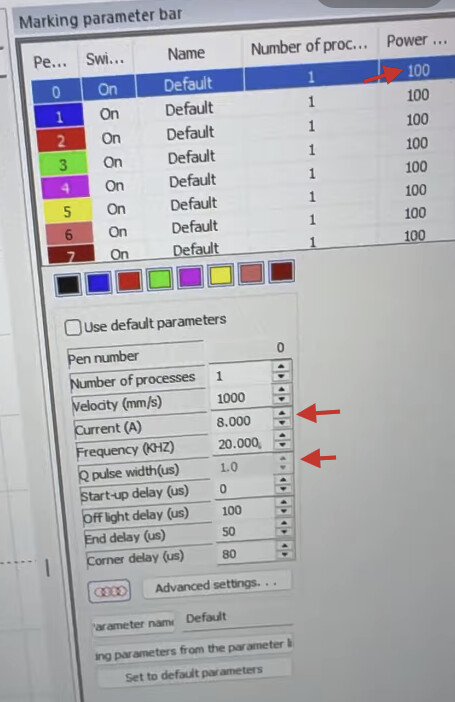

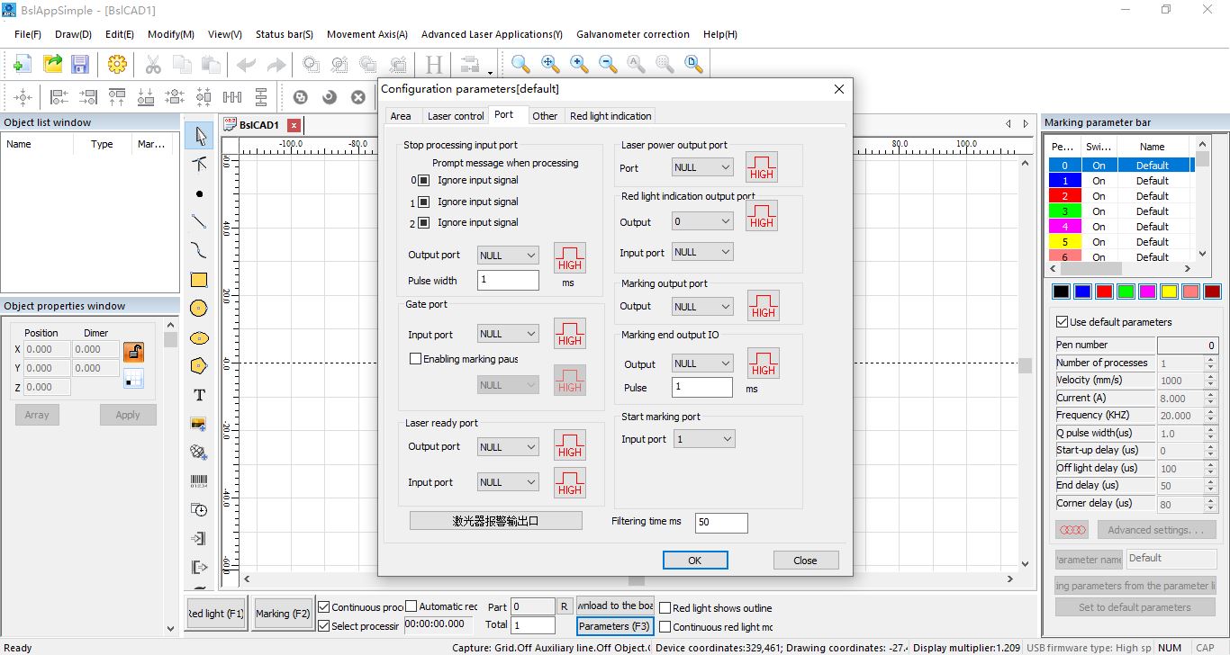

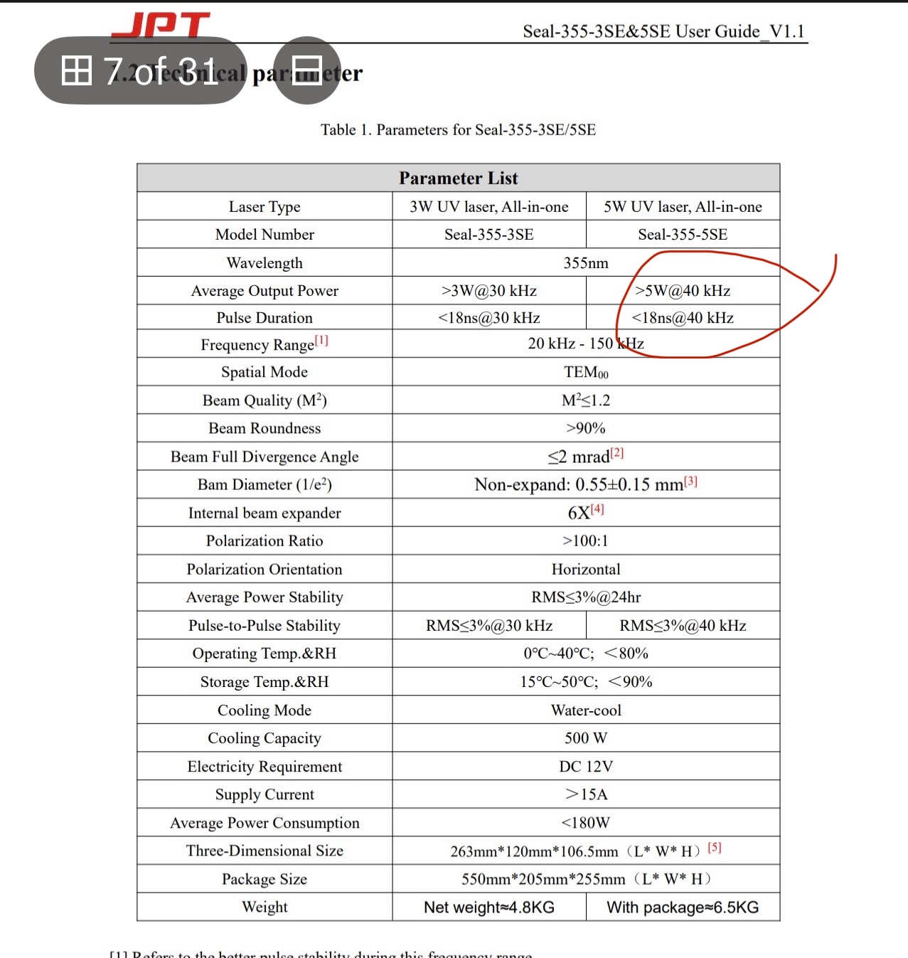

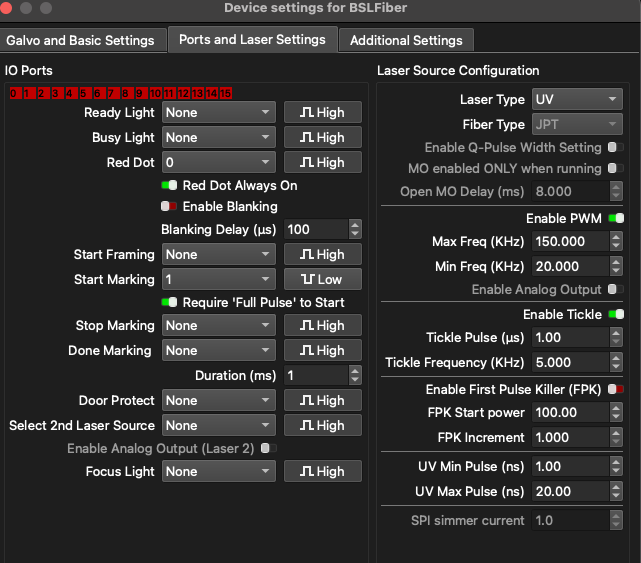

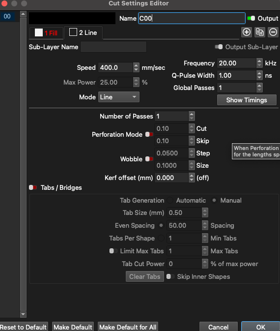

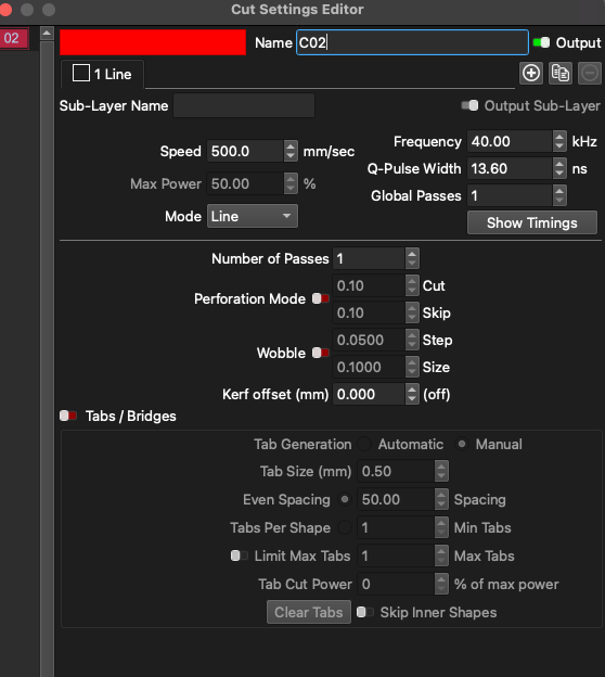

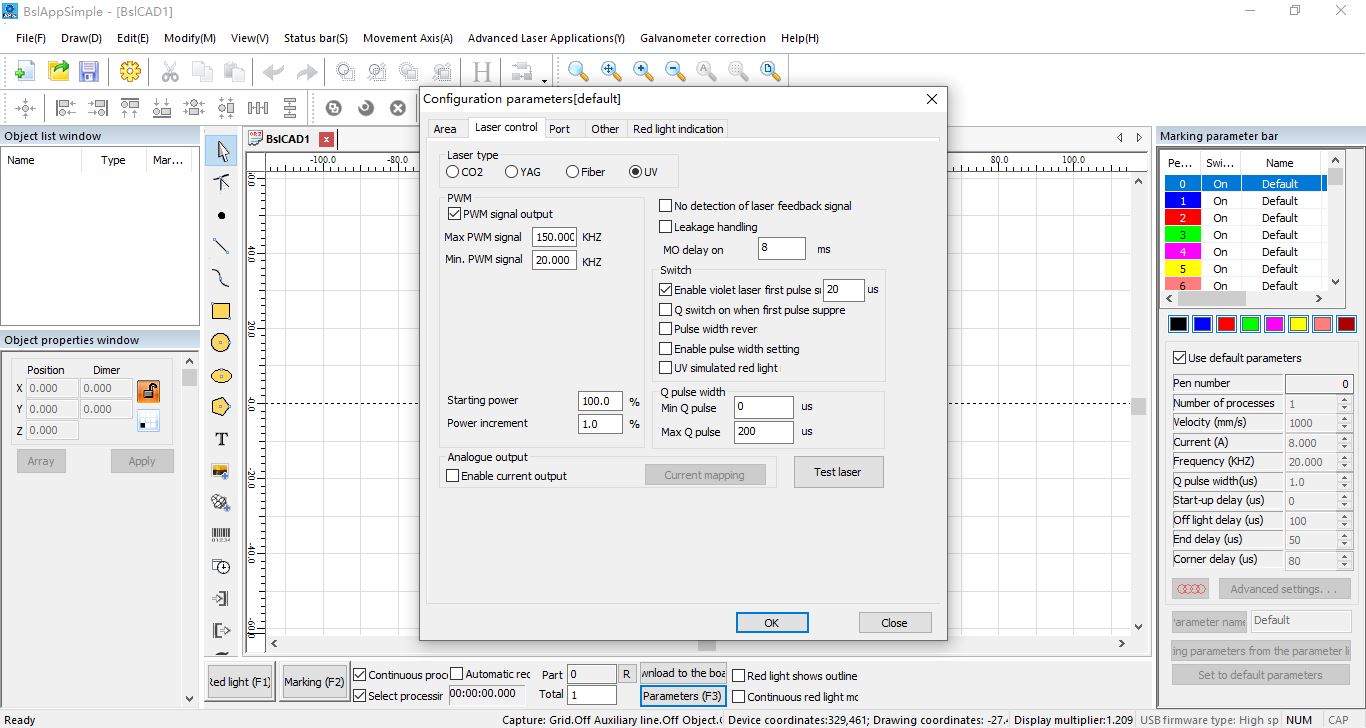

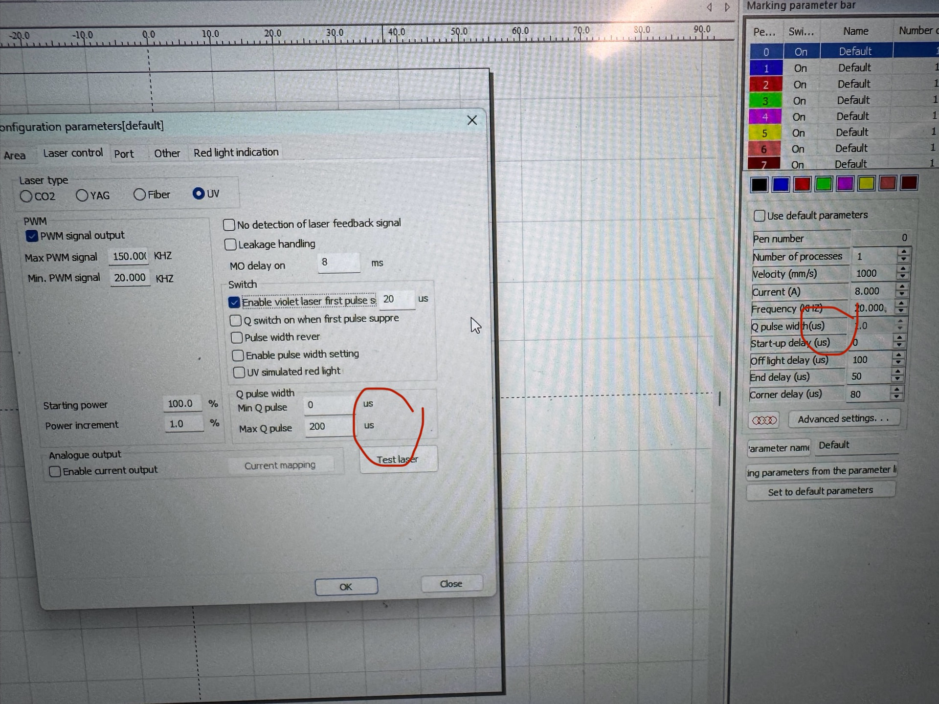

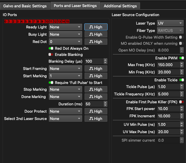

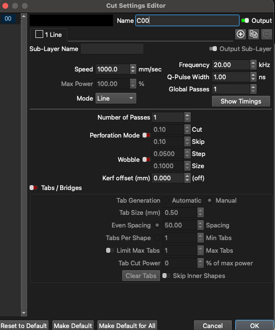

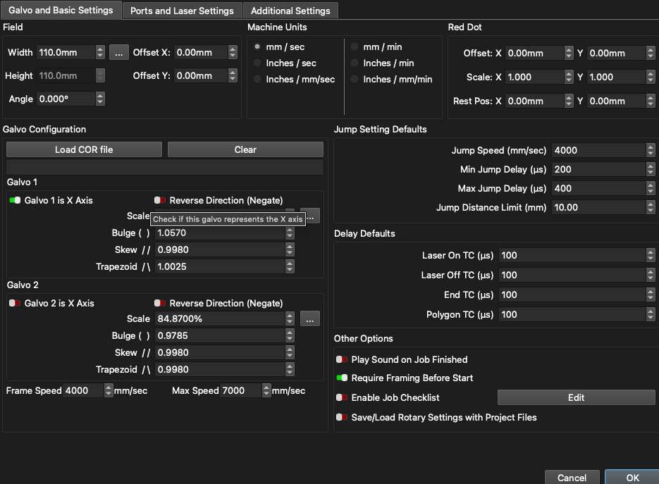

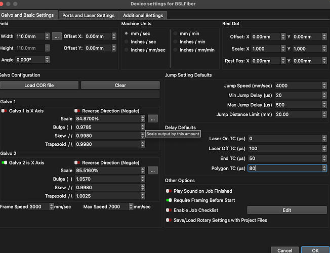

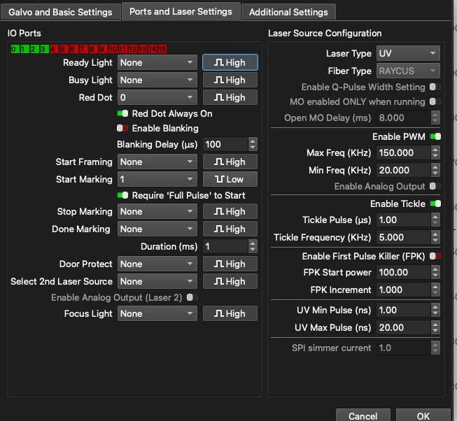

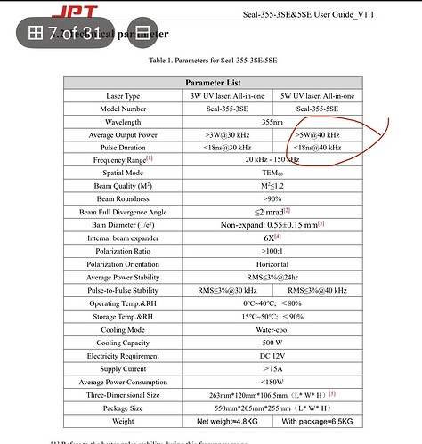

  2. I am not sure I have the ports and frequencies correctly configured. I have included the settings from their software and a screenshot of the LB settings that I made as an attempt to copy them. Is there anything that looks incorrect?
    Note: The light-mode screenshots are from their software, and the dark-mode screenshots are my LightBurn attempts to replicate it.

OK, I figured out that I actually have a BSL card. I can now connect, but it’s doing all sorts of weird things. I think I have the ports wrong. It’s trying to engrave immediately.

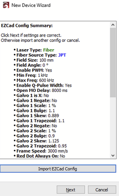

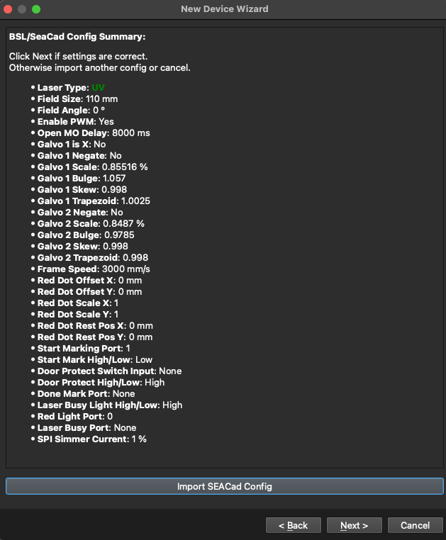

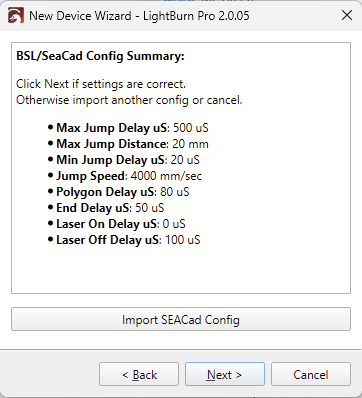

Let’s prove them otherwise! You’re not on your own :slight_smile:
The shared LmcPar.cfg only holds the Timing Settings for the laser.
We see this when importing it in LightBurn:
Do you have another config file named LmcPar.cfg?

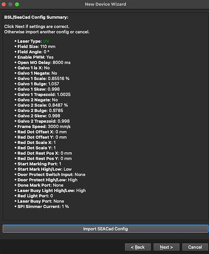

If it’s correct, we should see a summary closer to this one, where the correct laser source and other values get set:
Can you elaborate on those weird things?

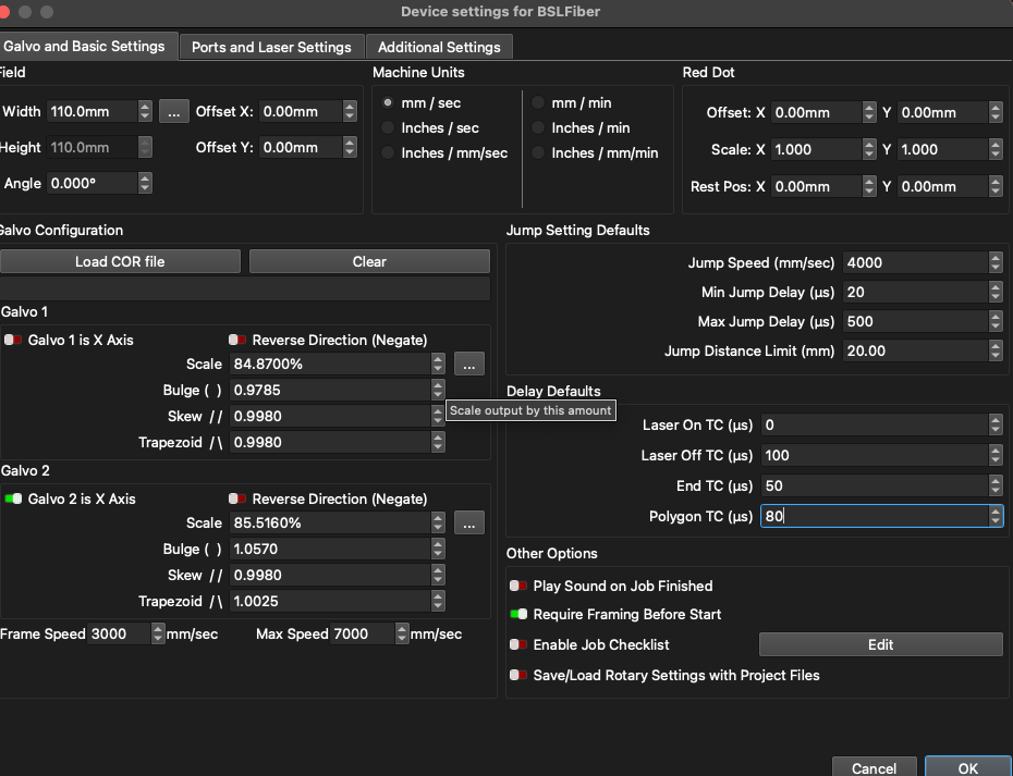

As far as I can tell from your BslApp screenshots, you’ve transfered the settings to LB correctly.
I would still like to compare it to a LmcPar.cfg, if you have one. (It’s possible that it only gets stored in the program folder after you ran it on the Windows machine)

I was able to import the LmcPar.cfg, and it did, indeed help! It is now framing correctly. However, it is still not engraving. It seems like it’s engraving, as I hear the galvo do something quickly, but it doesn’t make a mark. It’s very much possible that I have my engraving settings set to something dumb, as I’m very new to UV Lasers. I’ve attached the results of my import, the configuration that it created, and my layer’s settings. Does it look correct?
thanks again for your help with this!
-Thomas
That’s great to hear. Yes, this summary on the import looks better.
You can manually enter the Timing settings from this screenshot in your Device Settings.

@Aaron.F thanks again for your help.
It looks like the timings are already properly set. I think the settings on my cut are the same as those on SeaCAD (but I’ve tried others too!), and my focus is the same too. I’m using one of those black metal business cards, and SeaCAD engraves properly. Lightburn frames properly, and when I hit the start button, it does look like it’s doing something, but doesn’t engrave. When I hold up some paper while it’s on engrave continuously mode, it draws the shape it’s supposed to, but it doesn’t get engraved. Seems like maybe it needs more power?
I’ve tried the manufacturer’s optimal qpulse and frequency combinations, as well as the ones from SeaCAD, and still nothing. :frowning:
Man, still fighting this issue. It’s so close, but still not engraving in Lightburn.
  • when I engrave in SeaCAD, it engraves properly
  • When I use what I think are the same settings as SeaCAD but in Lightburn, it frames properly, but doesn’t engrave.
  • I keep the focal distance and material the same between the experiments with the two softwares.
  • in Lightburn, when I hit the engrave button and hold up a piece of paper, I see the shape being drawn that I expect, but it doesn’t make any marks.
  • I’m guessing there’s something wrong with how it’s setting the power, and that it’s not high enough. (The settings I’m using for my layer are above)
Is there anything in my power settings that look wrong?
-Thomas

One strange thing is that in SeaCAD, the qpulse widths are in units of microseconds (us) but in Lightburn, qpulse is measured in nanoseconds (ns). I assumed this was just a bad translation from the software, but tested to see if 1000ns actually worked. It did not appear to. The manufacturer (JPT) seems to indicate that it should be less than 20ns, but I admit I’m a bit out of my depth here and not sure I’m interpreting the documentation correctly.
No, that looks correct. Many UV galvos frame only with the main laser, rather than a red assist pointer.
I took this screenshot of your SeaCad settings in the video:
I find it strange that “Current (A)” is listed here. I am not aware of any equivalent setting in LightBurn.
The Q pulse is greyed out and entered in microseconds, as you’ve pointed out. This might instead be referring what we call the “Tickle Pulse” instead.
There are quite a few “Laser Souce Configuration” options in the Device Settings that need to be set correctly, but I can’t tell you what every value controls.
Here’s an example for one of our machines using another 5W UV JPT Lark-355-5A:
Please post a screenshot of this section in the Ports and Laser Settings for comparison.

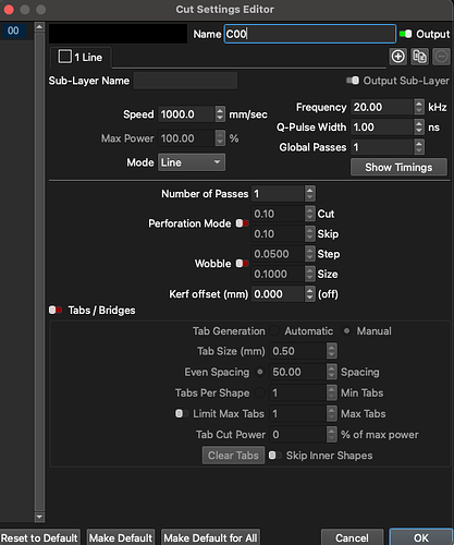

The cut settings you’ve posted earlier should definitely leave a mark on paper if the focus is correct.
Can you confirm that you’ve used the same settings in your latest tests?
Delete the inactive “fill” sublayer here, just to rule this out, but that shouldn’t be an issue.

Here are the settings I’ve got. I noticed that mine says “UV” instead of “UV/YAG” like yours, and yours doesn’t have the “Enable Analog Output” switch like mine does (though mine is greyed out).
I’ve also included a screenshot of two cut layer settings that I’ve tried (neither of which work). I’ve tried a ton of others, sadly with no success.

I read in the docs for the JPT device that there was a “demo mode”. Is it possible that it’s in demo mode? Is this something you’ve seen before?
Other than that, I can’t think of anything I haven’t already tried settings wise. Is there a lightburn config text file somewhere that I can look at?
Or. Could this be a genuine Lightburn bug?
-Thomas.
Can you share the LmcPar.cfg you imported, and the JPT docs mentioning this “demo mode”?
Other than that, I ran out of ideas.
Let’s ask @LightBurn
I don’t seem to be able to upload PDF or CFG files. I’ll send a link to the pdf for the JPT laser (seal-355-5se) and paste the test from my LmcPar.cfg. Also: I can’t find where I read about the Demo mode, so that’s likely a red herring.
JPT Docs:
