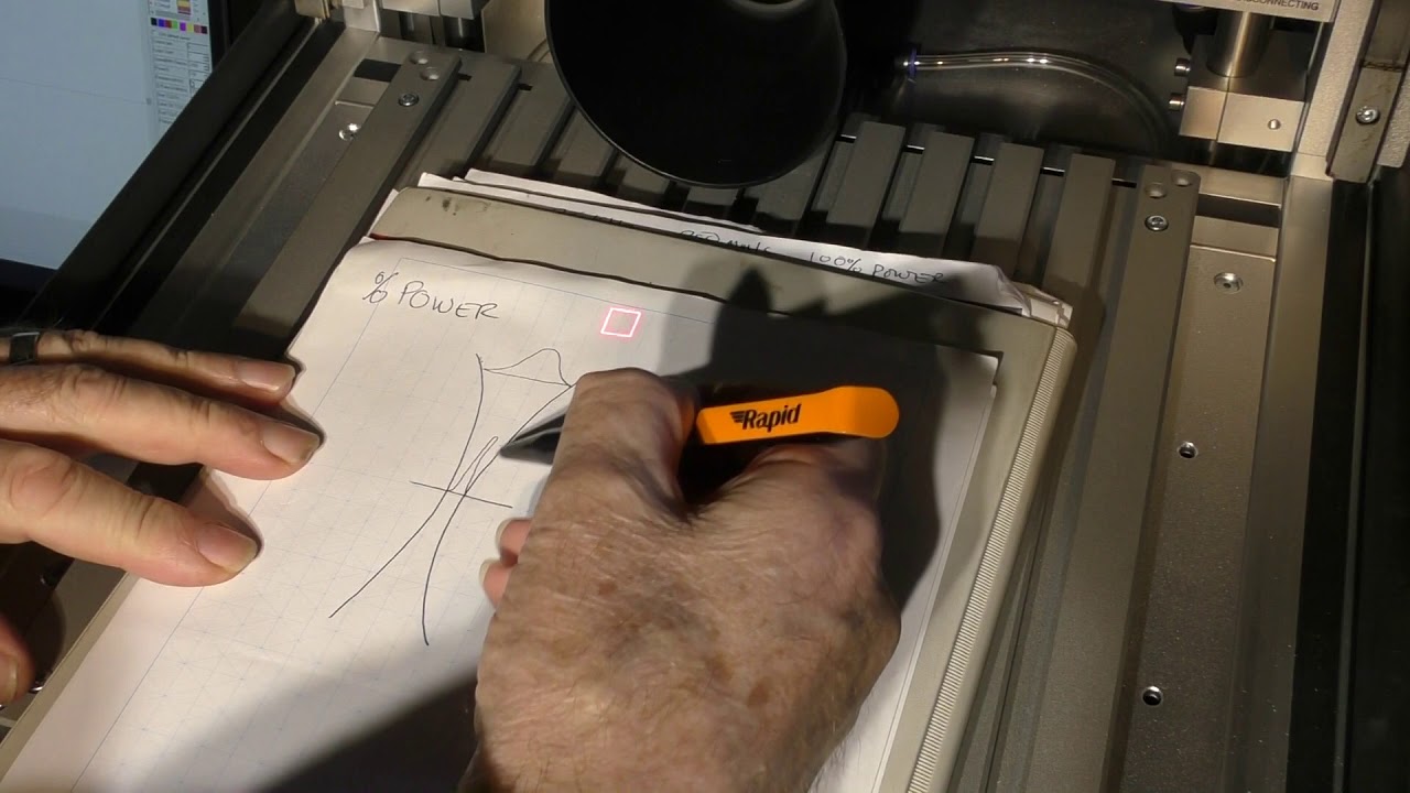

To get to your actual question, if you don’t have tens or even hundreds of material tests to get decent colors, your not doing it right. For a very comprehensive overview of color hunting, look at this video/playlist. tl;dr is that the thin film colors are very fickle, and hard to get consistently.
