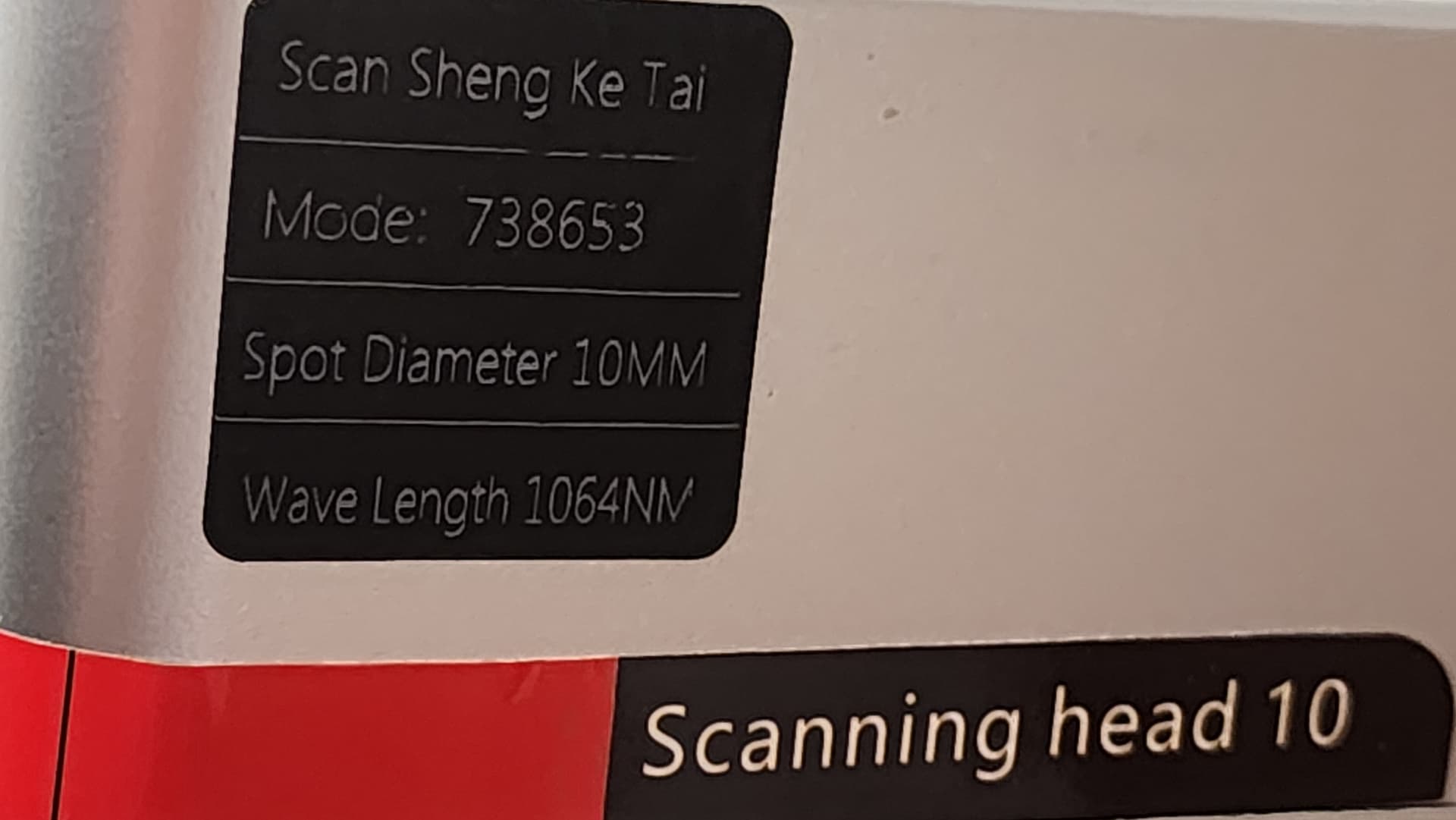

15 day warranty does not sound good. You can check the DB15 cable connection at either end. Sounds like the galvo head though. What is the brand/ model number of the head? They do fail from time to time, new or old.
This is it…

Sorry, I’m probably not going to be much help. So that said, this is what I think:
Can’t find that galvo with that brand and numbers. not a confidence builder.
Assuming a misspelling, Mode: is really Model. (L is right next to : on my keyboard) Not a confidence builder.
15 day warranty, not a confidence builder.

I think the scan head also is faulty as I took it off, had a look inside (to many bits for me to know what is going on). and put it back on…It worksed for about 5 minutes all ok, then messed up again.
I think you can put an SG7110 in there instead of that RC7110.
It looks like SG7110 is a bit faster. More sellers of SG on AliExpress suggests it’s the more common one
It looks like the SG7110 is only about $300 from AliExpress so it would probably make the most sense to just get a new one.
