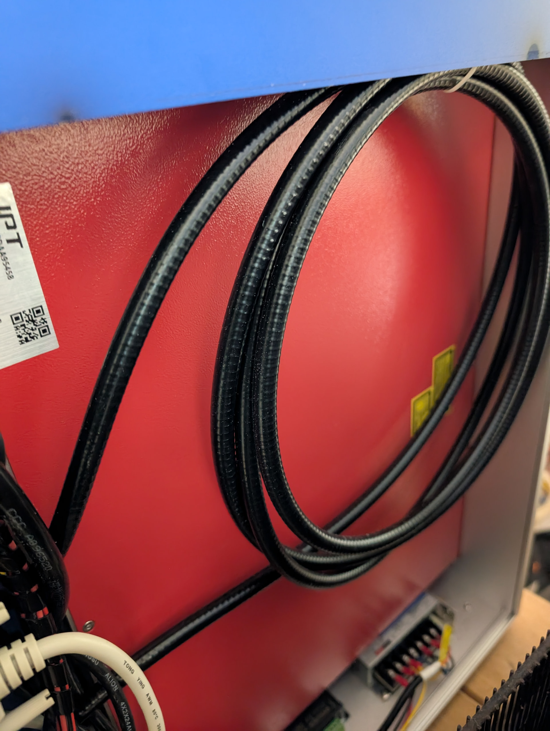

It only had few feet of cable from the MOPA source to the galvo. But I took off the side and found she was hiding a secret
Yep, that’s about another 10 ft of fiber cable AND an equal distance of coiled slack in the copper galvo signal cable is also there.
