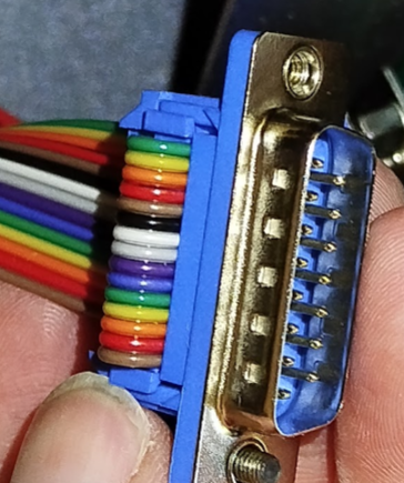

Yes I plan to get a DB15 breakout board. You can get them with one or both male and female DB15 connectors. I plan to mount a two connector version and a relay onto a piece of plywood using brass standoffs and then stick the whole lot inside a suitable resealable plastic box,
And to help avoid the joys of stray strands of copper I will be using my crimping tool to add a connector to the end of each wire. I need to validate the purchase of the crimping tool and wire stripping tool.
And to ensure the cables are not accidently pulled out, I will use heatsrink on the wires that poke out through a vent hole of the laser source/control boards enclosure and then use a cable gland. Course once warrenty expires I will install keyed sockets.

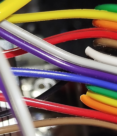

The laser has two buttons on the head which turn the frame lasers on and off and the second button marks the project. the second button and foot pedal are both wired to pins 8 and 11. I will have to see what the first button is wired to. It isnt going to be of any use once i install the enclosure after all.

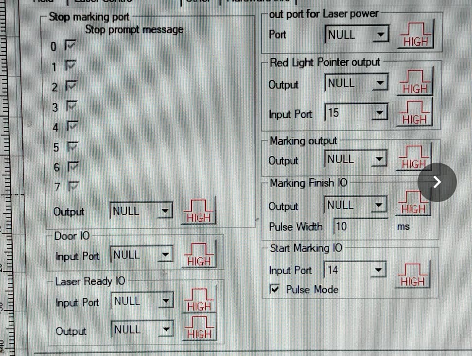

Well i did some more checking and the buttons on the lasers head dont do anything until ezcad2 is started. Have to say i am a bit surprised as the position numbers do not correspond to the pin out of con4 at all. I moved the Red ouitline button setting to door enclosure and the laser refused to fire unless the button was held down.

My one is supposed to double as a hand held fiber laser so it has a button to turn on the red laser framing and another to mark the project. They are just momentary switches. Course you would have to be crazy to use it as you need to lug around a super heavy laser source, computer and the fiber from the source is too short. Also good luck holding the heavy laser head still for more than a few seconds. truly a pointless gimmick. I only got it as it seemed well made at a good price.
But yeah you can assign the function under IO ports in the basic settings tab in Lightburn, maybe you could reassign the button on your lasers head to something more useful to you.

looking at what pins I had the rotary going to making no sense, I double checked and noticed I had the pic of the ribbon cable upside down compared to the socket pin out drawing.
