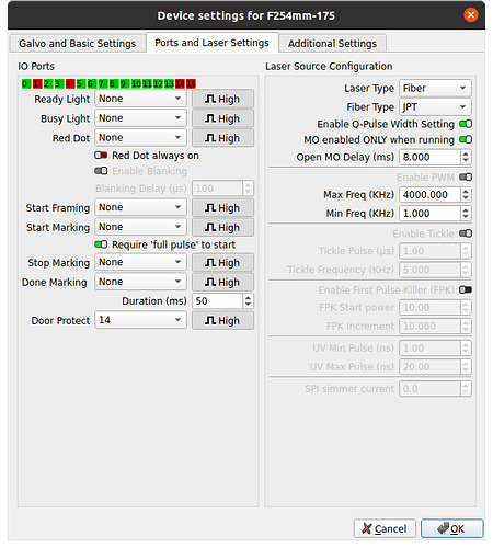

I changed my MOPA foot switch start marking to door protect in the device settings.
When running a job and I step on the switch, it will pause the work. I can click resume in Lightburn to continue. Probably what you want… you’d have to deal with how the operator would know this is what’s stopping it from lasing.

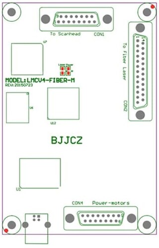

So, I just installed a door interlock and alert lighting on my fiber laser… I couldn’t find any documentation (and “support” didn’t grok the question at all), but I found a “Safety Enclosure” for my brand on eBay that had a wiring harness for contextual lighting, a door interlock, and a basic fan. I figured I may as well buy it for the parts and knowledge. (I stripped the parts from the enclosure and used them on mine – definitely wasn’t going to use the orange plastic pieces with no certification markings instead of my full enclosure with dark green certified 12"-ish window that cost as much as their entire enclosure.)
On my controller, apparently a “BJJCZ FBLI-B-LV4” (IIRC), there is a DB15 connector labeled something like “CON4 Power-motors”. I see the same connector and pinout on other ezcad2 boards for which I could find manuals online, e.g. “LMCV4-FIBER-M”. That connector is the one that exposes the few useful pins that carry the few signals I had to work with.
  • Pin 1, XORG0, was connected to my existing foot switch.
  • Pin 9, GIN15, was where the new door interlock switch connected.
  • Pin 2, OUT4, was heading off into the cable bunch to the tower, and I didn’t bother with it, but it’s likely doing something, I guess?
  • Pin 10, OUT5, was wired to a signal-level relay that connected power to some LED lighting (switching which of the R, G, and B buses on the LED strip were lit).
  • Pin 8, REMARK, looks like it could potentially be useful for some people (run whatever’s cached again), but I didn’t bother with it.
So, I connected everything up, and then I just had to go into Device Settings and configure a few things on the Ports and Laser Settings, page. Specifically, for me:
  • Busy Light: 5 (High)
  • Start Marking: 14 (High)
  • Door Protect: 15 (High)
The door interlock prevents you from starting the job, and if a job is running, it immediately pauses. (It’s a door interlock, which is what I wanted, not an e-stop, which the machine already had.) Also, it does not have any effect on framing. What’s even more useful to me is the LED lighting. When the machine is on, I have it wired to be a nice green (both inside my enclosure and also outside lighting the handle), and when the laser is active, I have it set to be a nice bright magenta.

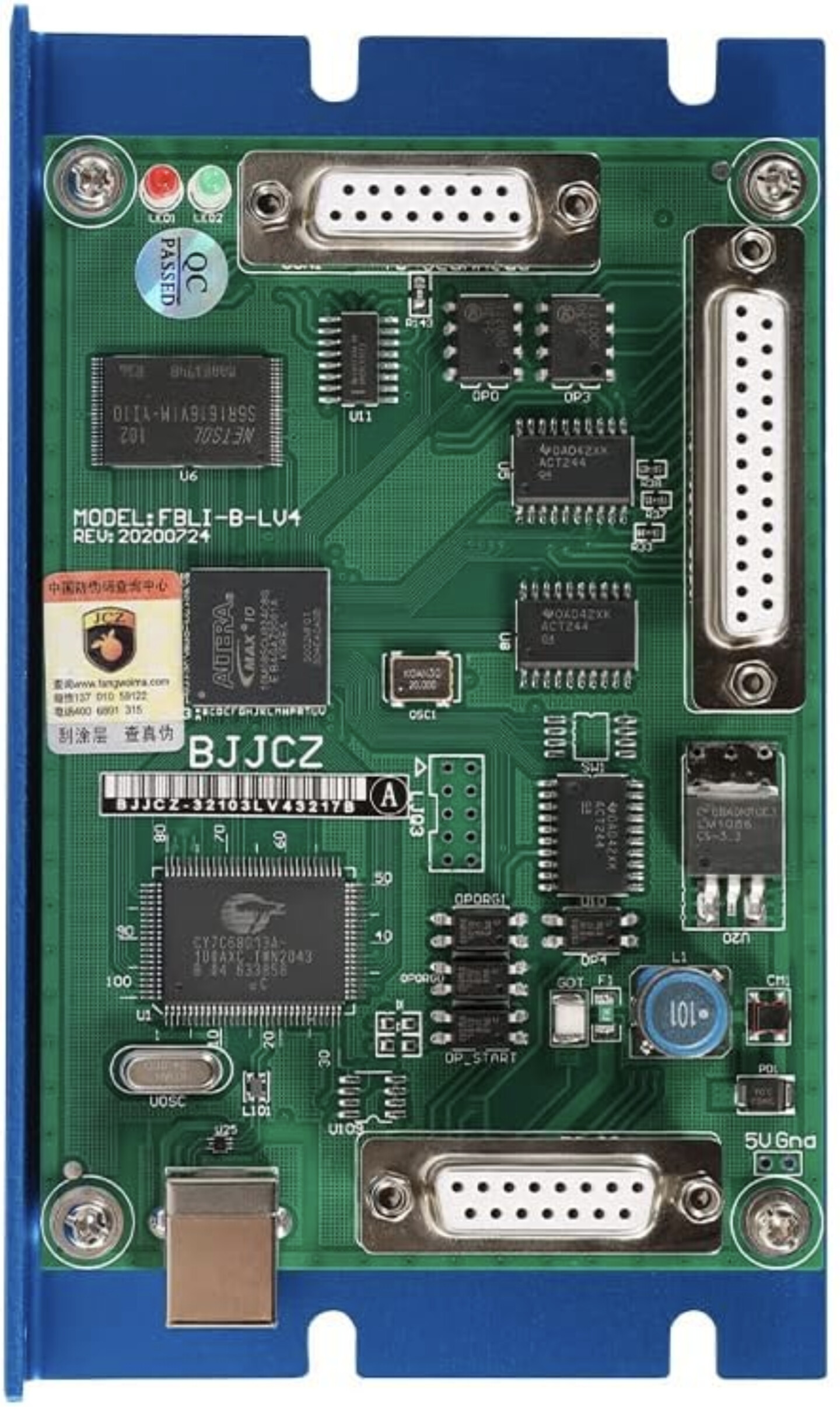

Thanks… do you have a photo of your board identifying the proper connector? Most of the ones I have lack a connector or two…
Thanks for the input…
I pulled these off the net, but they’ll do. My controller is identical to the photo (except without the Cloudray blue tray and sticker), and the diagram shows the labels that are obscured by the connectors on the board.
The DB15 to note is the one next to the USB cable, i.e. the one opposite the scanhead connector and its two status LEDs.

So, getting down to the useful info… The DB15 connector in the machine was a standard screw-together clamshell connector with only certain pins connected to a wiring squid (different ones going in all different directions). In my case, there were already wires soldered to pins 9 and 10 (GIN15 and OUT5, respectively), and there was already a connector on the back of the machine to feed them out, but that was just delightful convenience.
For GIN15, i.e. pin 9 on the DB15, you can just connect a switch between it and any of the several grounds on the connector. (To use a powered non-contact switch, you’ll also need to tap Vin or another source, of course, but you could also use a simple magnetic door switch.) GIN15 is internally pulled high, with the normally open switch shorting it to ground.
For OUT5, i.e. pin 10 on the DB15, my system had the coil side of a 5V signal-level relay (specifically, a HSINDA 941H-2C-5D – Amazon link) connected between OUT5 and GND. The switched contacts on that signal relay were used to switch the LED lighting. (You would not want to try to drive the lighting directly from a signal pin, of course.)
The LED strip I salvaged from the enclosure (using significant amounts of brute force – that thing is never ever getting back together) was the kind with separate red, green, blue, and ground/common bus bars, so it was just a matter of connecting power to the color channels I wanted lit. It would be just as easy to use the signal relay outputs to feed a stack light, but I had the LED strip, so I used that.
So, to summarize: Input pins float high and use a normally-open switch to short to ground. Output pins can use a signal-level relay (or an Arduino, or a Raspberry Pi Pico (W) if you level shift them) to do whatever you want.

My laser comes with a FBLI-B-LV4A control board (if the online manual is accurate) and I was looking everywhere online on how to attach the interlock. I am thinking of adding a extension cable onto the DB15 cable and splice on to or redirect the appropriate wires.
