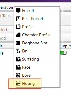

There is an operation, can’t remember the name, that cuts along a path but varies the enter and exit depth. You might try that one.

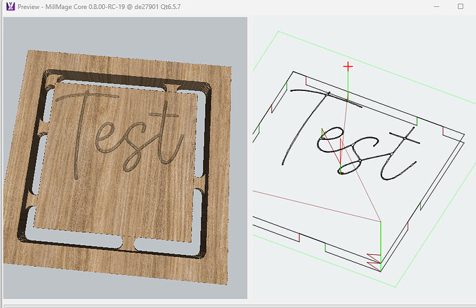

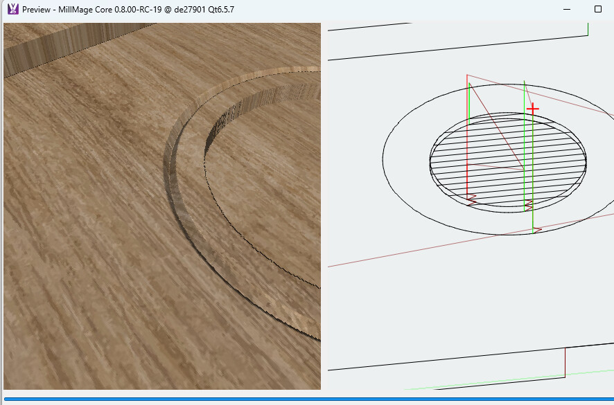

You can use V-bits to some extent - might be difficult to see here, but the outer circle is a profile with a 60-degree v-bit that only goes down 1 or 2 mm… so you can do some decorative work.
You can also experiment with single-line fonts to get something like this:

You can do a lot more too. @LightBurn showed a stunning image with some really fancy engraving just using the Fluting operation, but I suspect it was very labor intensive. The Flute is a ramp in - ramp out, so I am guessing there are a lot of line segments with individual Fluting operations. Just guessing here because he apparently missed my asking for the file. Or embarassed because I caught him showing off :heart_exclamation: :rofl:

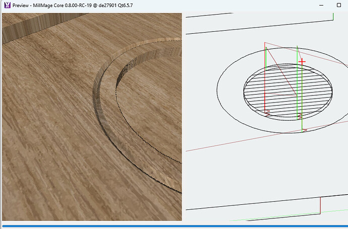

Just did some fooling around. Made a pocket cut, followed by a Flute operation. To cure the in-out ramp. I duplicated (not copy) the letter, and flipped it horizontally so the Start Point would be in a different location. Then that one got a new layer and another Flute operation added.
The end result was that the ramps were removed. Not bad for an old geezer, right? :rofl:

Duplicated (CTRL-D) the “A” outline and flipped it horizontally. Then I made it a second Flute operation.
To be honest, that “A” was NOT symetrical! I had to Node Edit to get it to lay on top of the first one. :grimacing:
I am not sure what you mean because all my settings are in mm. Flute has no line choices like inside or outside, so it just follows the outline on the line.
