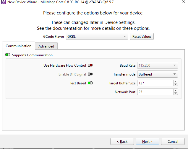

Also, ensure that you are using port 23 in the Device Settings.

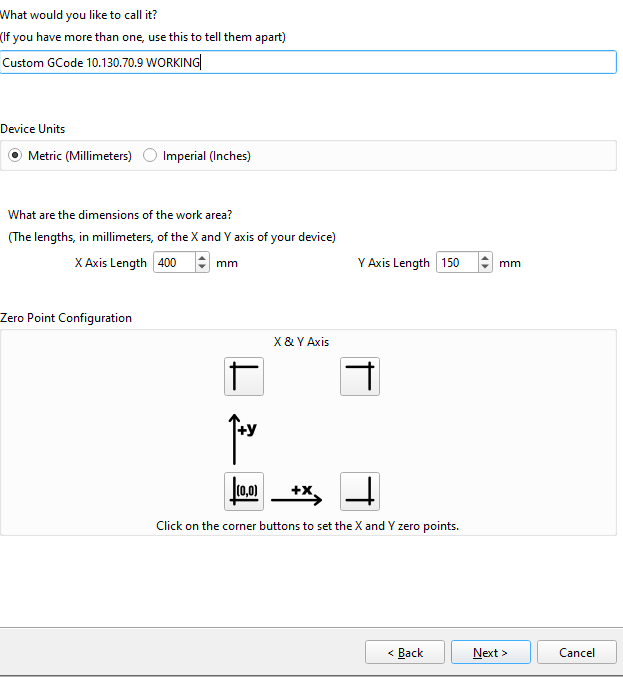

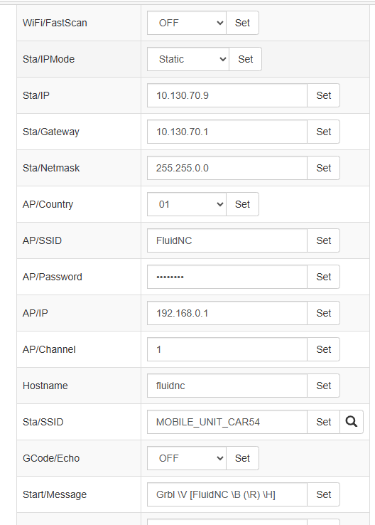

ok you can see the controller. so im going to post my setup steps 5 each.

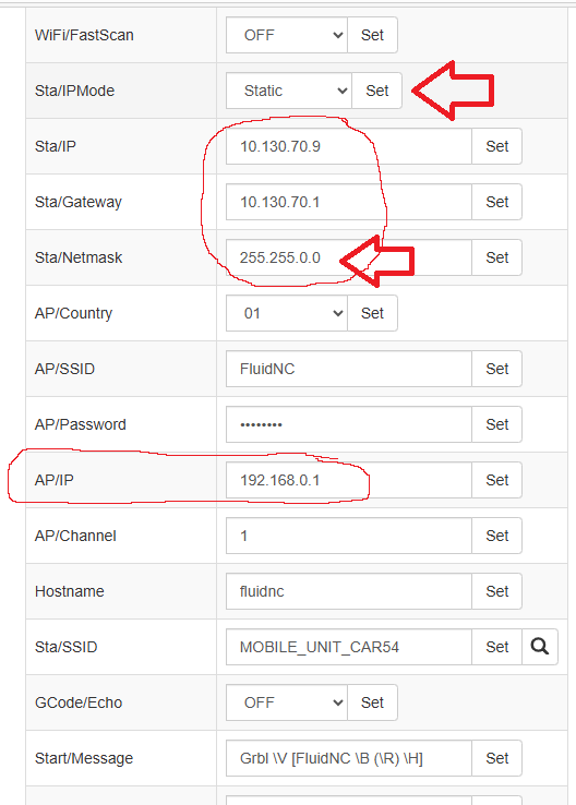

you need to change things like your local network and ip address and stuff like that on your end, mine will not work on your network. the first screen shot is the network setup in your fluidnc via your browser and the other screen shots are in MM comms setup. but it works good for me and no problems even on long runs 6hrs.

I know somehow have a connection to my FluidNC V1 Lowrider AND even still have a wifi internet connection. Seems much more stable.
ya the 255.255.255.0 is best, i use the static ip because i go thru a wireless router and dont want the router to assign a random IP to the fluidNc device…….. so my setup is fluidNc (10.130.70.9) connects to wireless router (10.130.70.1) and my laptop connects to the wireless router with a random 10.130.70.? ip, light burn and MM has a fluidNC connection now, located in the “Custom G code” device list
