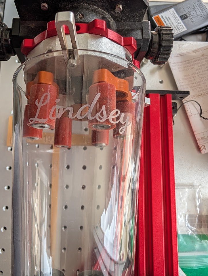

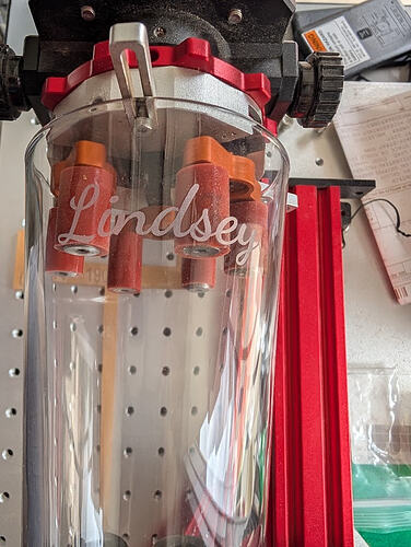

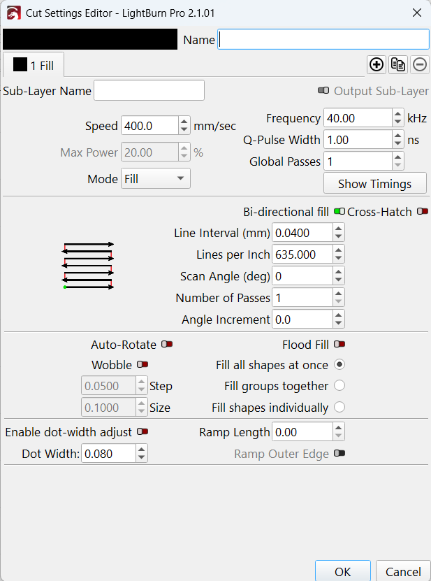

This is my setup for glass. I have a 5w UV from cloudray. The machine has a 5 minute or so warmup time before it’ll accomplish anything. The focal point is also critical for glass. Get it close with the alignment dots then slowly move it up or down until you get a sharp sound.
