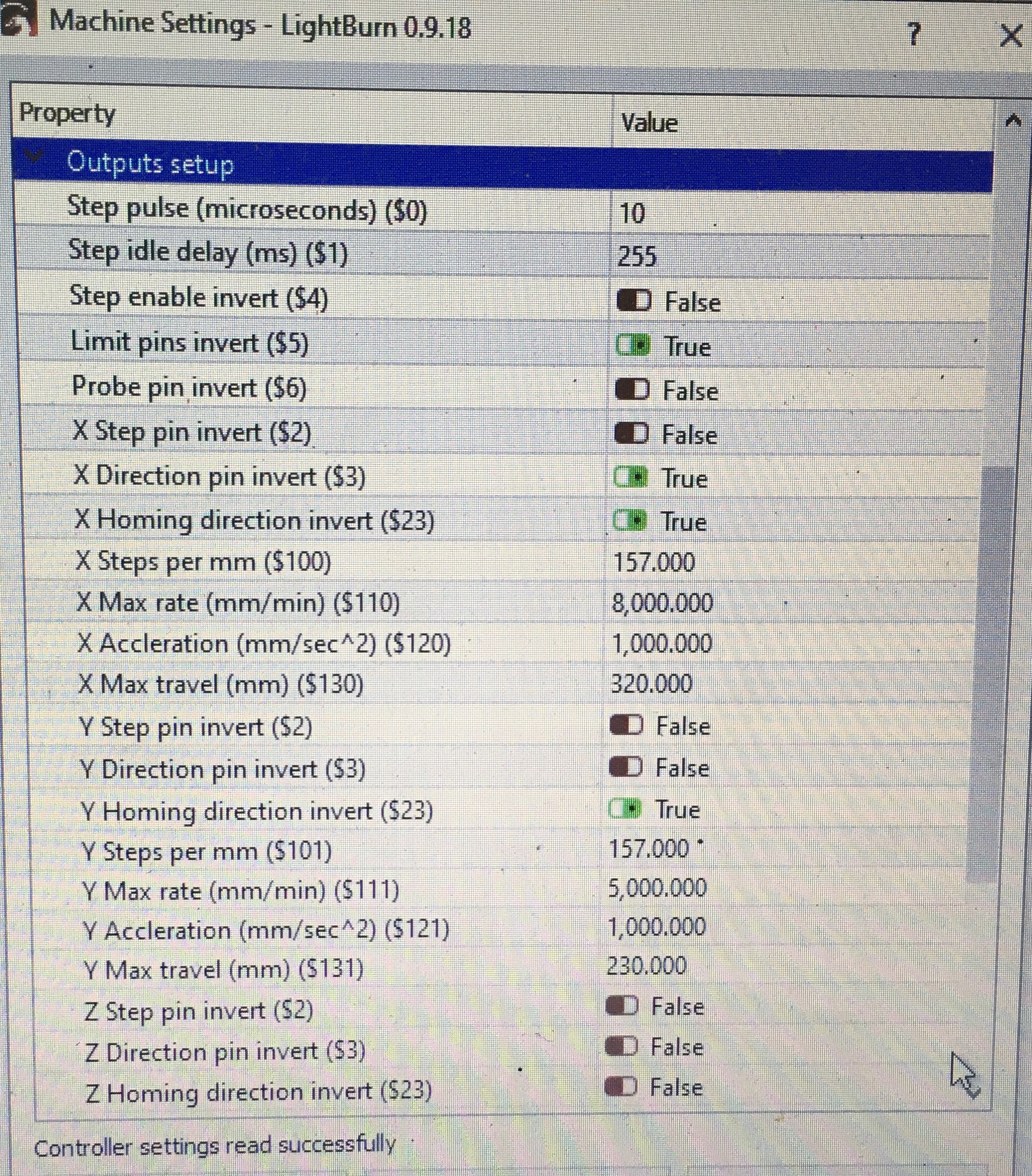

I now cannot get the y axis to move forwards yet it goes home fine. When you jog the head forwards on the y axis it just vibrates, if I “assist” by pushing lightly on the gantry then it moves forwards to a point.
It does return home fine though. I am at a complete loss.

If that’s happening, check the speed you’re asking it to jog. You might have the motor current value for the Y axis set too low, or the acceleration or speed set too high. If the motor just squeals, but works with a nudge, it’s skipping.
Oz, that sounds like what could be happening but I would not have a clue where to start to change it. It does only take a nudge to start it.
Jogging at 200mm/sec, works great on x axis but not on y.

Go to Edit > Machine Settings and look at the settings for Y acceleration and Y maximum speed (in the “vendor settings” section in the bottom - you’ll need to unroll it).
Settings are attached. I think I have already reduced max Y acceleration but please review all settings and let me know what will help.
Just to be on the safe side, I have a K40 with Mini-Gerbil, 1.1f.
The biggest difference is your or my machine orientation. My X ( 130) is 230 and Y ( 131) is 320.
Differences in a few other things are:
110 = 11000 111 = 6000
120 = 5000 121 = 3000
$ 123 = 3000
sorry formatting also missing some $ characters, it’s probably lost in Google Translation

How about homing? my homing is top-left and what about the swapped x and y?
Try lowering the Y Acceleration more.

Your two sides are out of whack - they will be one tooth out on the belt. That’s jamming your Y axis.
