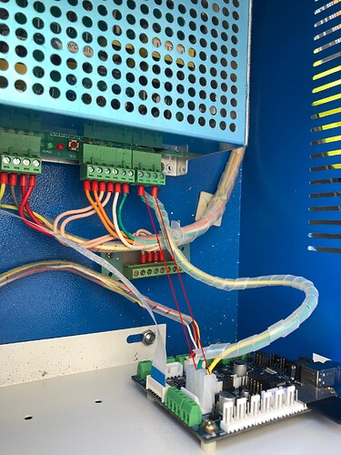

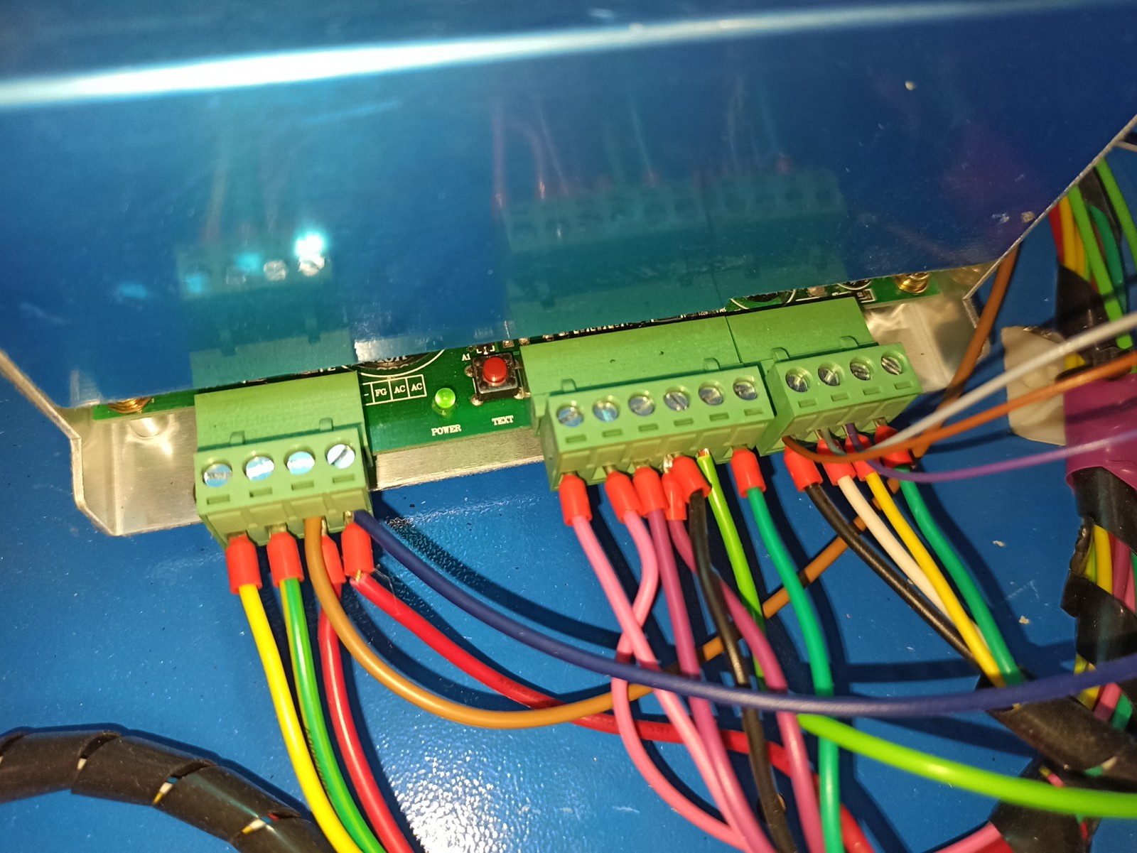

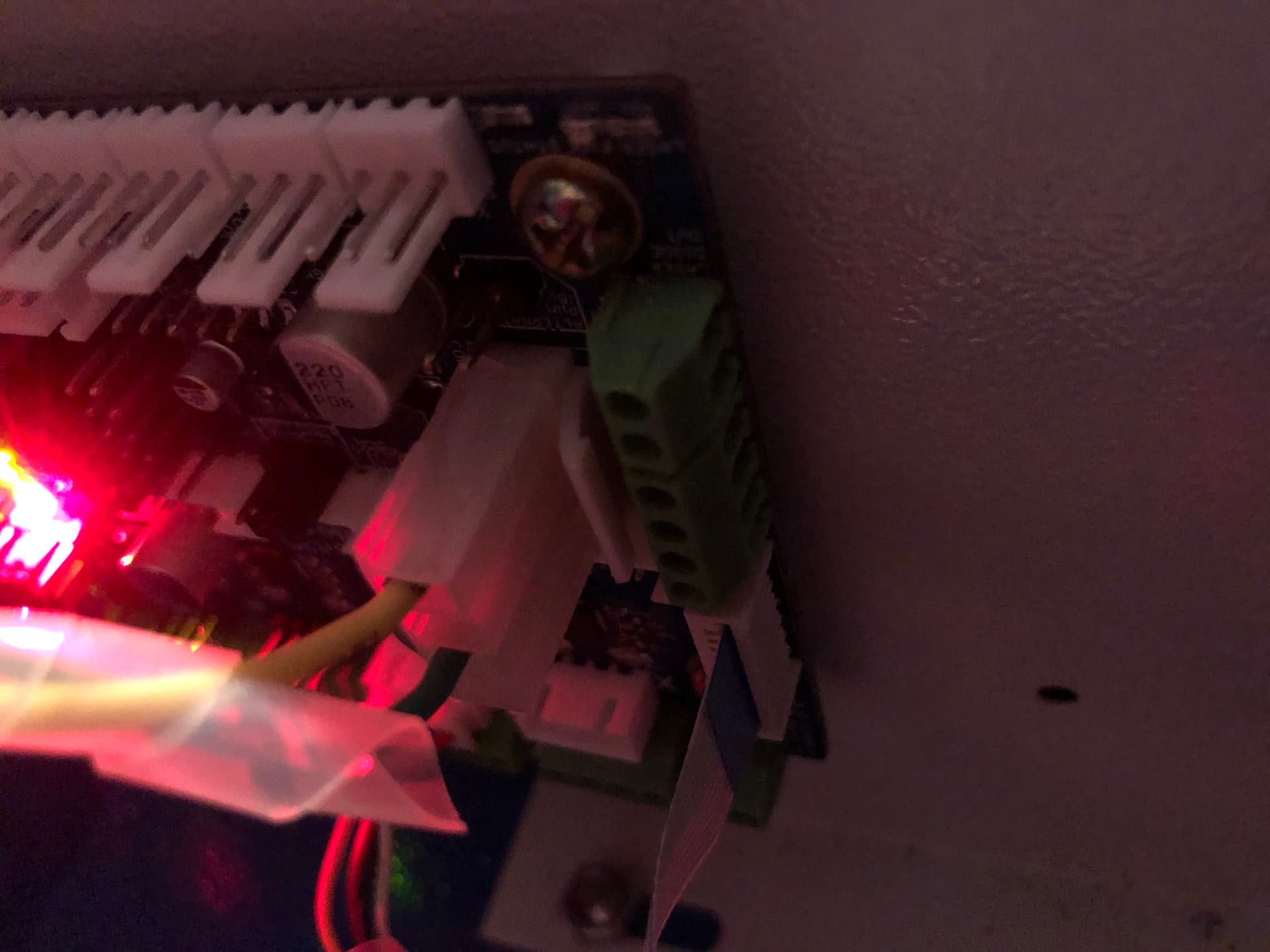

Hi All.
I purchased a K40 about a month ago. Was supposed to be new, with C3D controller installed, but never used. However, turns out it was used. They also installed the controller, but said they never used it since installing it. I now know why.
The laser fires when I push the test button, but does not fire through Lightburn. The head moves. I can home it, I can frame the project. I can run the project and it will trace the correct lines… just no actual laser. I have read all the posts I could find about this, but none have helped. My power is set all the way to 100%, and is set to 100% in LB. I have verified that it is not the water protect system too. I suspect it is something to do with the wiring. I suspect this for 2 reasons. #1, the potentiometer display does not show a reading. I know the potentiometer does work though, because I can adjust it, and the laser power does indeed increase/decrease as I do so. The second reason is that there is an extra connector that is attached at the bottom, and I cannot find any wiring diagrams showing the wiring.
While looking at everything, I did notice that all 4 wires were connected to the power plug connected to the C3D board, and that the 2 used one (ground and laser) were not connected directly to the LPS ground and laser pins. I removed the two unused and directly connected the 2 wire to corresponding the LPS pins. But alas… that did not solve the issue. I am not an electrician, so that is about as far as my tech skills go.

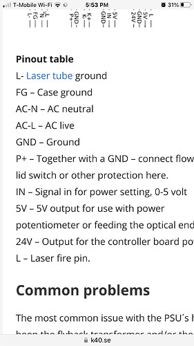

PS: I also show the post where someone said they had this issue and they switched from GRBL 1.1 to GRBL. If I select any of the GRBL drivers, LB does not move the head at all. I have to have smoothieware selected for it to move.
I was hoping someone here may be able to provide some help.
Thanks in advance
Pics of wiring attached

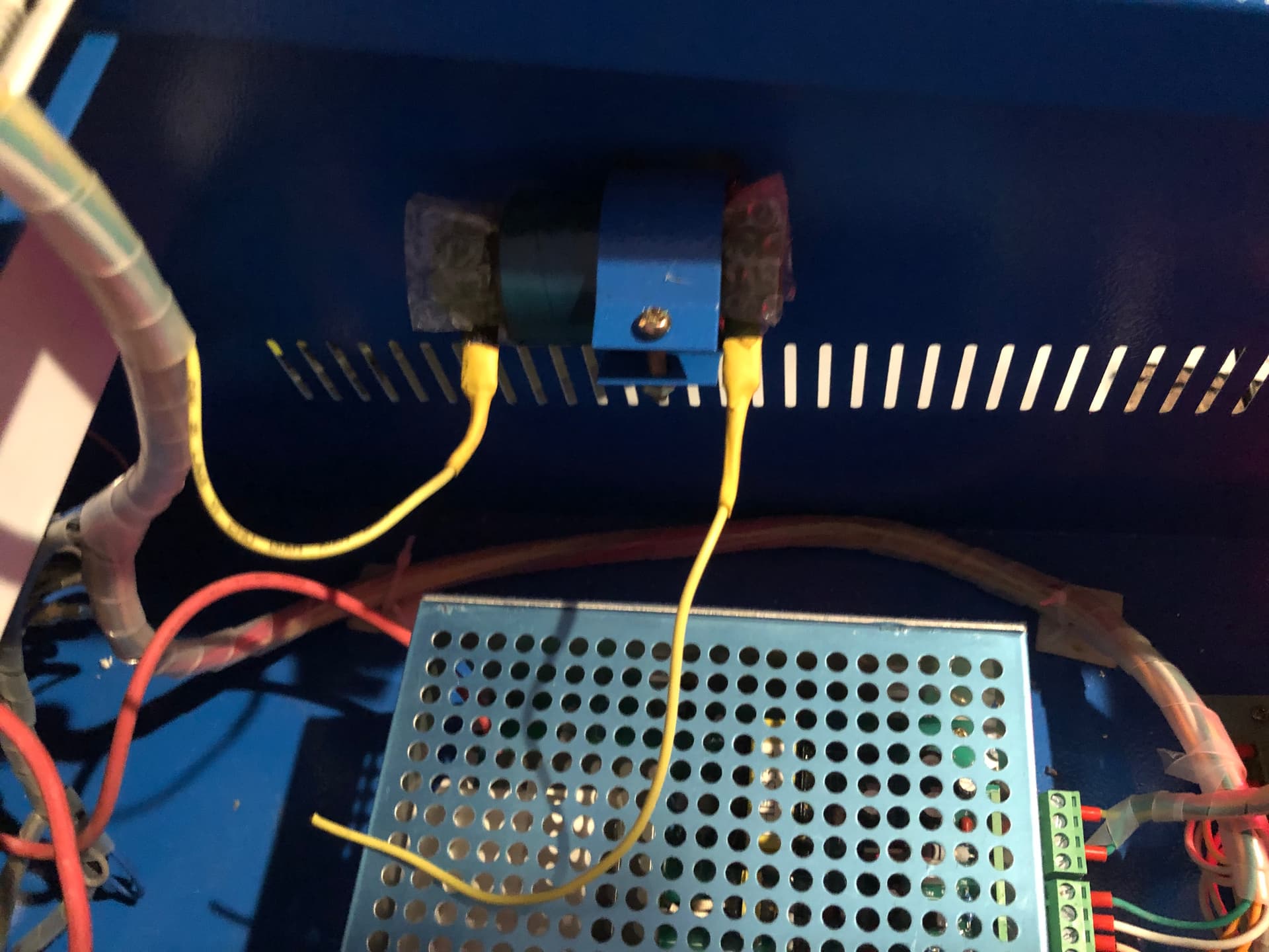

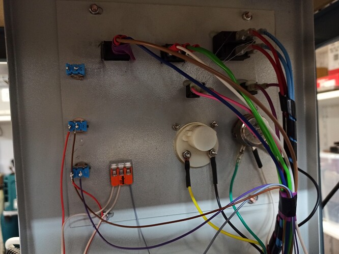

PS: Here are some more photos.

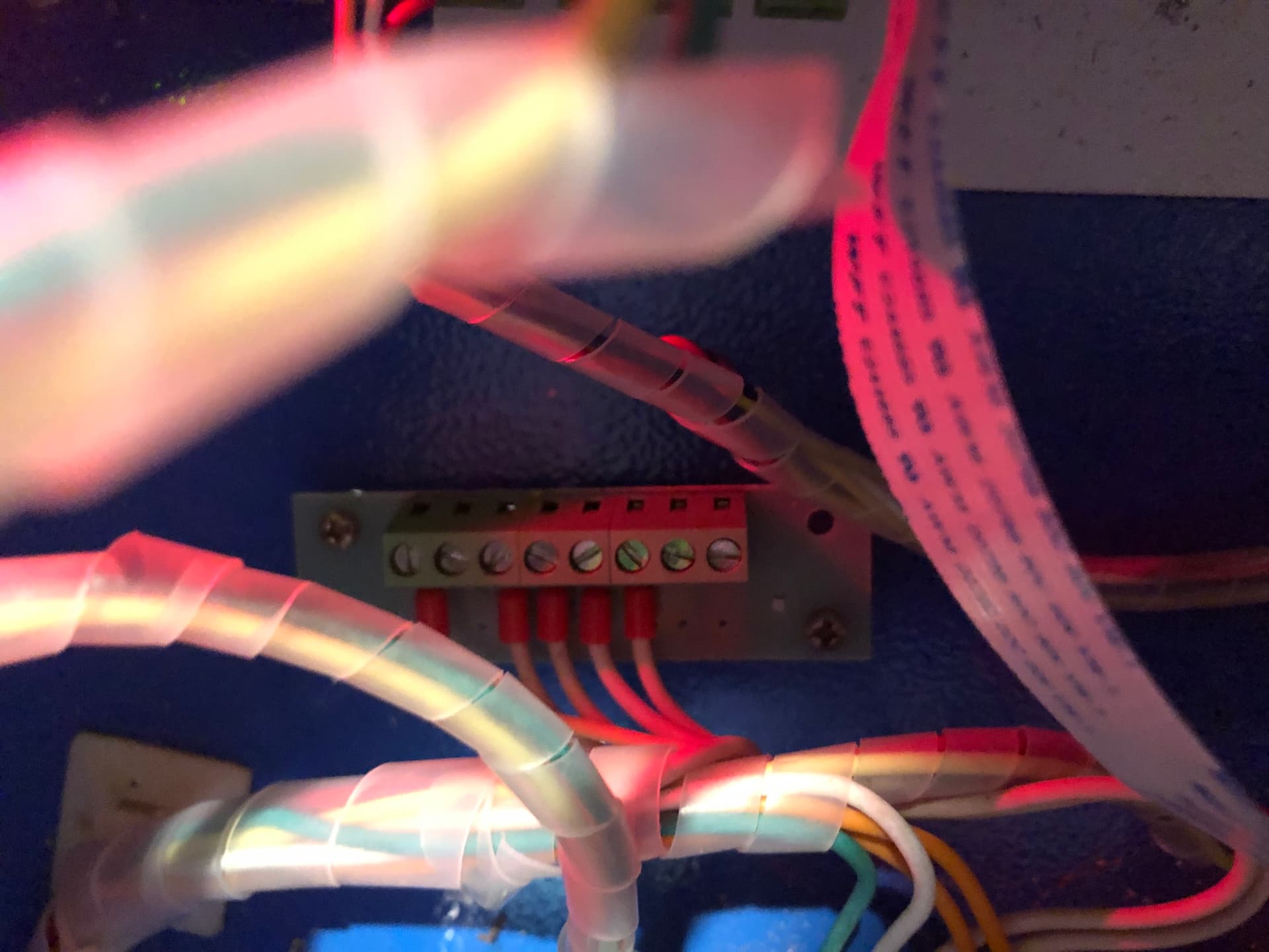

I was wondering if someone could tell me what the round cylinder with the hanging wire is too? I could not find anything in google about it. Is the dangling yellow wire maybe the cause?
I think you’re on to something Sherlock… :+1:
It’s a ballast resistor… this indicates a pretty old K40 type … you don’t see these anymore…
I’d venture to guess that the power supply has been replaced and that would likely eliminate the need for the ballast resistor.
About the hanging wire, from the information you’ve given us – all I can determine it’s a hanging wire… :zap:
Likely, as I stated above, it likely isn’t being used. Curious, were does the wire at the other end of the resister lead?

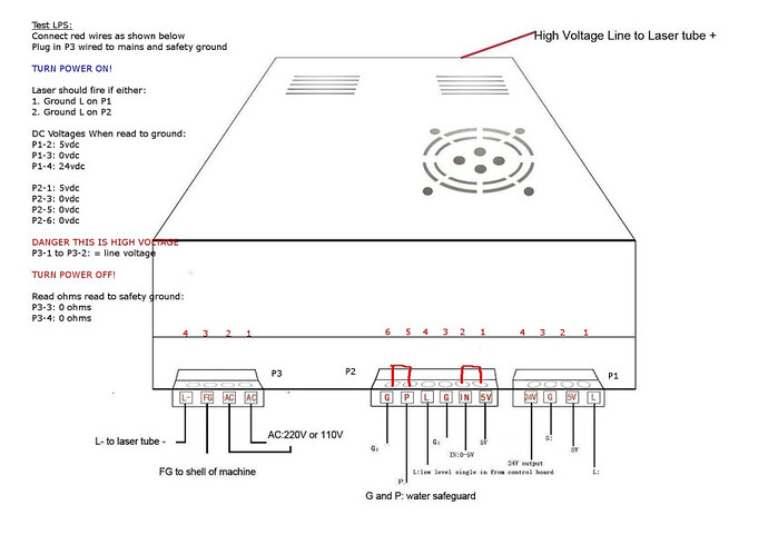

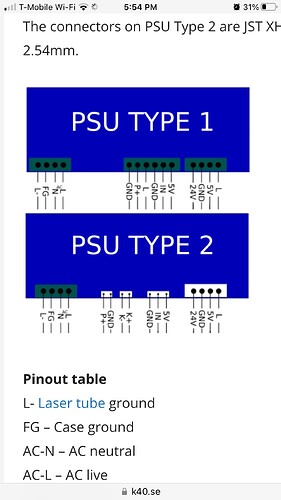

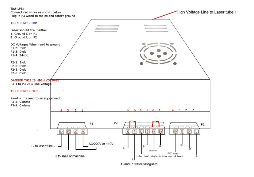

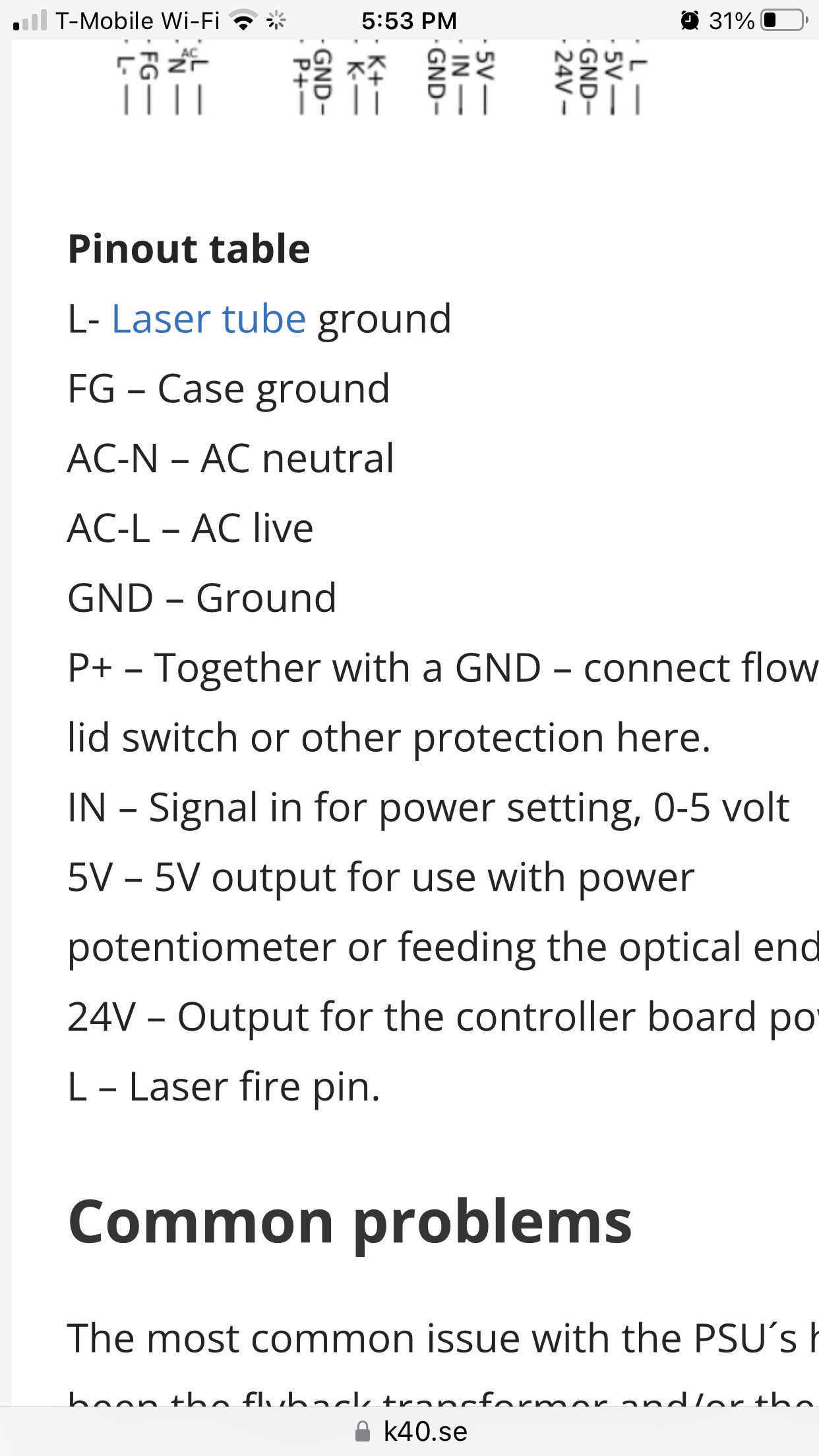

I think this is your supply pinout.
This may help, if you can find your way through it. Don put this together, second link down, it’s pretty comprehensive and covers a number of different power supplies.

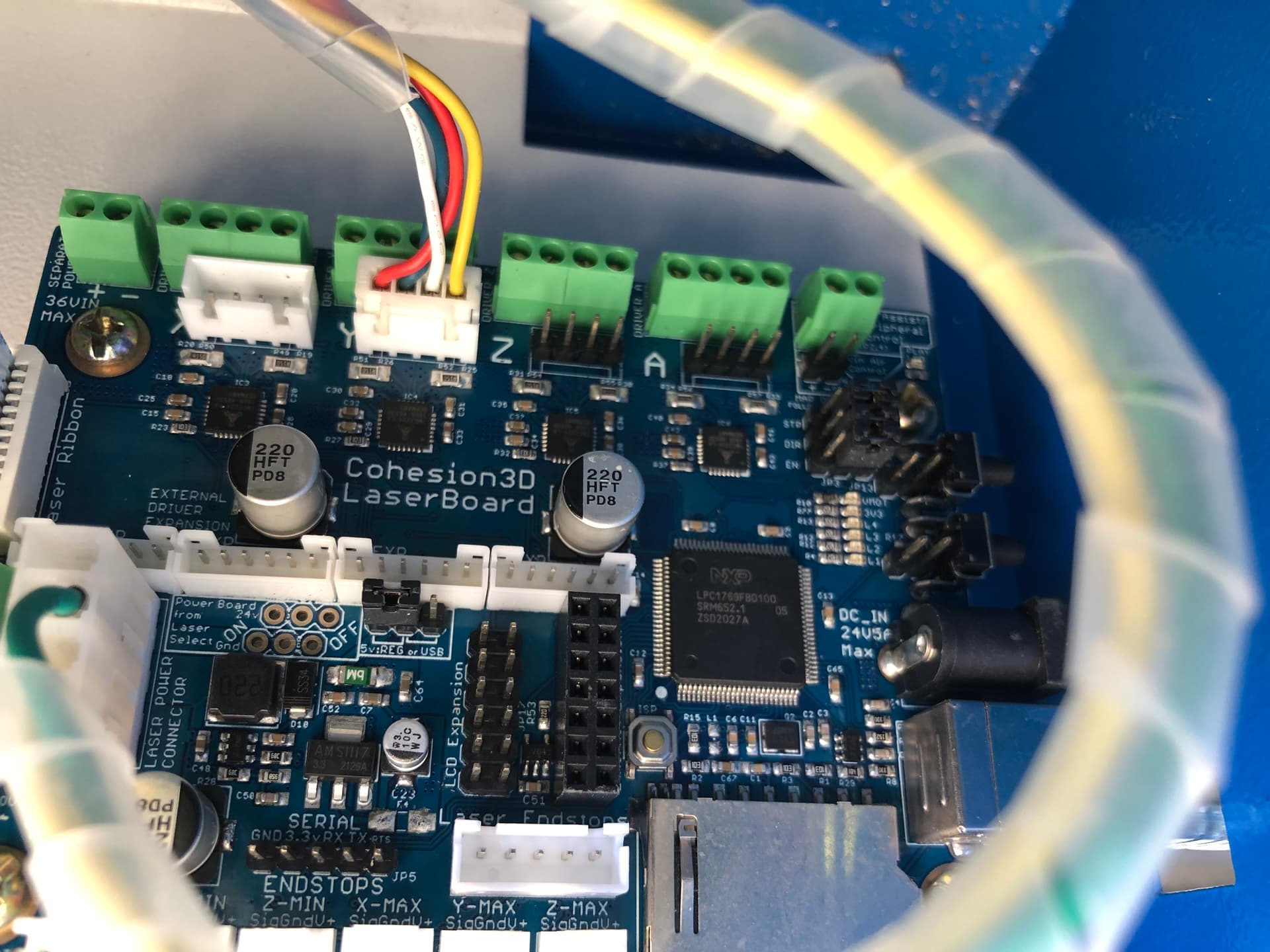

Is your controller the V2 version? A legible photo of it would be nice… a link to it and a photo is best.
We know you know, but but the rest of us have no idea what two wires do you refer…L & IN?

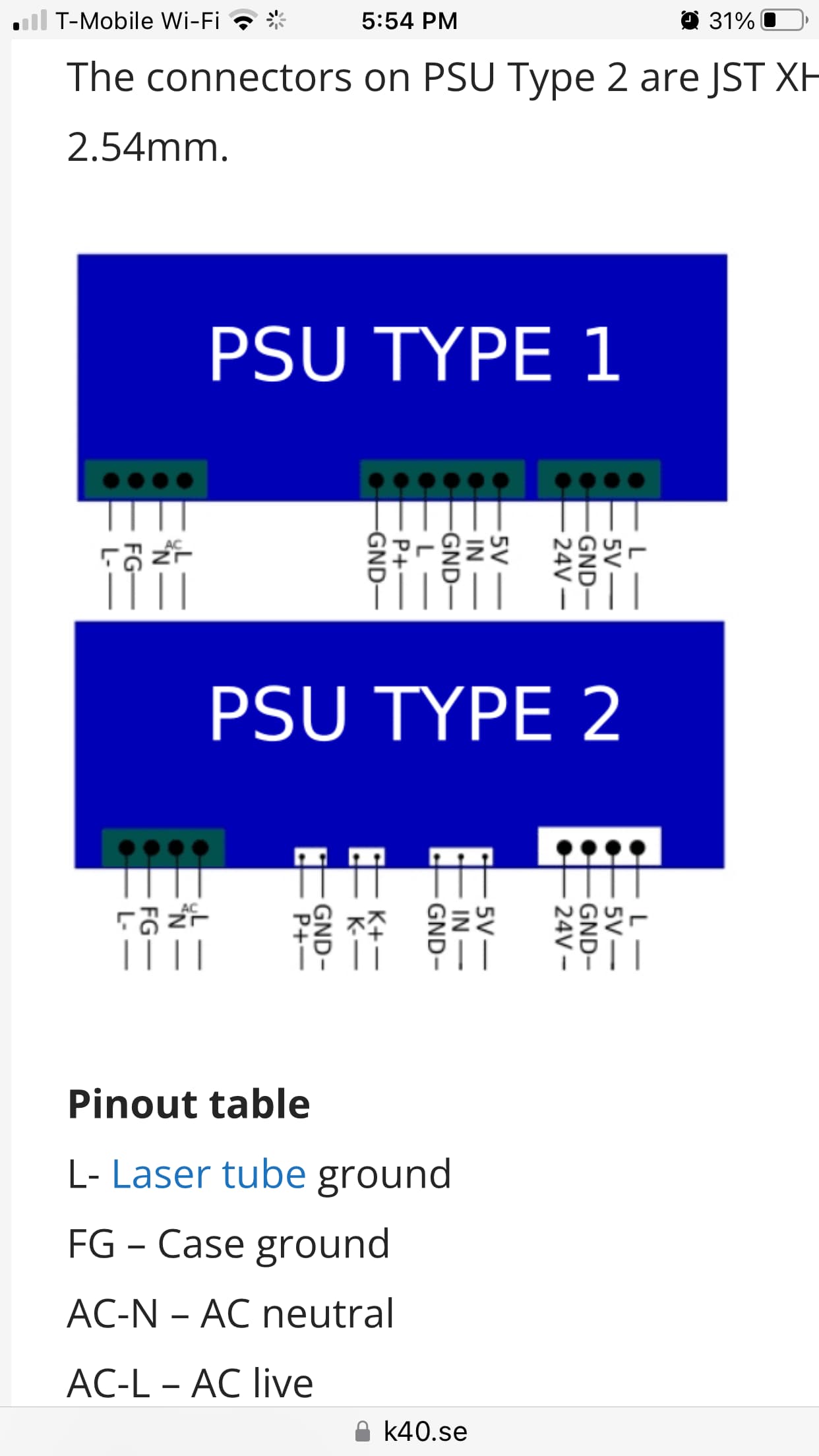

Thank you for your response. A couple of answers
  1. You are correct. That looks like my power supply

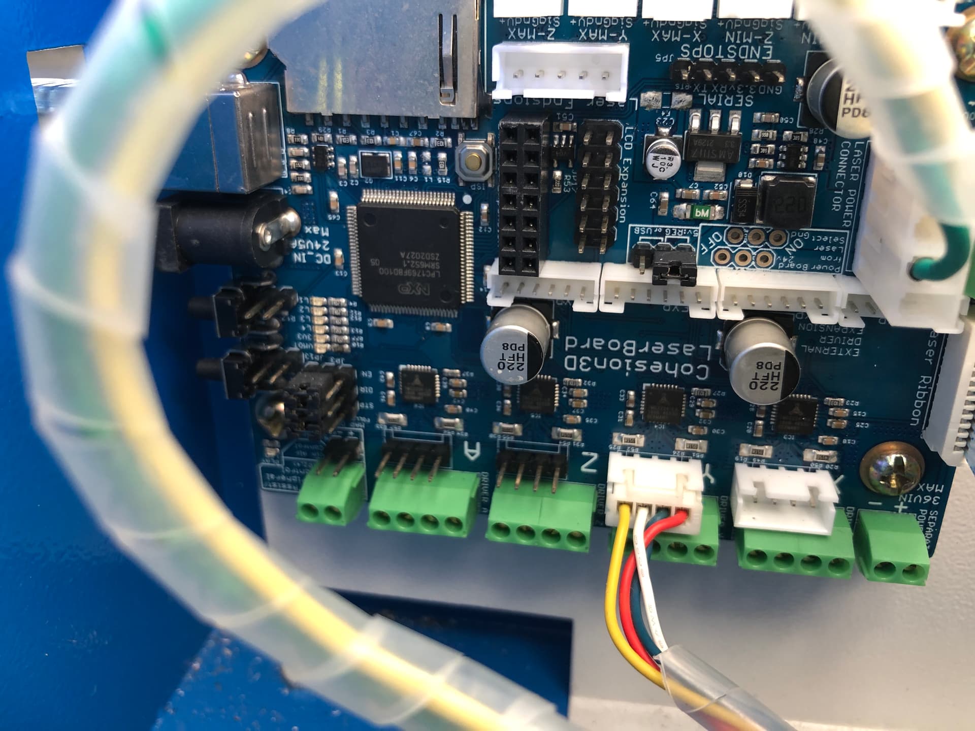

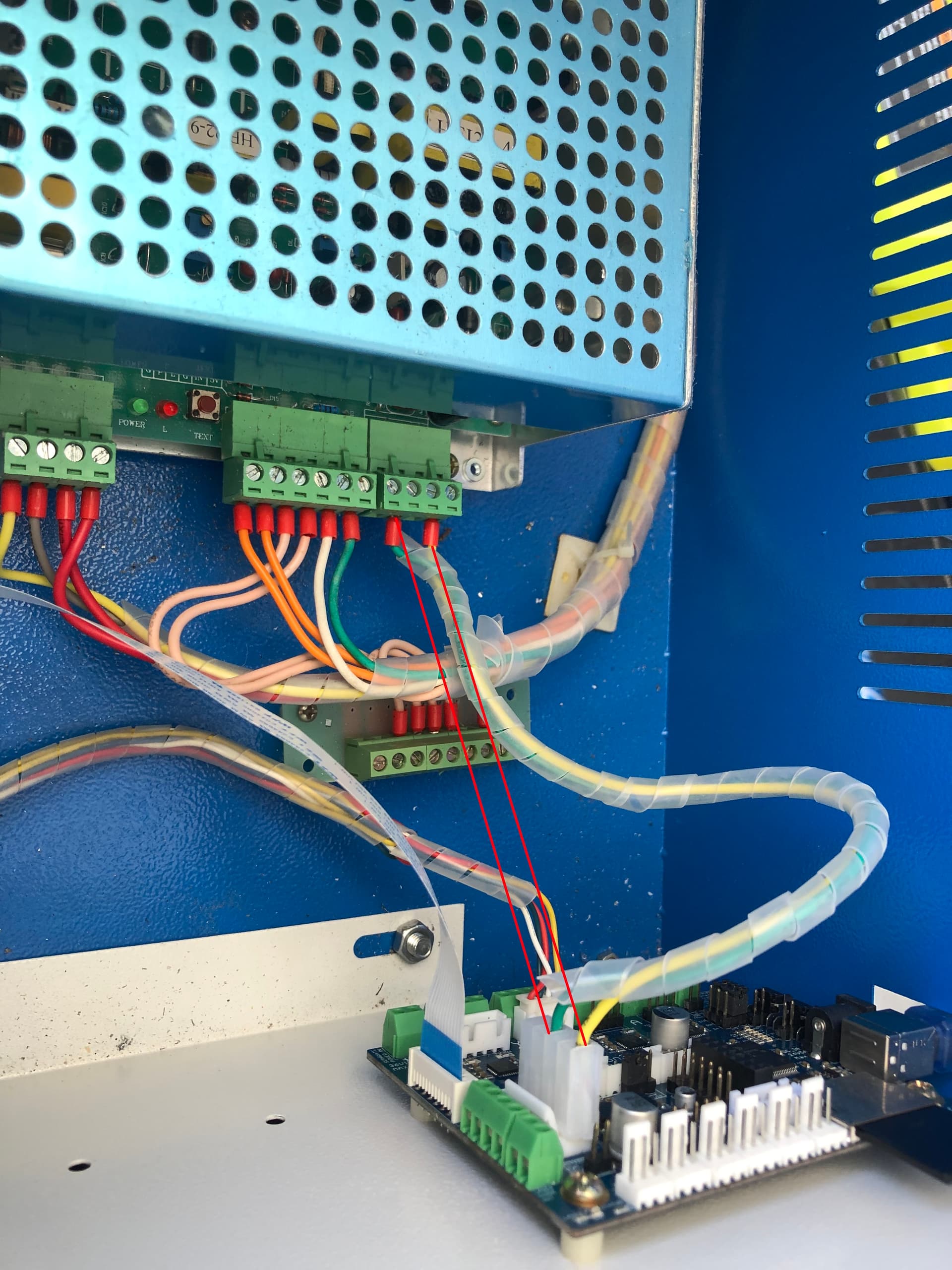

  2. I am not sure of the C3D board version, but have attached a better pic of it. Hopefully that helps.

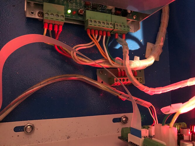

  3. I have marked the wires I changed. Based on the wiring diag of the C3D and the power supply, I connected the GRND to the GRND of the PS, and the laser to the corresponding laser on the PS.
For those of us that don’t read well inverted…
I can’t find a pin out for your board. It looks like a 2nd version model.
These show as plug and play on Youtube… Might want to watch one and double check the wiring.
I notice you don’t have home switches? Looks like only one axes also…?
I think this is the wiring for the board and for the PS
Is it wired this way?
If it is, it might need to be setup with it’s configuration file…
Yes… that is how it is set up (assuming you are talking about the wiring).
