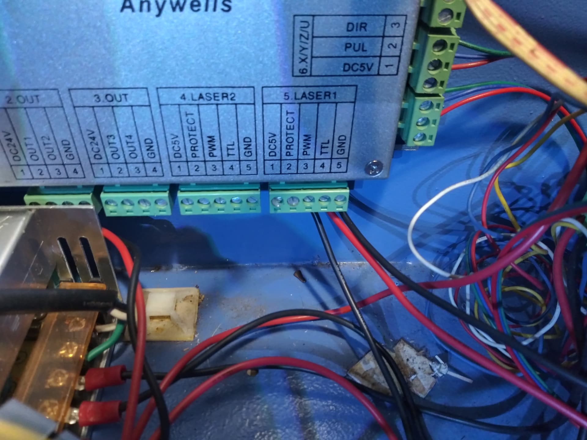

So pretty sure I have been spinning my wheels looking at the wrong thing. Now pretty sure I have it wired wrong those are the pics of the wiring and will take more after work today thank you all so much for helping out with this I love what it has became but the only thing thats original is yhe frame and the case of the laser everything else has been replaced i.e. motors.drivers.board.rails ECT.ect.ect
Your picture shows the TTL line unused.
On the top photo of the power supply, is there any connections to green connector that’s labeled “L-”?

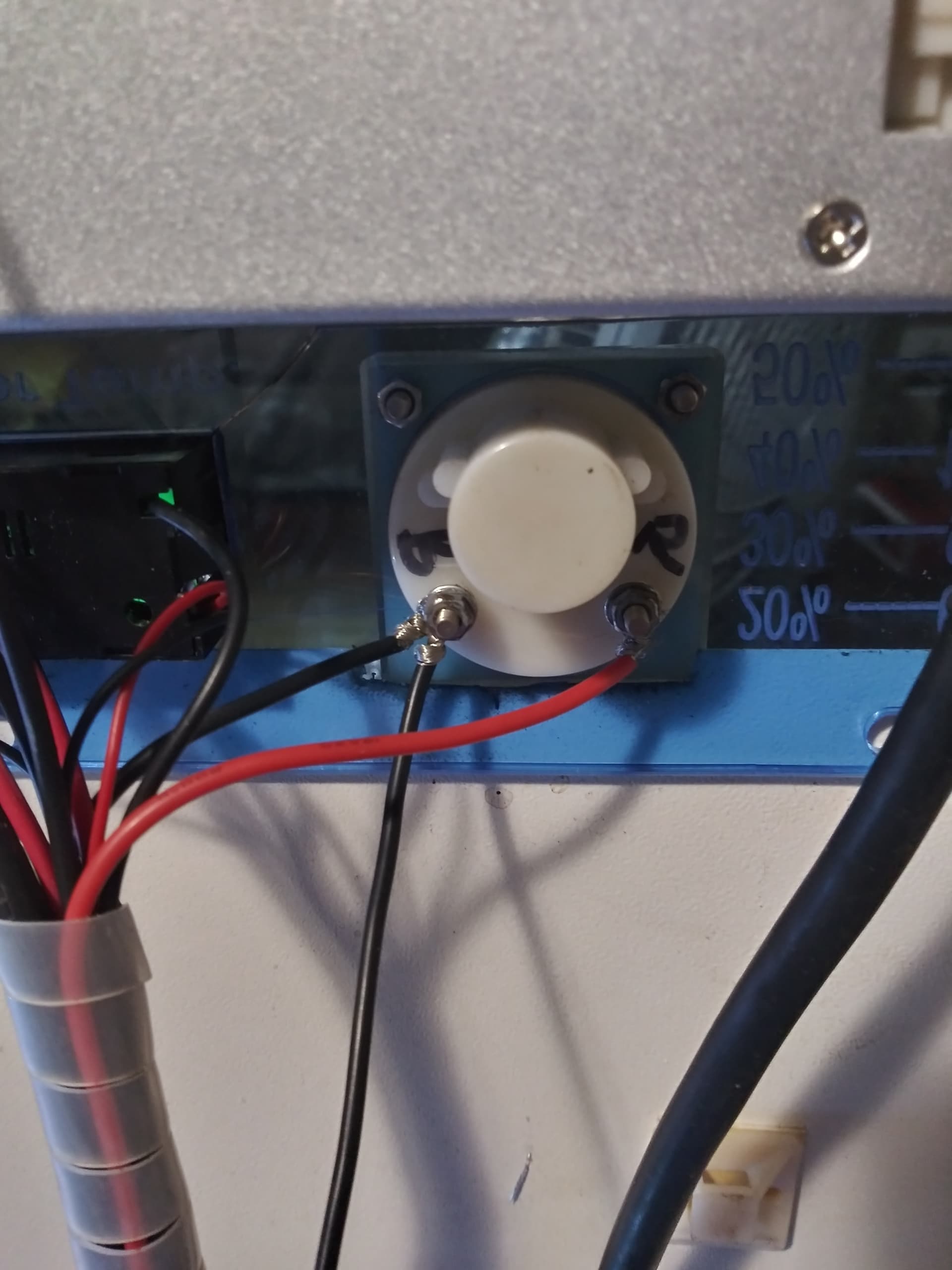

So too left pic the - L is going to the mA meter as seen in the pics last night. And I jumped that side of the ma meter to the awc608 box to the pwm
What??? Don’t do that ! That is probably the or at least a problem The L enables the laser and you
have it enabled all the time.
The ma meter is for HV current from the tube, leave it alone.
Lets try this. This is how and where the wires go the L- mentioned before was NOT hooked up to the ma meter I made a mistake it Was jumped to the fg but is now removed . this pic shows what my power supply says and where its all hooked up to. Looks like I need a wire from th “IN” to the pwm just would like to confirm sounds like we were lucky not to fry this thing
So I want to thank everyone for the help here in this. Problem was the IN and the pwm wire all is fixed now running better than the day I bought it new …it should nothing left of the original. Anyhow thank you all for your help after work I will fix the last pic I posted so maybe someone else will have the same problem on a Google search. Really thank you all so very much
