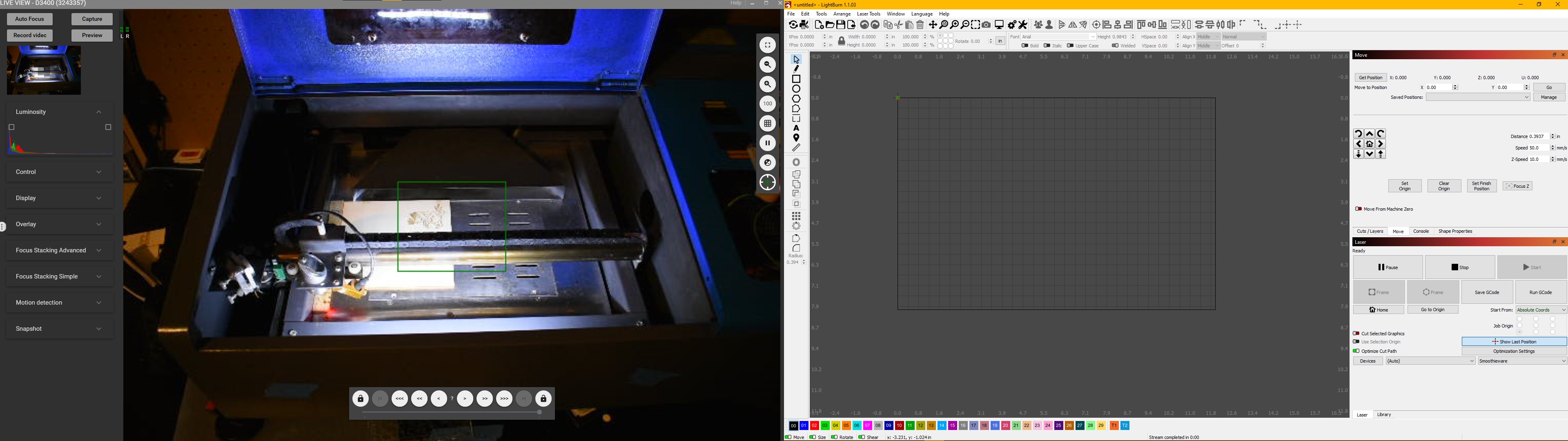

K40 with Cohesion3d problems with my Lightburn backward y-axis
when I home the k40 homes right but lightburn home to x0 y7.874 is there a way to fix that? any help would be appreciated
To which corner does your machine home? If not top-left did you modify the machine or add your own limit switches?
Irrespective of homing location you need to set your machine origin in Device Settings to front-left. I see from the screenshot that you have origin set to top-left.
top left is home

Appears home is actually front/left.? That’s where everything is zeroed out.
Is that where it goes when you ‘home’ it?
no it homes to back right I want back right to be 00
Which image is the one after it powers on and homes?
Most machines home at 0, 0. This is indicating 0, 200
I would also assume the back/left to be home if that’s where it goes, but the numbers don’t look right.

why is to og board 00 at the top left but the new board is 00 at the lower left?
I’m just going by the numbers. Maybe the new board thinks it’s that way. There are many configurable options with that board…
