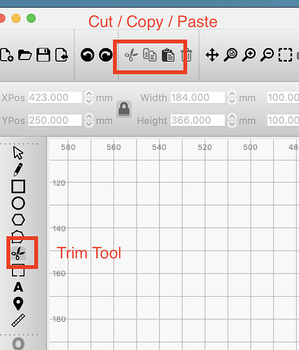

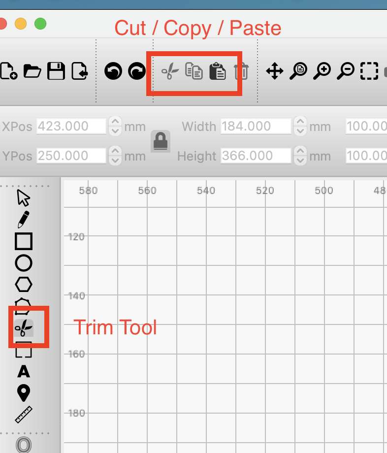

You can use the scissor tool and cut the overhangs off. You can’t use boolean tools because the lines aren’t closed shapes.
Sorry to sound dumb, but how do I use the scissor tool?
Make sure nothing is grouped, click the icon, hover over what you want to remove and click.
I tried that, but the scissor icon is grayed out unless I select something and then when I clik on the scissors, it just deletes what I’ve selected.
Make sure you’re using the “Trim” scissors and not the “Cut” scissors.

Where do I find the trim scissors? All I see is the cut scissors icon.
I showed you in the image above. What version of Lightburn are you using? It wasn’t introduced until 1.6 or 1.7, I believe.
. I have 1.5.01
That’s why you can’t find it. Use the cut shapes feature like RalphU described. It’s quicker anyhow.
