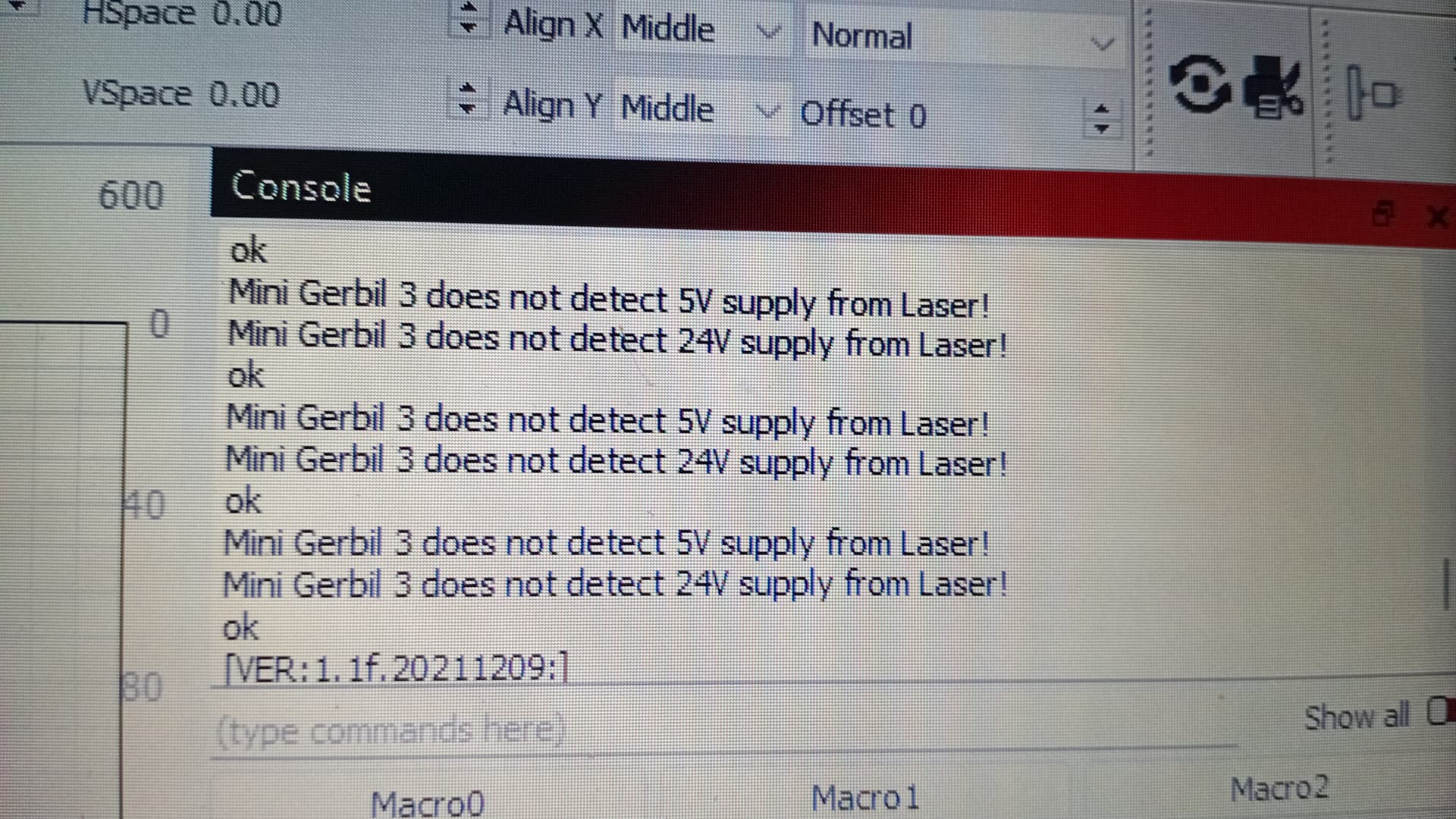

Good Day
Just bought Mini gerbil v3 now is giving is says it can’t detect 24v and 5v and also Alarm 8 error homing. Anyone who can help with wiring i will share the pictures

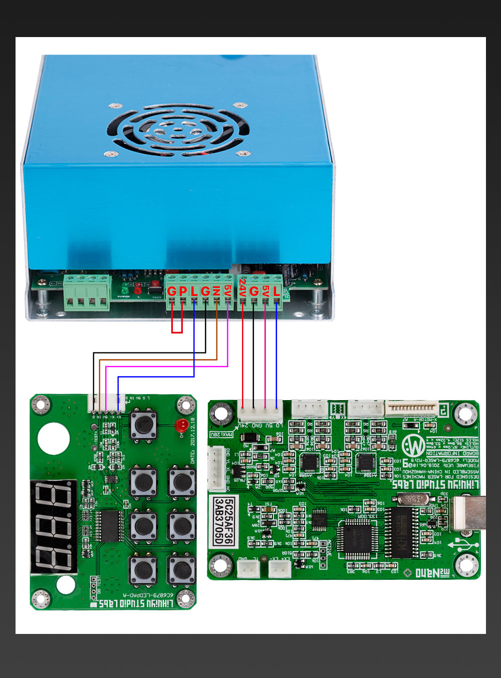

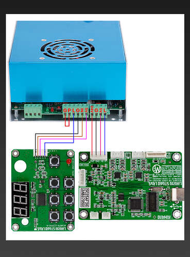

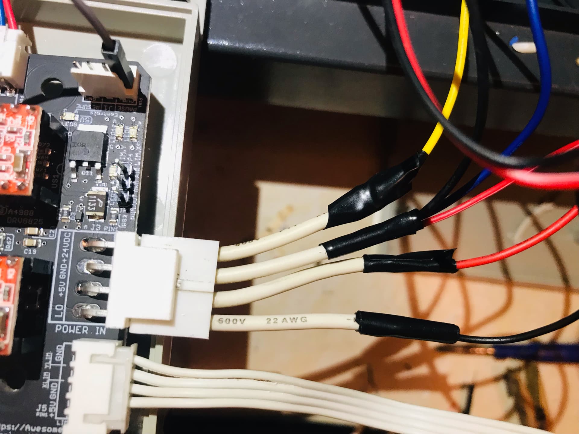

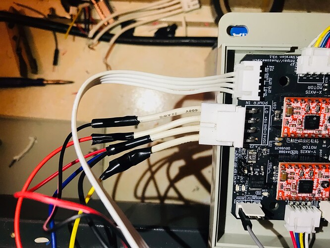

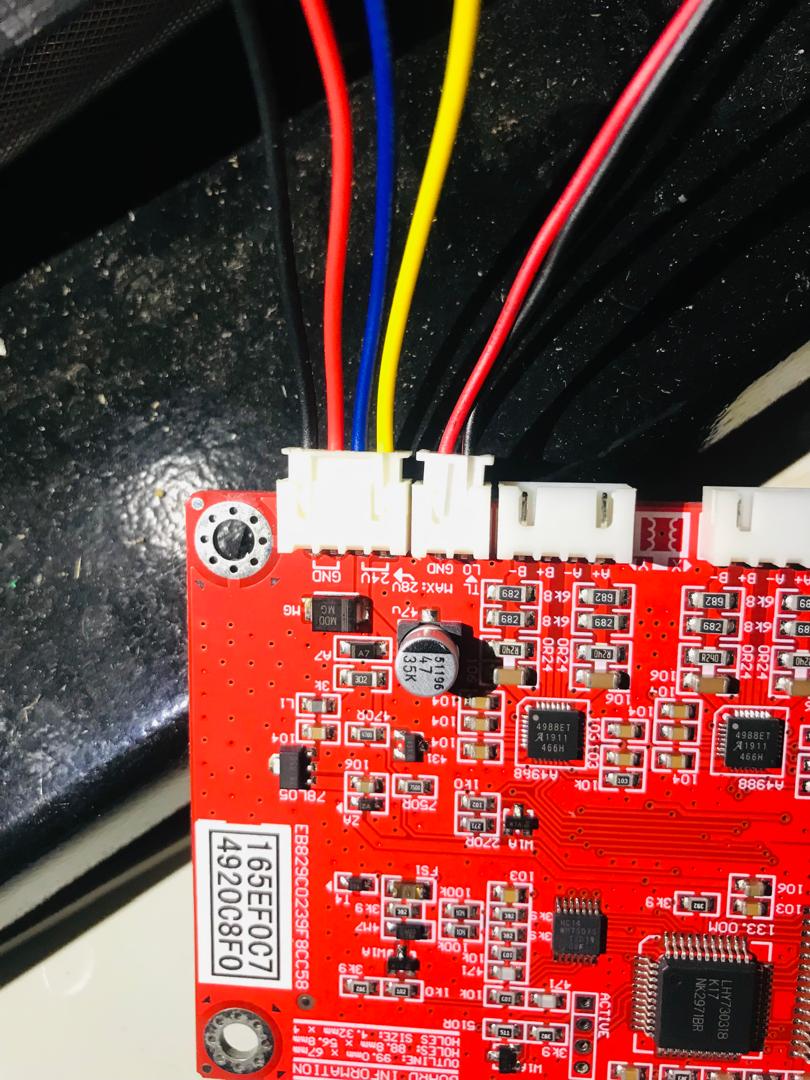

The wiring in this picture:
Suggests:
GND = Black + Red24 V = Blue + YellowGND = RedLO = BlackThis picture suggests:
The Red = GND next to the Black = LO is connected to +5V, rather than GND.
That might just blow a fuse somewhere, so disconnect everything and measure the power supply output voltages to be sure it’s still functional.
