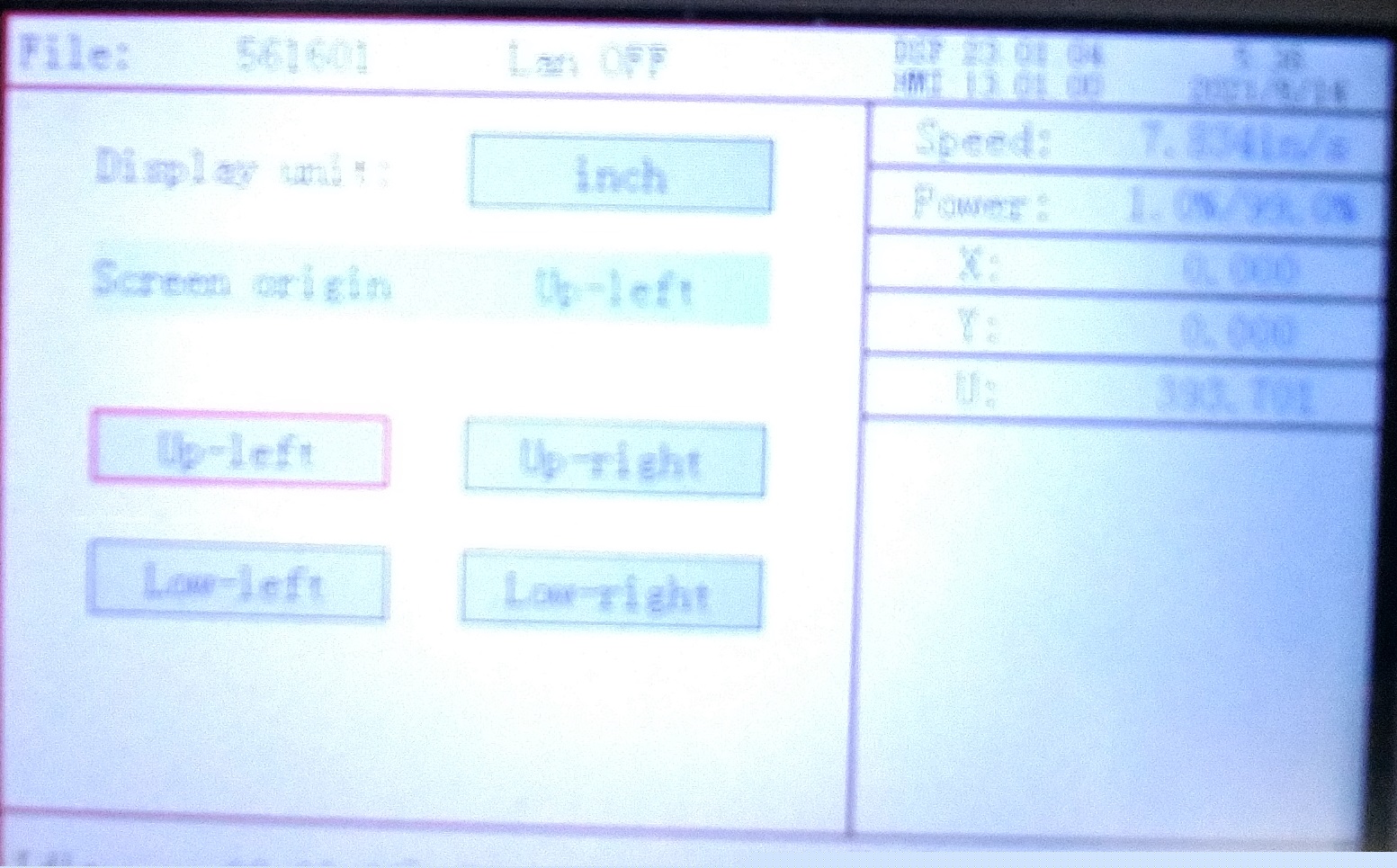

OK. I can now jog the U (Z) axis up and down using the Z axis up down buttons and settings on the mover tab. the problem is my machine is displaying inches. now when I put in 1.2 for the move and .05 in/s for the speed it actually moves in mm. it moves z 1.2 mm and puts 1.2 on the display, but then I can crash my head because instead of 1.2 inches I only have 1.2 mm.

Ruida controllers do not understand inches - they work exclusively in mm (technically in thousandths of a mm) internally.
If it’s showing 1.2 on the Ruida display, then it has only moved 1.2mm. If you tried to move 1.2 inches, the Ruida display should show 30.48mm - that’s the metric equivalent to 1.2 inches.

Can you tell me how you managed to get your controller to display in inches?
When I look at the controller display for speed, for example, the display itself shows mm/s after the speed number. Does yours show in/s? If so, how did you configure it to do this?
I don’t have a system here yet with a movable Z axis configured with a harness so I can connect the KT332N controller, but I should have one within about a week, and then I can try this on real hardware, but I’d need to figure out how you were able to get the controller to show inches so I can emulate your setup.
Sorry about the quality, but from the main menu i select screen reference and then there is the unit setting and where you want your stops. Anything you want me to try or do to help I am game. I am not worried about machine damage or screwing up the control. We are not going to mess anything up I can’t fix. We have multiple machines with spare parts coming. Thanks for your time.
