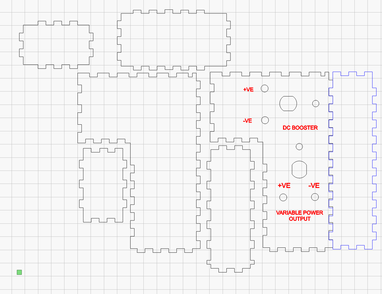

So this is what I managed to do, took me a good couple of hours. I then cut it with the Laser and despite setting the Kerf Offset to 0.18 it was impossible to fit the tabs into the grooves.
When I lined them up they do not appear to be lining up correctly.
Not sure how to rectify these problems

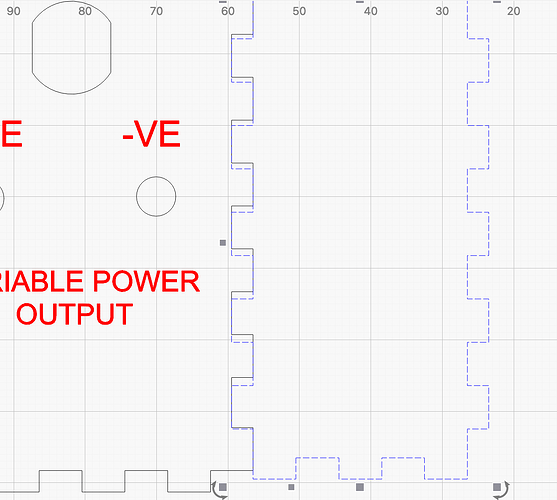

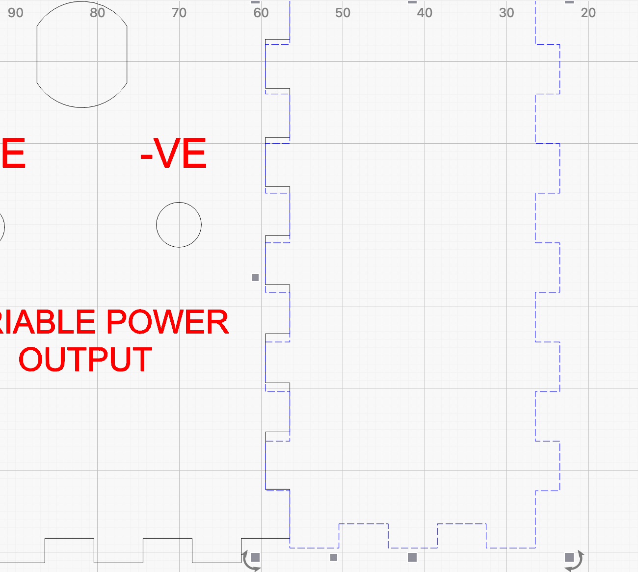

Not sure how you got here, but your slots and tabs don’t align on screen, so they certainly won’t align when cut. I aligned your long side to the first slot at the top and this is what the bottom looks like. See how the discrepancy increases as you go down?
None of the other pieces appear to align either, and I’m not sure where the large piece up top is suppose to fit.
I didn’t have time to make a how to, but this should get you what you need so you can move on with your project. The hardest part to figure out is the inside corner. I think it’s correct, but until it’s cut???

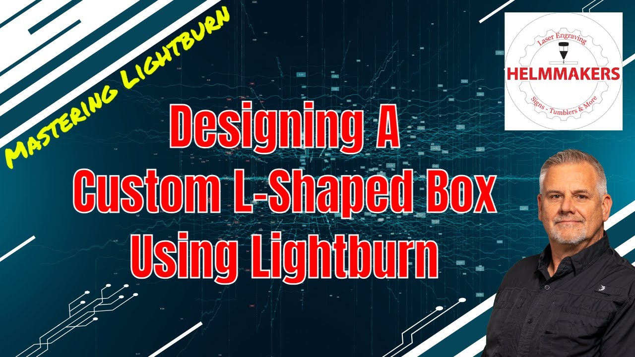

Here is the video showing how to create this box. It’s a bit long, but there is a lot of information.
Amazing thank you very much. I am going to follow this and will produce my finished product
