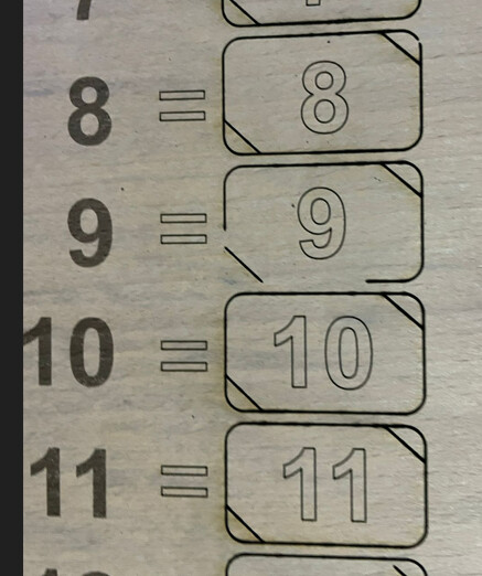

When I give some drawings for cutting, some parts are not cut. What is the reason for this? this is an example of that problem.look at the 9 .it’s rectangle have not complete cutting.

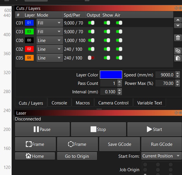

this is the file and seetings

this is the file and seetings..My machine is two three ts2 ,10W.

I don’t see anything obvious in your file. Try changing the red layer setting to constant power and see if that helps. Another thing would be to try just cutting one of the squares you are having issues with and see what happens. Is it always the same squares you are having isues with? Is it more than one square?
