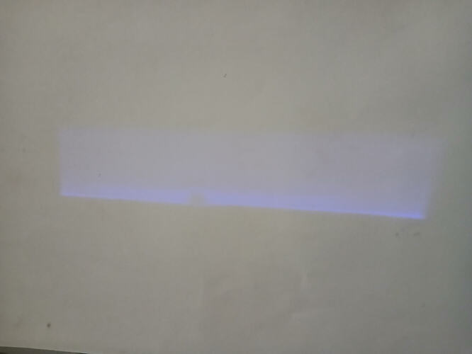

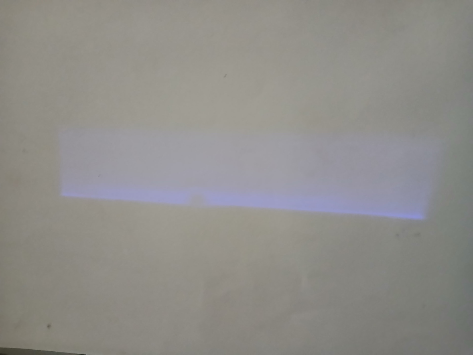

Here is a picture of my laser firing from about 6 feet from the wall, not very clear unfortunately but hope it helps
many thanks again

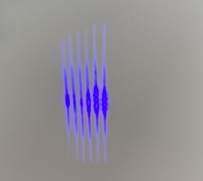

That’s definitely not ok, here is a picture of the S30 Ultra 33W, which has six lines:
You module should have at least two distinct lines, maybe four (depending on generation).
