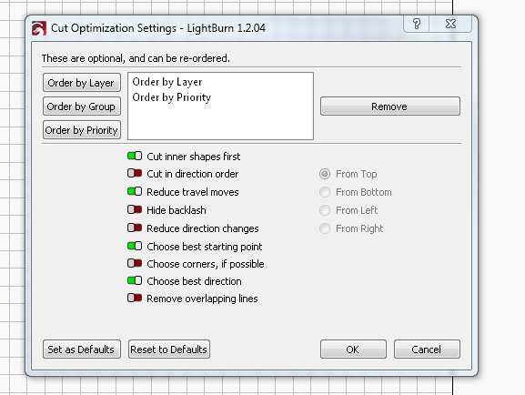

I am creating a page of individual lamacoids, three across by three down, each with text. I would like to Optimize the cutting and fill.
When I preview, I see the fill starts in the upper left, starts working across, pops down to the bottom row, does some fills there, and than pops back up to the top. Once the fills are complete, it starts the cut-out process from the bottom to the top.
Is there a way to force the fills to start at the bottom and work their way to the top, or is that only an option for cutting??
Thanks…
Go to optimization settings and turn on reduce travel moves. Not sure if it will give you what you want but it should speed things up for you.
