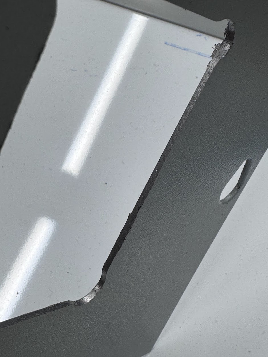

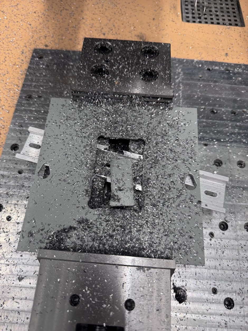

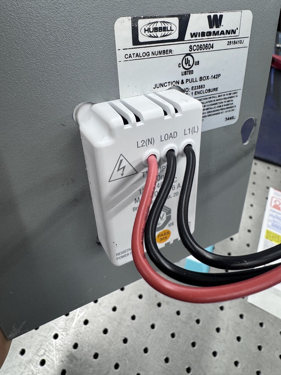

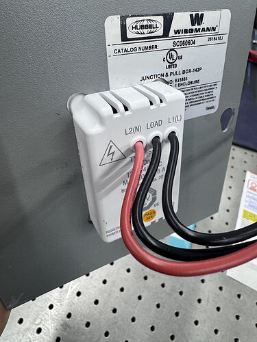

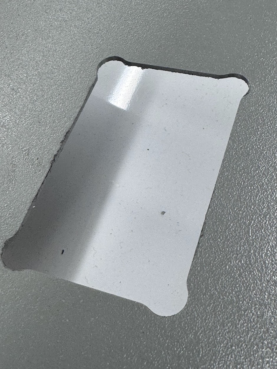

Used trochoidal tool path to cut a knockout for a thermostat box over the weekend. The benefit of this type of toolpath is reduced tool wear and reduced cutting forces, which on thin material and sketchy workholding helps a lot!
I used a little piece of aluminum DIN rail to space the panel off from the vise bottom
Cut quality right off the machine was excellent
And it fit the thermostat nicely!
