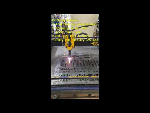

Having a lot of fun and success with LB and my recently built Mill Right Mega V Plasma/Router CNC. This is a video of the last 2 mins of a recent large job, 15 min total cut time, 86 pierces, 30"w x 26" h.
Enjoy.
