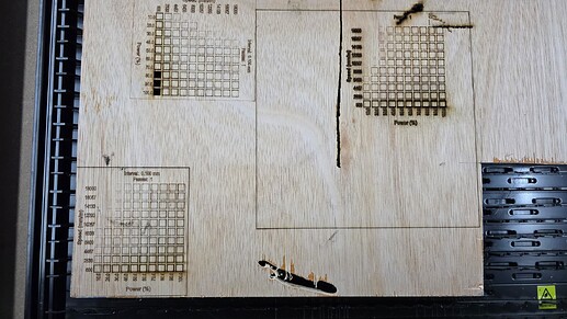

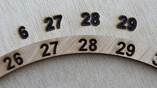

I set up my laser last year, did some material tests and then designed a project. I was happy with the sharpness of the resulting pattern. For various reasons, it took a while for me to get back to the project. Although I’m using the same files, burn settings and material, the pattern is now coming out less focused.
Bottom row are the numbers I burned last year, and top row is the same lightburn file with same settings. Laser burn settings used in both:

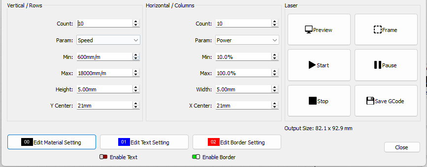

I tried running the material test in Lightburn to check it wasn’t an issue with my files.

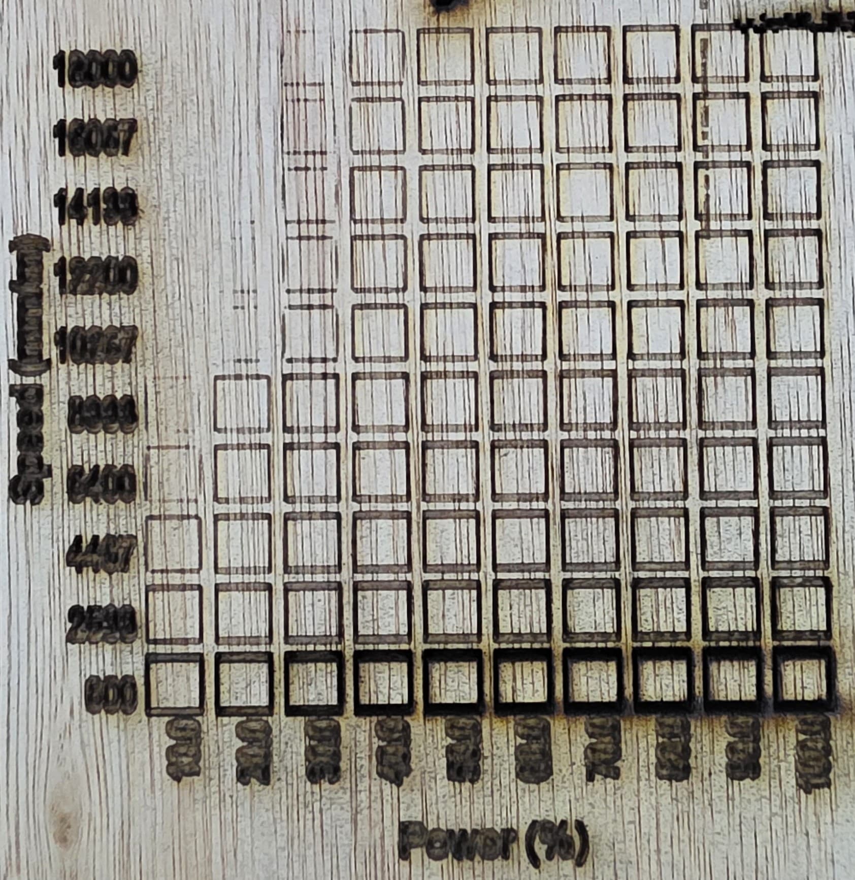

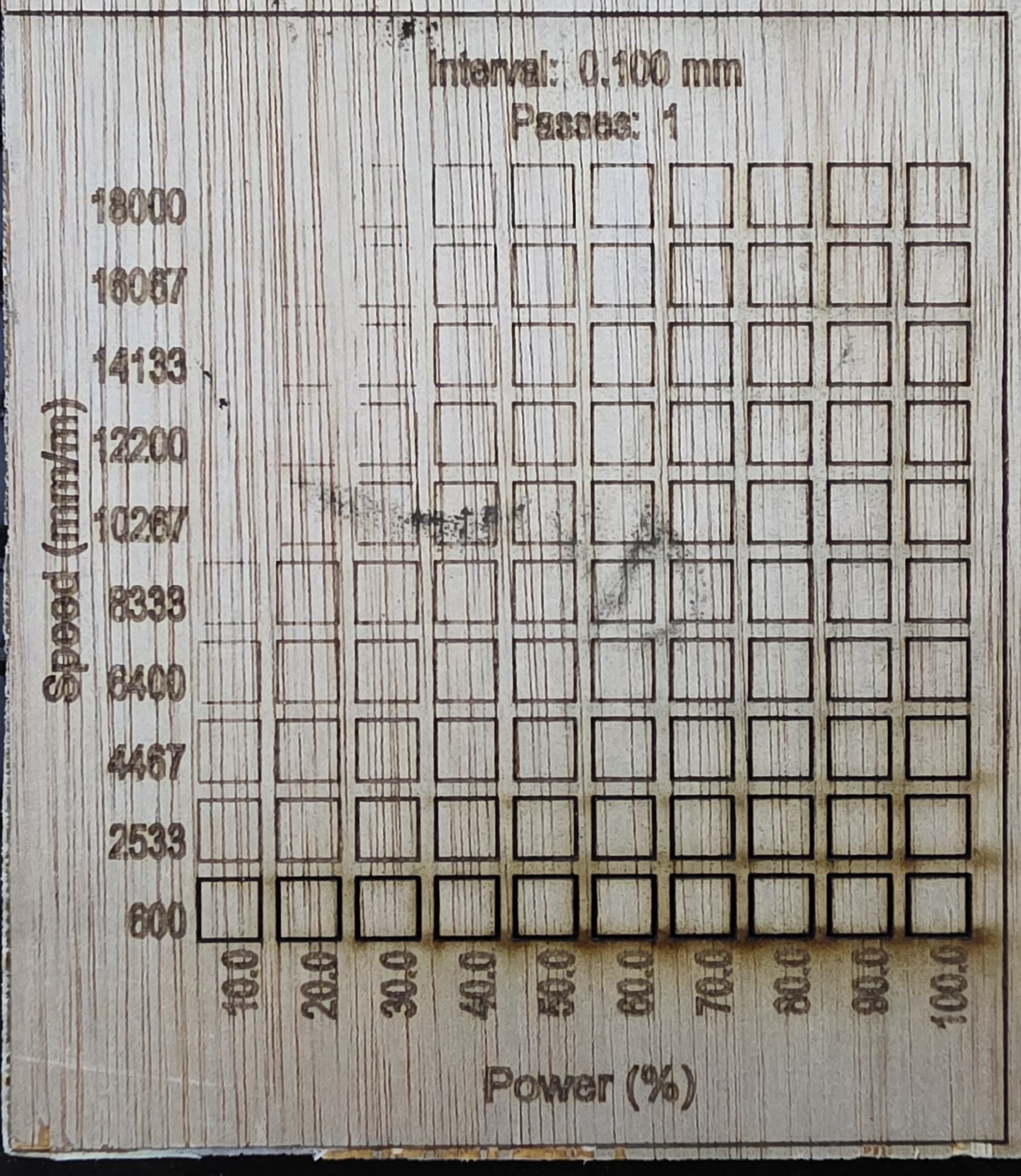

Setup last year - nice crisp lines with legible writing:
And now - thick lines and deeply embossed writing to the point of being illegible:

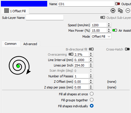

I used stock material test settings both times:

Final picture to show old and new material tests were conducted on the same piece of test wood:

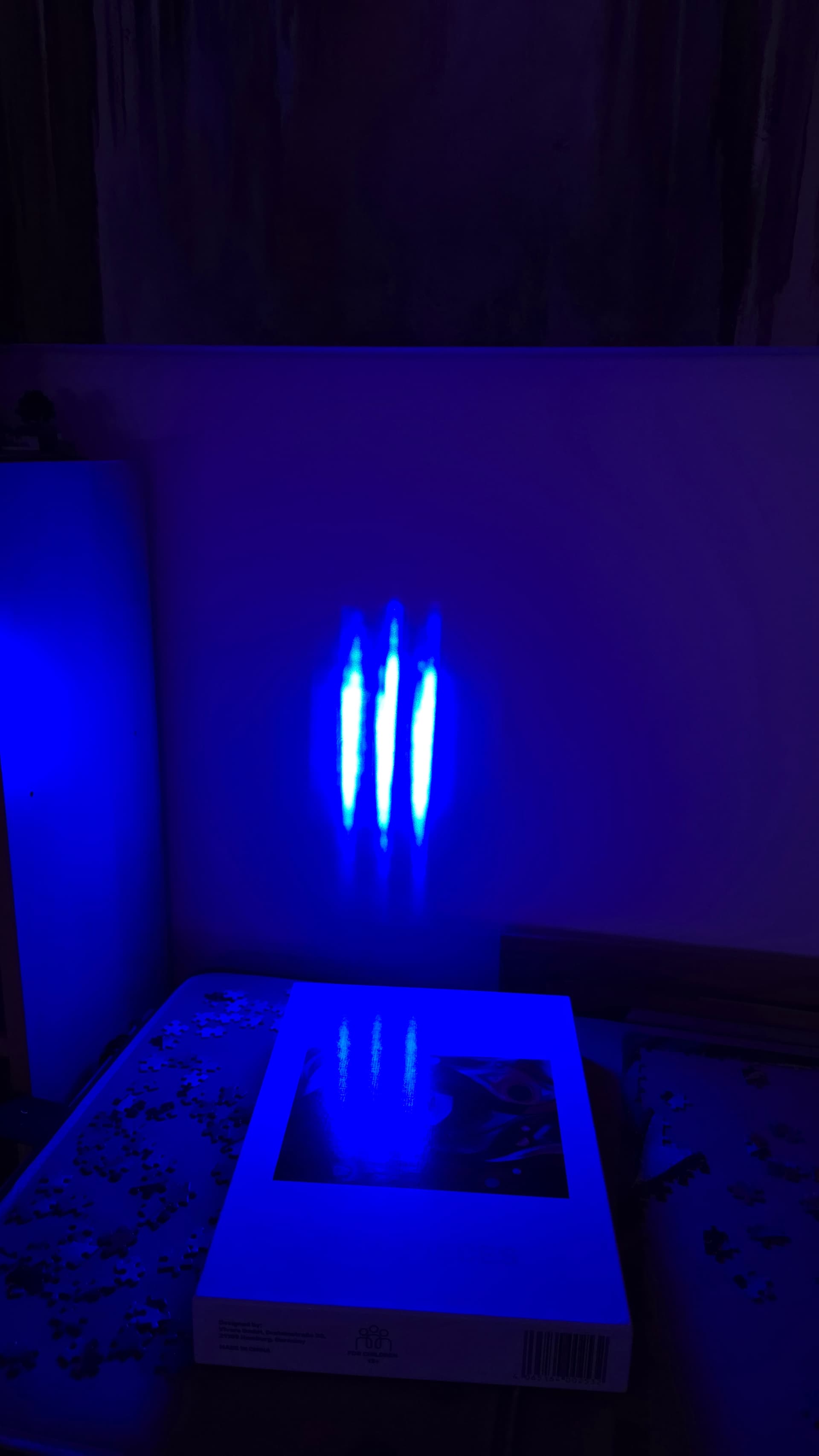

Did you check the lens? Lenses must be maintained regularly. Clean it first. You can also do a wall-test to see how the beam shape looks like.
Side note: offset fill is really bad for text. Use normal fill for letters.

As mentioned in the OP, I did clean and check the laser lens but sadly that didn’t seem to help. I did a wall-test using these instructions, and have attached the pictures below. Wall is just under 3m from laser head.

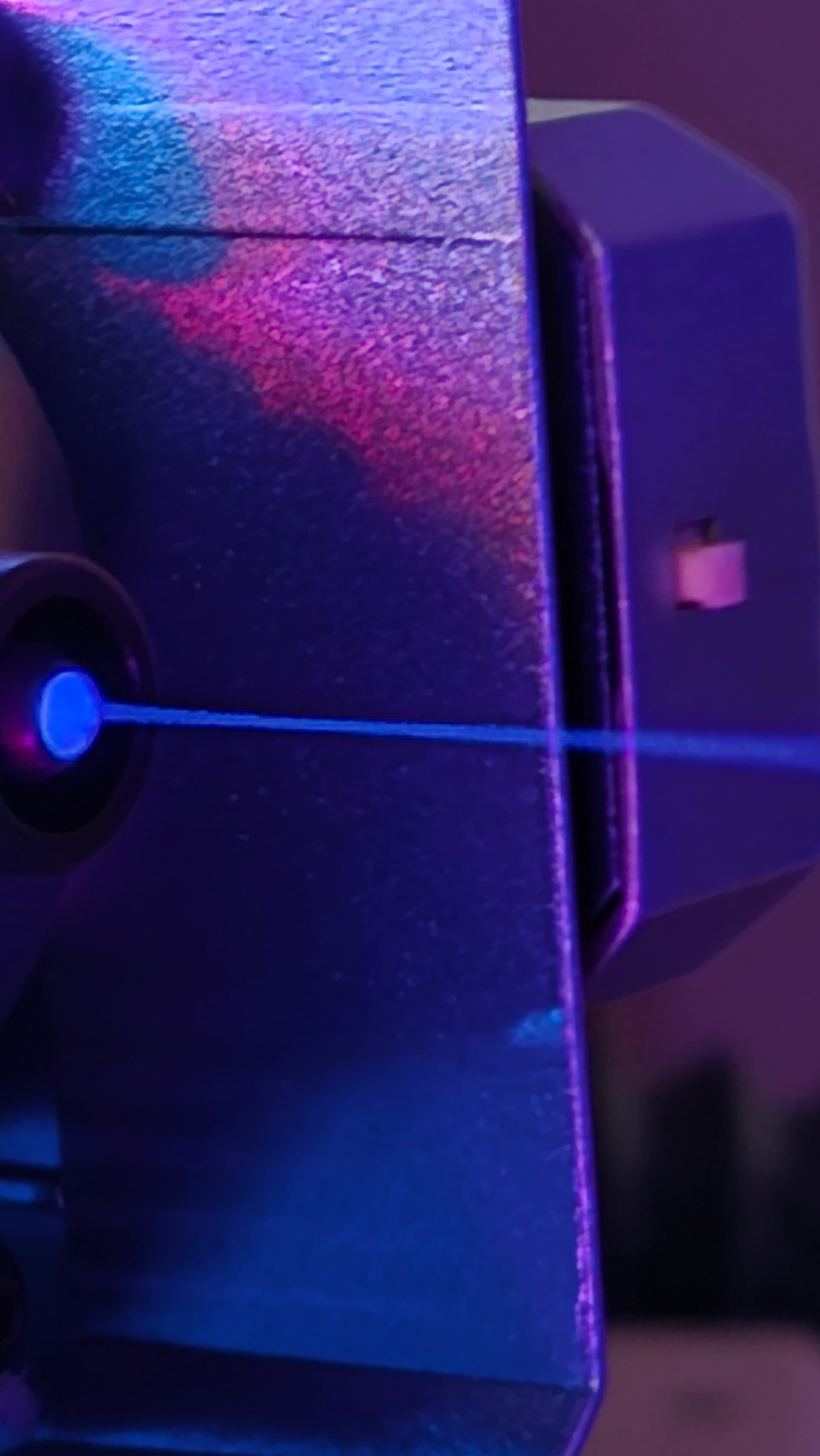

If this is the machine:
Then it should have six laser diodes concentrated into a single spot:
Seeing only three spots on the wall suggests half the laser diodes are missing in action. I don’t know how to interpret the rather ragged outlines for the three spots in your machine, but the Sculpfun S30 33 W machine with six laser diodes shows six distinct, albeit dissimilar, spots.
If you set the machine to less than full power, the controller may turn off some of the diodes, so run the same test at full power to see if more spots show up.
If full power still produces only three spots, then a new laser head may be in order. Perhaps iKier’s tech support will have better information, although their scripts may not cover a wall test. :man_shrugging:
Hey, thanks - I really appreciate you taking the time to have a look. Yep that’s the laser.
Test firing only allows me to go up to 20% but it stayed on 3 lines so looks like you’re right again. Guess it’s time to bite the bullet and get in touch with iKier CS!
