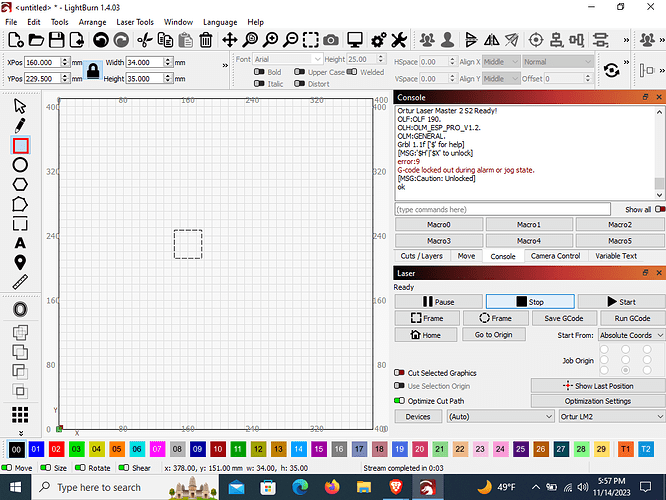

My laser worked out of the box and initially with lightburn no issues. All of a sudden it started “acting like it didn’t know where it was” (that’s the best way to describe it). When homing or trying to frame it will hit the sides, make a loud noise and stop. Once in a while it was go like normal, but then if you frame for a second time it will do something completely different. I have researched and looked at all the settings I can understand to no resolve. I have removed my laser from lightburn and readded. I grabbed the settings I thought could be helpful!
I would slow $25 down and try.
Also while homing activate each limit switches and see if it stops homing. Watch to see if switches are being triggered when it homes.
Unfortunately that did not do anything.
