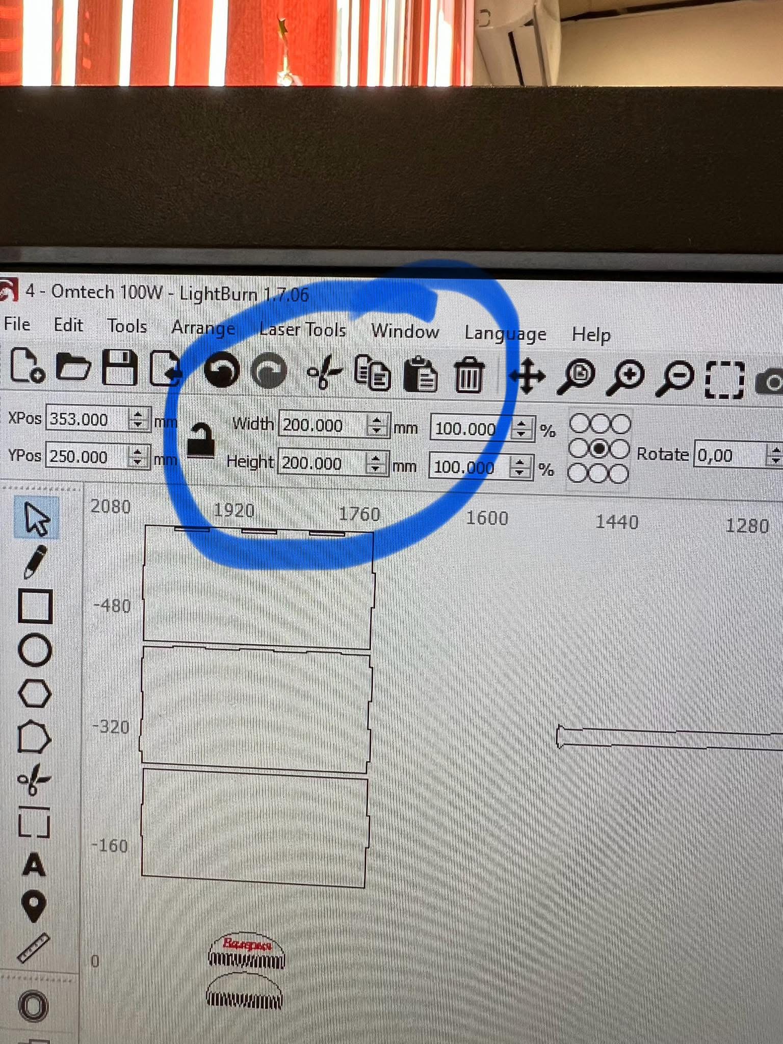

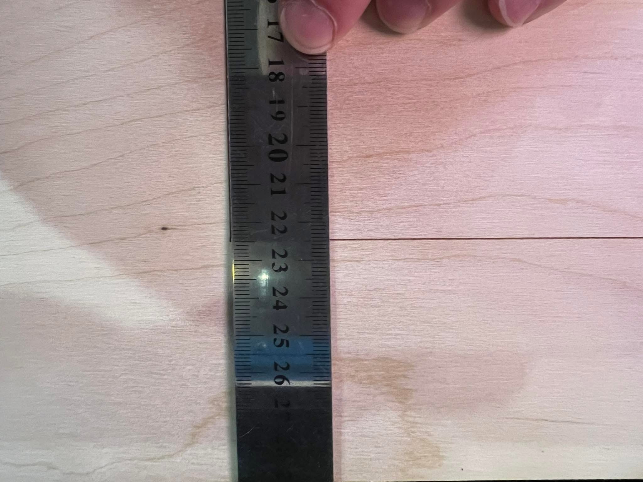

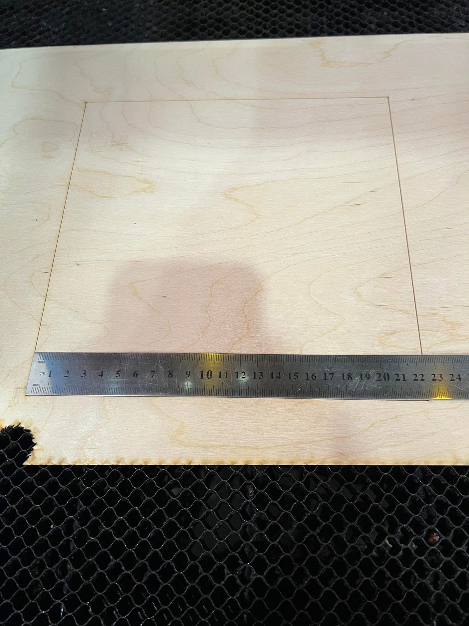

Now everything is working fine, and the laser cuts like new. However, a rather strange problem has appeared. When I set the work area dimensions in the software to 200x200 mm, the laser cuts a square of 225x225 mm.

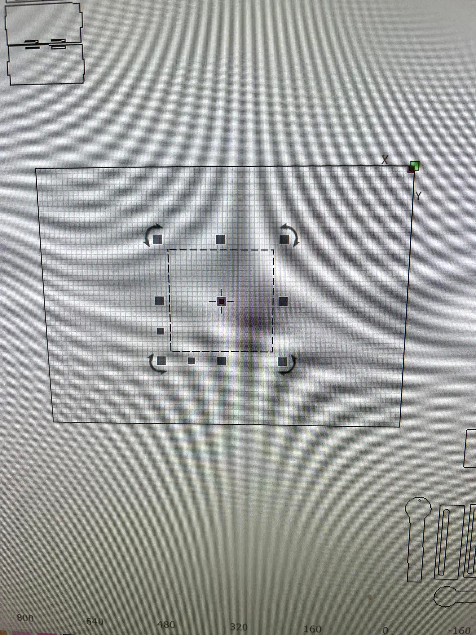

Thank you for your help. I followed your advice and used the axis calibration tool in LightBurn. When I set the value to 200/200 mm, I get an actual burn of 200/200 mm. However, now another problem has appeared. When I set the value to 400/400 mm, I actually get 401/401 mm. Only a 1 mm difference, but as you know, for projects, this can be critical.
I calibrated again for 400/400 mm, and it was perfect, but when I cut 200/200 mm again, I got 199/199 mm. This happens every time with different sizes. I cut a ready-made project that I have done multiple times before, and there were indeed discrepancies. The same happens with engraving—small differences compared to what is in LightBurn.

Most likely, you’re measuring the size of cut parts, so they’re smaller by the kerf = cut width. Your laser also has a slightly rectangular spot, so the kerf will differ along the X and Y axes.
Instead, set the layer power to mark paper / MDF / plywood, scorch the square, then measure the distance from center to center of opposite sides.

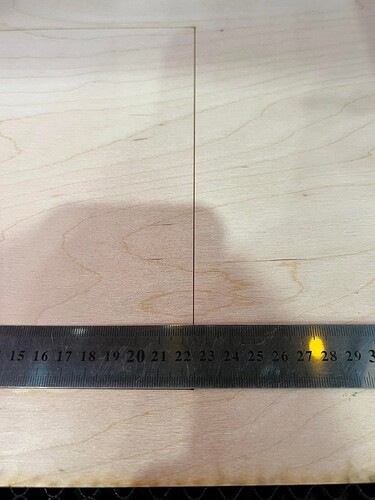

I’ve done the calibration with a steel scale:
Position the center of the focused dot on the center of the scale lines and remember that your laser has a slightly rectangular “dot”.
Then you can compensate for the kerf and make the actual cuts measure very close to the nominal regardless of the part size, within the tolerance of the kerf.
