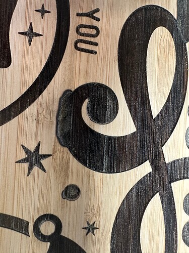

Since I have updated the Lightburn Software to the new version 1.4.03 a project that I have done many times before with no issues, is now incinerating random areas of the project. I don’t know what has changed or how it could be doing this. I have an Omtech 60 Watt 16X24 and have never seen this issue before. Anyone seen anything like this before?

Also: are the pictures oriented the same way they’re engraved, with the scanning direction going left-right across the picture?
The pictures came thru oriented in 90 degrees from what I engraved them too. Looking at the picture it would be up and down, but we know it is side to side. The laser is only 4 months old and has only 250 hours on it. I will check the mirrors and the main focus lens to see if there is any issues.
I corrected their orientation.

It definitely looks like an optical problem, because the blotches extend irregularly on all sides of the pattern’s proper location. That’s not the sort of thing you can get with a timing error or configuration mishap, although those are surely what OMTech will first propose. :person_shrugging:
I checked the Lens, it was tight and clean, plus I checked the mirrors and their alighment. All checked out OK. I will reach out to Omtech Tech and put in a trouble call. Thanks Ed.

Your engraving is quite dark, almost charred, and you say you’re running a 60 watt, which leads me to believe you’re probably running pretty slowly to achieve that look on bamboo.
The areas you pointed out have all the tell tale signs of a prolonged burn. (prolonged could be even a second longer than normal)
I’m only basing my thoughts on the limited info you provided, but by visual inspection alone, I’m relatively confident that you’re going to find that it’s got nothing to do with your tube or your optics. I think your machine is fine.
I’m not being argumentative, but I’m inclined to disagree with others on this one, and I’ll explain why, and what my theory is… I think it’s worth a look either way. My gut instinct is to go in the complete opposite direction with your thought process. This isn’t a competition, I just know how I’ve seen this exact problem on this exact same material, and was able to remedy the situation. There is no guarantee it’ll be your solution, but it’s worth investigation.
I Have a 60 watt, a 120 watt, and a 600 watt RF, and I can pretty much duplicate your result on purpose by momentarily stalling the x axis by grabbing the belt.
The areas where you have the blotch are clearly a bit deeper, and slightly cratered. There is almost no situation I could think of where if your tube were failing, your power would substantially increase, or cause your beam to suddenly increase in diameter to what looks to be in the ball park of 5-6 mm.
If you look at your burnt spots with a magnifying lens, I believe you’ll see that the anomalies you’re experiencing are not the aggregated result of several passes, but rather one burn. I say this, because there is a rather heavy burn outside the boundaries of your vector.

Judging by the photos you posted, this is a larger piece, I’m guessing you’re using a decent line density, and the that file size is not exactly tiny.
I’m also noticing that the problem seems to manifest itself about 1/4 of the way into the file, and then starts happening again and again. I’ll bet this file takes a while to complete, and you didn’t keep your eyes glued to it the entire time. I know I don’t have the attention span to watch an entire engraving usually… lol
This would indicate to me that the initial buffer is running out, and the laser is either slowing momentarily, or stopping, to “catch up” with the new incoming information. That’s all it takes for the engraving to pop a little flame, and make a burn. Assist air will make it burn a nice little crater in a fraction of a second.
There are two ways you can test My theory. The first is to Hold the “Shift” key while you hit start, or to send the file, then hit start on the machine. This will send the entire file to the machine before cutting, which will eliminate all possibility of a bottleneck in the transfer disrupting the process. I’m willing to bet that it does not happen if you do this.
The other option, is to simply reduce the power so that the engraving is not black, and run the file the way you always do, but watch it the entire time… When and if a burn occurs, you’ll be able to see exactly what happened. Did the spot get brighter? Did the travel slow or stop? either way, the burnt area will have sharp contrast to the normally processed area, and it should be much more apparent what happened.

Bamboo is fibrous and irregular. Unlike other materials where if you pulse the laser, it will create a pretty uniform hole, if bamboo hits the point of combustion, the burn follows the grain more or less, resulting is a remarkably different shape every time.
My theory is that if you can catch this happening real time, the anomaly will be accompanied by a flame, or glowing embers blowing from the charred area.

A slowdown in the middle of engraving would definitely explain a lot of what’s going on, although torching a resinous / knotty / weird spot in the bamboo seems more likely.
Duplicating the problem on, say, cardboard would rule out most of the material issues.

Ed & Steve, Thank you both for you input, I think I might have seen a small glimpse of what happened. I was doing another board with a different file and noticed where the laser was going back and forth in a small area, the air coming out of the lens made the embers glow more than they would have if there was no air. Like you all said, it could have been a bunch of small areas that either had some soft bamboo or resin and with the air blowing on it and it being a small area that the laser was focusing on, the air fanned the embers and created a small fire inside the board. and if anything, I’m the box of rocks, not the 2 of you. Let me know what you think, I don’t think there is any way to turn off the compressor but I did see you tube video of people adding a regulator to be able to adjust the air when you engraving verses when your cutting. Is this something you would suggest? Thank you again for you help and input.
That makes more sense than my notion of the tube going kaflooie and will be much easier to fix.
