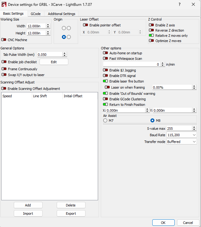

New to Lightburn. Just installed Lightburn and was setting up my laser. Ran a test design and the laser is cutting between the lines when traveling. I have read the previous forum comments on similar issues like this and I have made the changes that were suggested but it is still burning lines when traveling.
I am running a Jtech Phototronics 64w pro on a HP Laptop with Windows 11. GRBL is version 1.1g.
Here are the codes from the console. I increased $30 to 1000 and changed the s-value to 1000 but it never resolved the issue.

Was one of those suggestions to make sure you are using GRBL without the -MPC or -M3 suffix?
Was another to use the lbdev file supplied by the manufacturer?
As far, as I know, the Jtech Phototronics is only the Lasersource. Which CNC and controller did you attach it to?

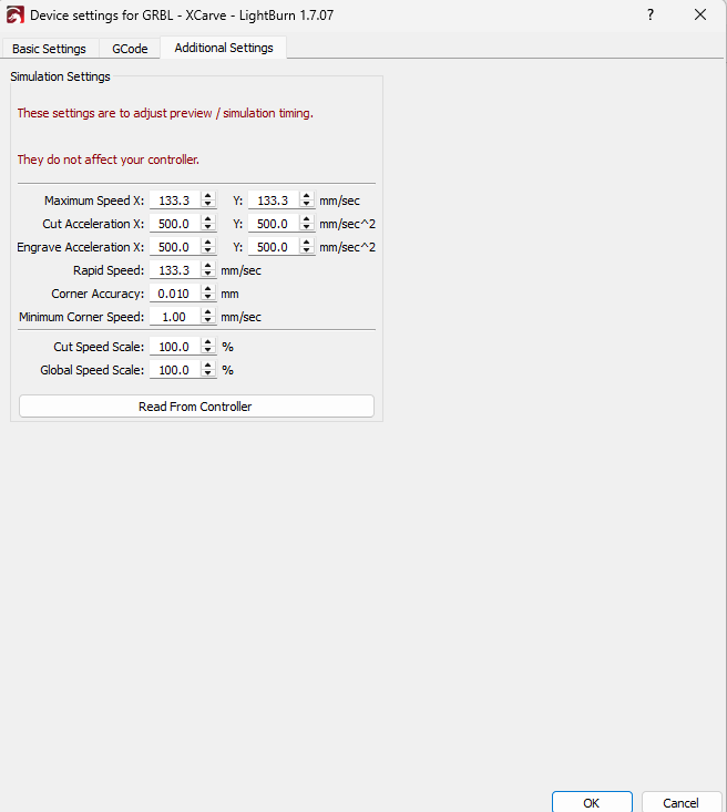

Please show us screenshots of both tabs of your “Edit > Device Settings”.
