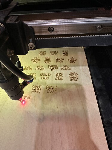

It’s a file I desgined in Lightburn and have cut at least 100 times. I will post a picture. It does look “okay” but it’s darker than I like. It creates more “char” on the back of the wood which I don’t like. It just seemed like it was burning SO much darker.

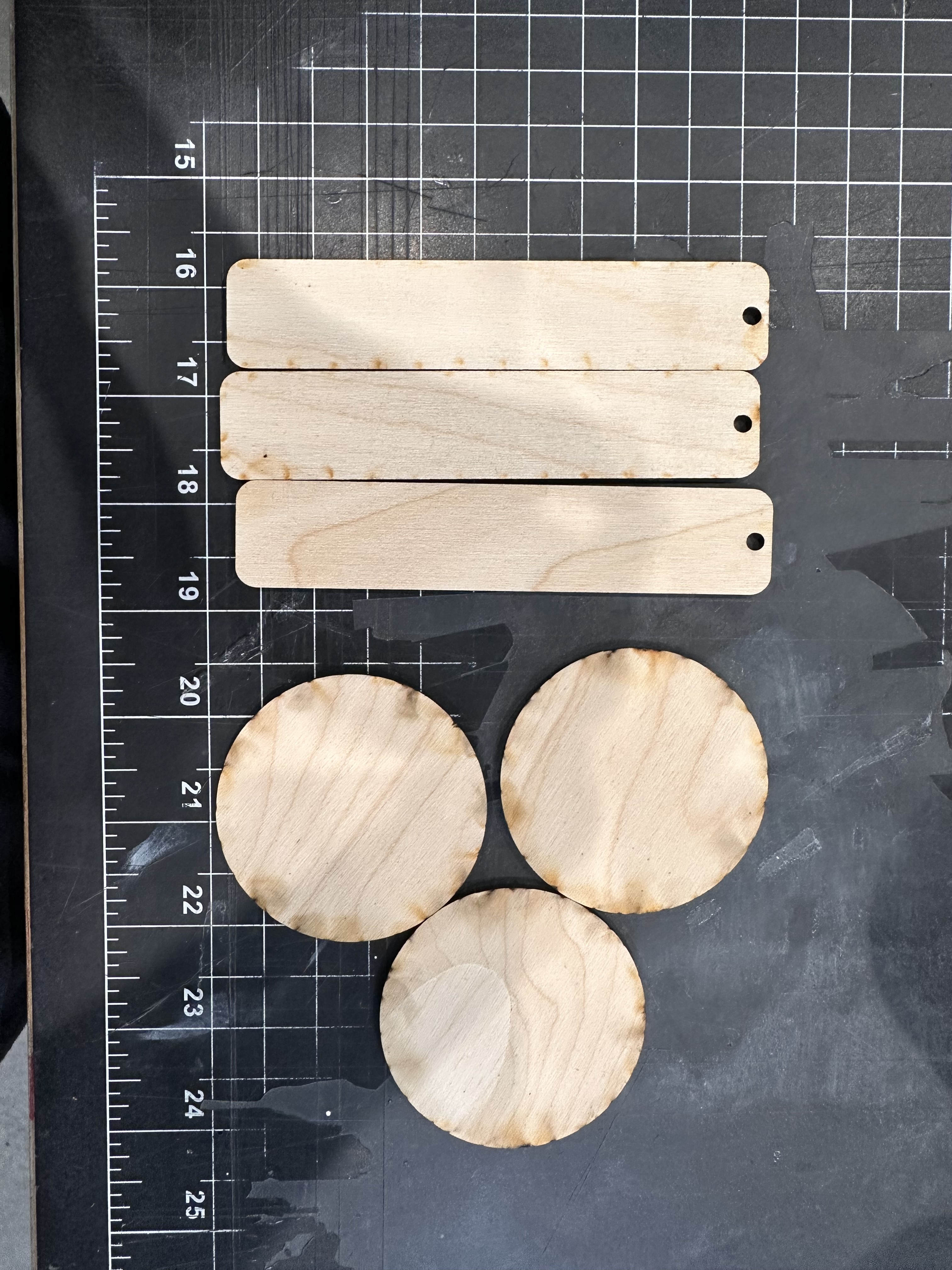

The left is how light the burn marks on the back used to be and the right is how dark they are now. Not a ton but makes for more sanding.
I can see where it’s reflecting from the honeycomb.
I assume I’ve oriented it correctly as there is no clear left and right, top and bottom maybe…
I’d suggest you double check your focus. Looks like marks from your honeycomb, but as if they were out of focus… Focus looks good on the top.

With that in mind, if those logos are Line engraved, rather than Fill engraved, then the laser head moves at much less than 350 mm/s around the characters, so a small change in beam power will produce a disproportionate increase in charred wood.
Because the tube won’t fire at much less than 10% and increasing the nominal layer speed won’t change the actual speed, the resulting burn may be as light as it can get. However, if you can apply a small Offset to the shapes and use a Fill layer, then the head will move at the nominal layer speed (back-and-forth across the design) and give you much more headroom to change both power and speed.
As @jkwilborn points out, those scorch marks on the back come from cutting directly on the honeycomb. Raising the wood a few millimeters will get rid of most of that, at the cost of somehow preventing the pieces from falling through and getting torched by a nearby cut.
