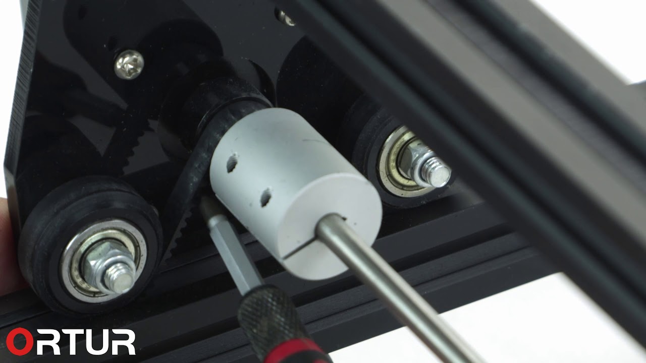

That’s not burning two passes, it’s the ‘return pass’ being misaligned with the outgoing pass because the belt is either loose (most likely) or too tight (less likely, but can also cause this).
I tend to be an over-tightener whenever I build things.
How can I make sure the belts are correct. Do I let them be naturally tight enough (no pulling it taut or feeding it back in to loosen it)?
Finger-tight only. No ‘boing’.
Loosen off, pull the pinion to take up the slack, only, nip up and tighten
Nothing should deflect in the pinion and stepper mounts if you pinch the belt together

From the video you sent all belts need tighetning
Specialy X + Y right side (cant see well the belt on left side)
In this case the problem gets more notorious on the X because the lateral left/side motion
As the laser head reaches the end of the line → slows down _> stops > reverses
The steppers pull to start moving the other direction but as the belt is loose those 0.5mm of initial motion simply are used to apply tension to the belt, THEN the motion starts. So you get 0.5mm each side of “slack”
You need to tighten them all nicely
Now Tight is a very subjective term but when you look at the belt on rest (no motion) in the vslot they should be in tension and not drooping into the slot
Made this very crude referece just so you can see how tight they should be. Again very hard to put in words even on video but if you press them near the sprockets they should not move more than a few mms
