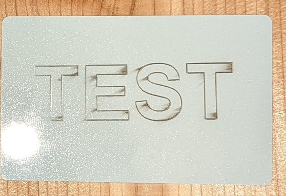

Laser burns outside framed target

THINK I HAVE IT FIGURED OUT

test2
Nice. What ended being the final fix?
Your suggestion to cut a frame, and then put the project material on the cut frame corner. Then I “absolute” my start point image from that corner point. I was brain fogged on the fact that the crosshairs and actual laser point were offset. Even thought the settings are(-16,0).
