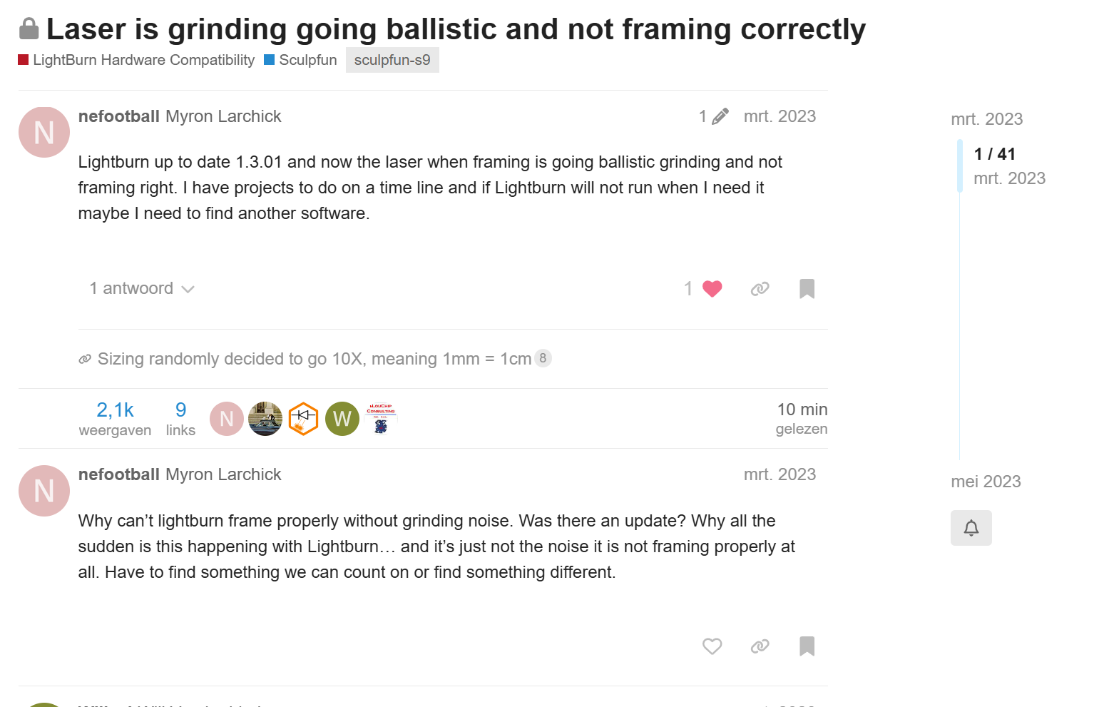

I’ve done the most recent update 2.0.01 and now nothing works anymore. My laser is a sculpfun s9 so it doesn’t have homing or limit switches, if i try to do frame it just keeps banging and grinding into the corners as if it’s lost. I’ve already tried resetting it and it still doesn’t work. I kept getting alarm:3 which now is alarm:9 in the console table.
Does anyone know how to fix this?
It seems to be the same issue as this person but i can’t seem to find an answer. If anyone knows that would be great.
