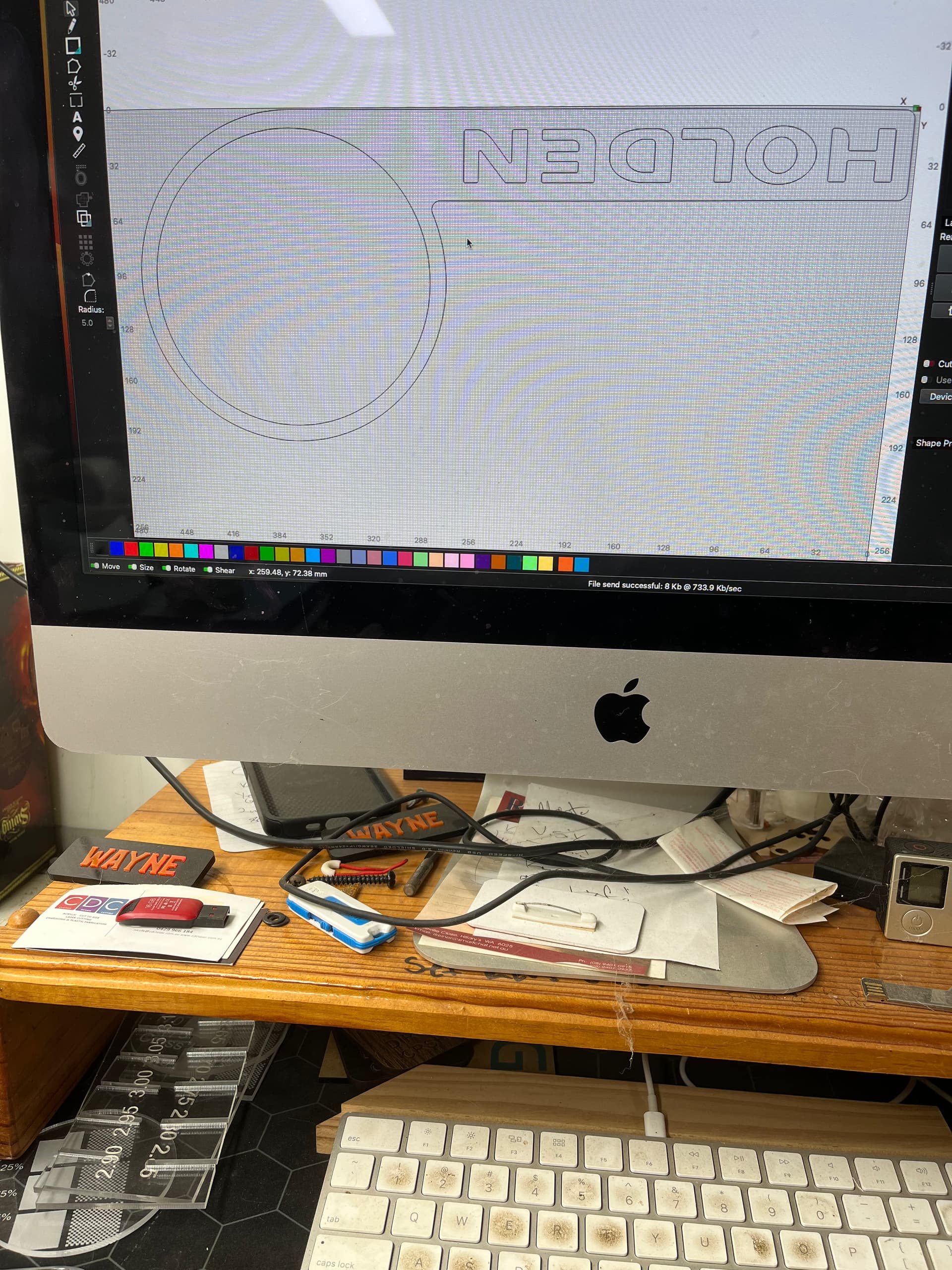

My laser is not following the path sent.
This is what I am sending.

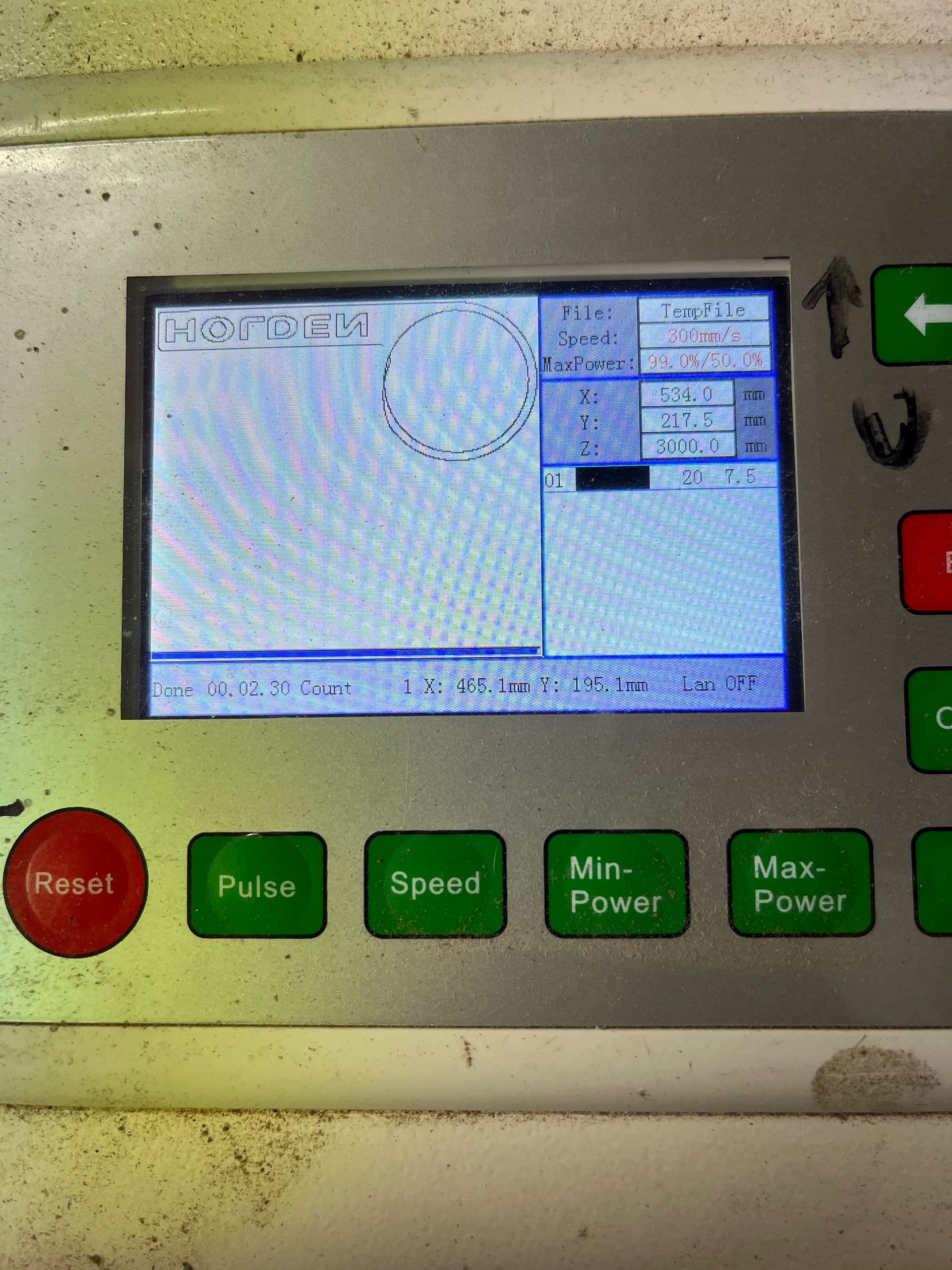

This is what my laser is cutting. It is different each time.
Also sometimes the laser won’t cut at all and just sits with the timer clicking over.
Could this possibly be a usb cable issue?

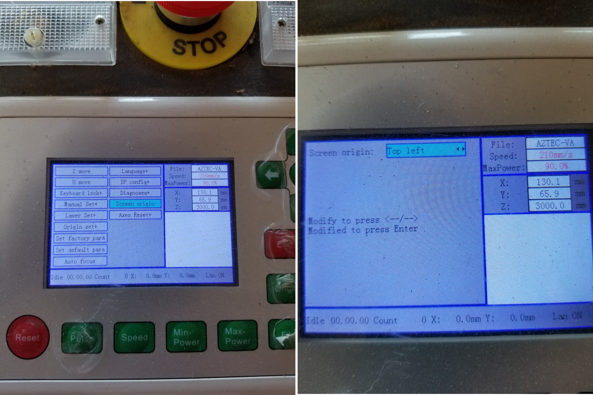

Ensure you have the correct origin position specified in Lightburn. It must match your machine.
You can flip which quadrant it thinks it using and that will flip the image.
Generally these are already setup and this is beyond most users. Wondering how this ended up like this?

With a Ruida controller and a Mac, almost certainly “yes”.

Thanks for this info. I have received poor after sales service from the company I purchased my laser from. They did not know how to flip the image so I just put up with it.
Onto the main issues, other forum users suspect that the usb cable may be the problem so I will get a new one tomorrow.
Thanks Ed. I suspected as much. I will get new cable tomorrow and do some testing.

If possible use an Ethernet connection to your lan. This is much more dependable and doesn’t depend on anything other than a network connection, that you already have in all likelihood. No drivers or anything to mess with.
I have mine on a $12 wireless router from Amazon , the machines in the garage.
If you have a spare PI laying around, Lightburn has the firmware for their wireless bridge available, they also sell the whole thing.. It is better, handles UDP traffic better…

Perhaps there’s something deeper going on.
AFAICT, there are three “origin” settings that must match:
The corner the machine homes at when starting up, determined by the hardware switches
The LightBurn Machine origin
setting
The controller’s Screen Origin
setting (as @jkwilborn described) should indicate the same corner.
The first two determine which corner LightBurn’s small red Origin
marker appears in.
In Absolute Coordinate
mode , that corner will also have a small green square marking the Job Origin
If that’s not what you eventually ended up with, let me know so I can once again stop thinking I know something.
