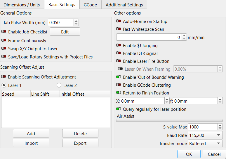

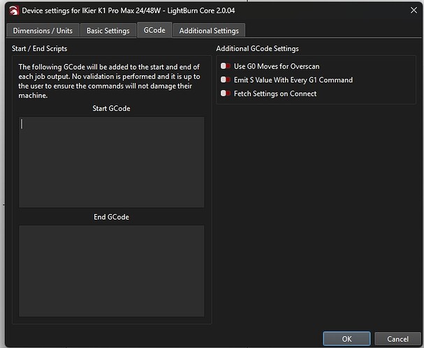

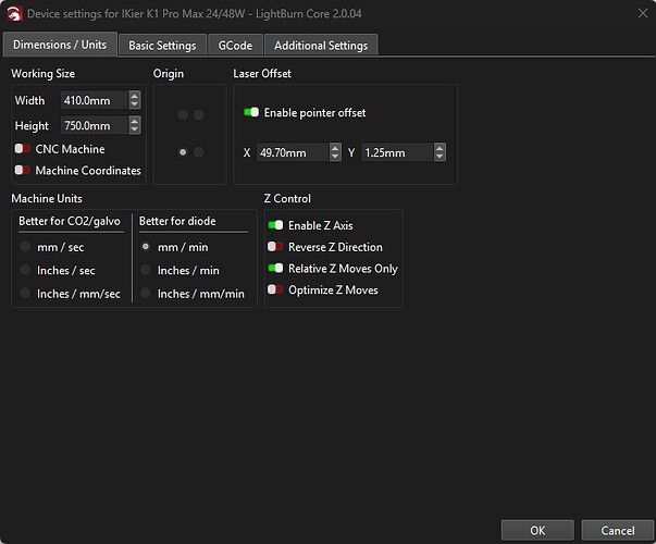

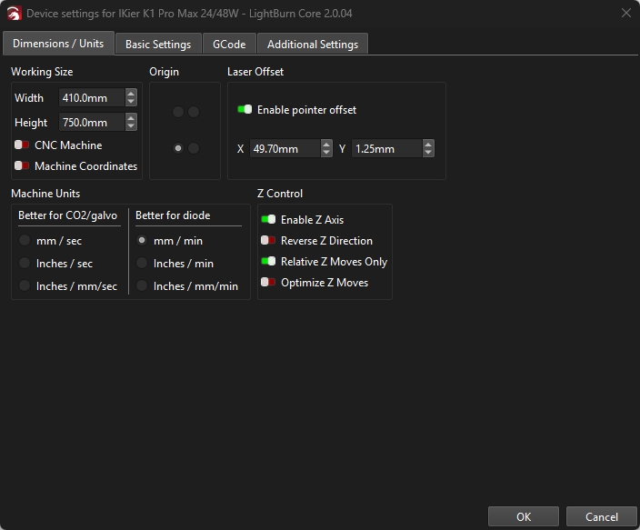

Show the device settings window to check.
Looks correct. Maybe toggle the “laser on when framing” setting just in case there is a glitch with it.

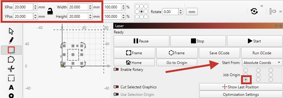

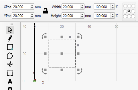

I did this test (on another laser without a red crosshair):
  • Draw a square of 20x20mm with the center located at 20,20
  • Select Absolute Chords as the start from option
  • Home the machine.
  • enable “Show All” in the console window

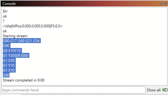

When clicking Frame in version 1.7.08, we send the machine this:
That’s the rectangle, counter clockwise.

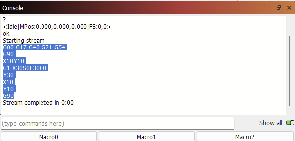

Whereas, in version 2.0.04 the same sends it:
That’s essentially the same square, but now clock-wise.
There’s absolutely no reason, that the crosshair should turn off only because of the direction of the move. (It’s additionally peculiar that it only turned off after the first vertical move in the video!)
The main difference I see is the G0 move on the third blue line. G0 in GCode is a (Rapid Linear Move)
And the added G1 with every line. Only the first G1 move includes a Feedrate (F3000). That’s normal, and a GRBL controller should properly use the last speed.

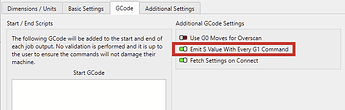

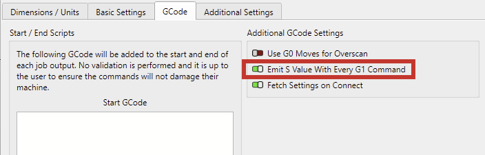

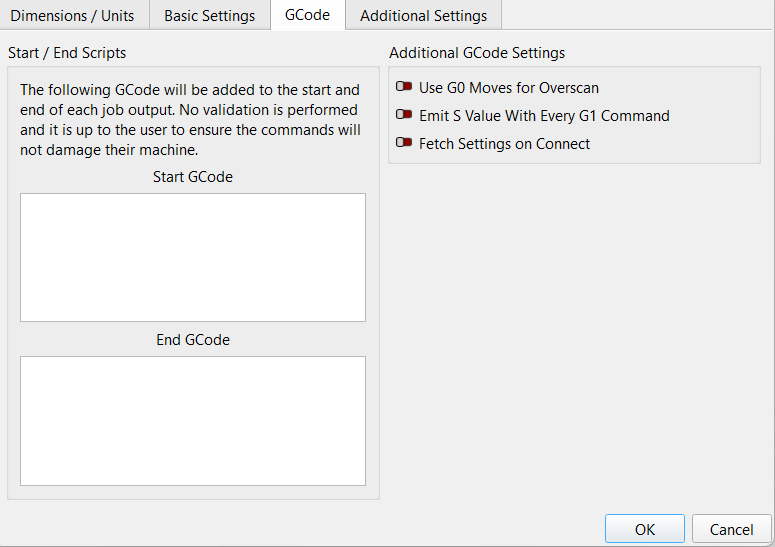

It’s a wild guess, but might help in the case. Enable “Emit S Value With Every G1 Command”
Then, send us a screenshot of the console after you followed the steps above, and let us know if the crosshair stayed on.

Tried with “Emit S Value With Every G1 Command” => same problem.

It would be easier to understand the numbers if you did exactly what I asked.
If the first block shows LightBurn version 2.0.04, and the second block shows 1.7.08, I can again not see any reason why the red cross would turn off!
You are sending it basically the same GCodes.

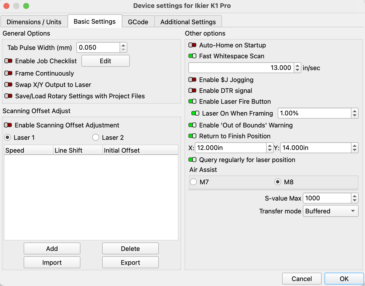

I found the same issue on my Ikier K1 Pro Max when Lightburn 2 was released. I was able to resolve the issue by Enabling the Laser fire button in device settings and enabling Laser On when Framing at 1% power. By enabling the Laser on selection, both the diode and the cross-hairs turn on when framing. Doesn’t make sense, but that’s what works.
Things worked perfectly fine without those selections prior to the release of Lightburn 2.
I should add that I am running Lightburn 2.0.04 under Mac OS Sequoia 15.6.1 on a Mac Studio
The screen shot of your device settings shows this:
This means you do not have the laser enabled when framing, as it requires the “Laser Fire Button” to be on first, and then the other toggle enabled.
This is behind a switch like this because we don’t have any way to know that you have a diode laser, and it’s not safe to use this feature with a laser that produces an invisible beam, like CO2 or fiber.
Thanks for sharing what worked for you, @markltucson !
Setting the Laser power to 0% might even work too.

Tested that you wanted on 1.07 :
G00 G17 G40 G21 G54
G90
G1 X30Y20S0F6000
G1 Y40S0
G1 X10S0
G1 Y20S0
G90
On 2.0
G00 G17 G40 G21 G54
G90
G1 X10Y40S0F6000
G1 X30S0
G1 Y20S0
G1 X10S0
G90
With a bigger one, I see the crosshair shutdown not due on movement, but due of time from launchig framing. On 150 mm square, stop crosshair 30mm after starting.
On 20mm, it beginning on the second movement. So, I think it’s not the movement the problem.

Mark reported that the problem was solved by enabling these two options in the Device Settings:
As mentioned, this option is dangerous if someone has an invisible CO2 or fiber laser and not a diode, like the iKier.
Set the Laser On When Framing to one %.
Nevermind, then. That macro is for something else. Thank you for reporting back.
Setting the laser power to 0% does not work. The crosshairs will still switch off. The laser power must be set to at least 0.01% for this to work (although this will also activate the laser head ventilation).
