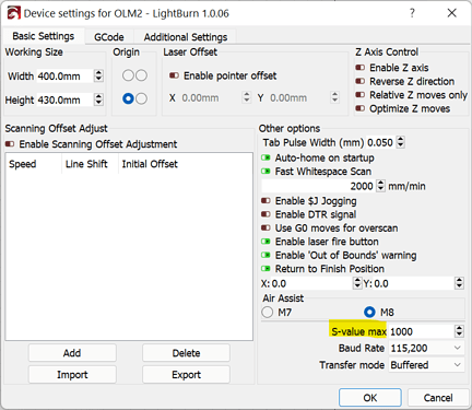

Had a chance to take a look. I think what’s happening is that on Linux the device setting is different for S-value max. Can you check that on Linux the value is set for 1000? I believe it’s 255 right now according to your preferences file.
Changing that to 1000 should give you the same performance between Windows and Linux systems.

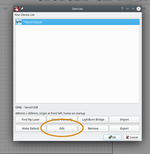

I had tried to edit the device setting via this entry
but that provided some other settings
I now cut just fine, thank you!
