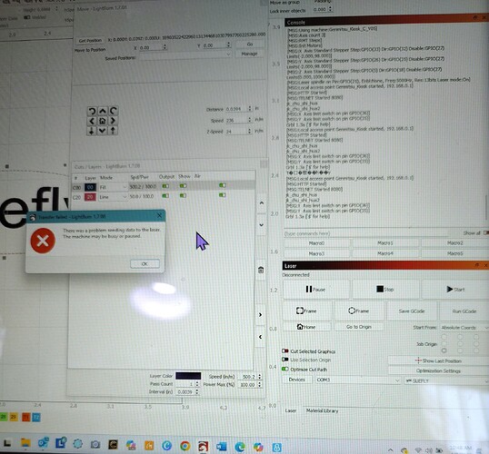

Lightburn is connected to laser with a cable. Status says “Ready” and laser is on. Yet when I hit Frame, or Start, Or try to move the laser, Laser does not respond.
Earlier today it did. but now it doesn’t . What am I not doing correctly?

It says laser may be busy or paused.
This morning, I turned it on and got it to work after moving the wires around. I think there must be a loose connection. ?.
It did the test job and stopped. But continued to say busy even after the job was removed from the laser.
I turned the laser off and back on. That cleared the status to ready. However it would not frame, run the job again, or let me move the laser head around.
“There was a problem sending data to the laser.
The machine must be busy or paused”

This morning I turned my computer on, and i turned my laser on. Set the COM. Lightburn says Ready. But console says “waiting for connection”
so I still do not have it working. Any other ideas?

No luck Mike. Best Buy doesnt know what a ferrit is. I brought home their best cable and tried it out. No Change.
Same status. “Ready” but “Waiting for connection”

This morning I turned on my laser and it cut 2 test projects! Then once again it stopped. Wont frame, wont cut. turned off computer and laser and retried from the beginning. No action. Laser says it’s ready. Console says it loaded. But no action.
