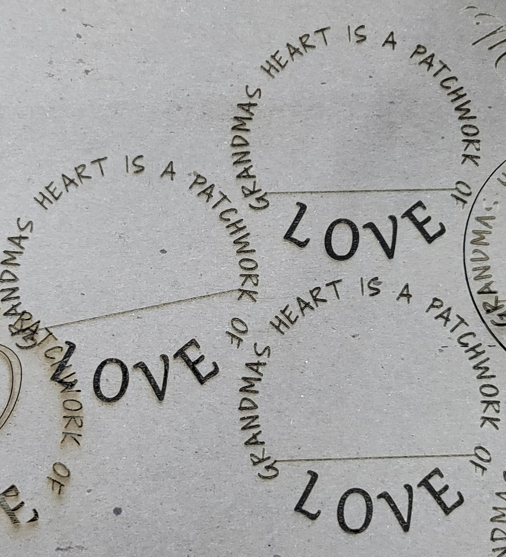

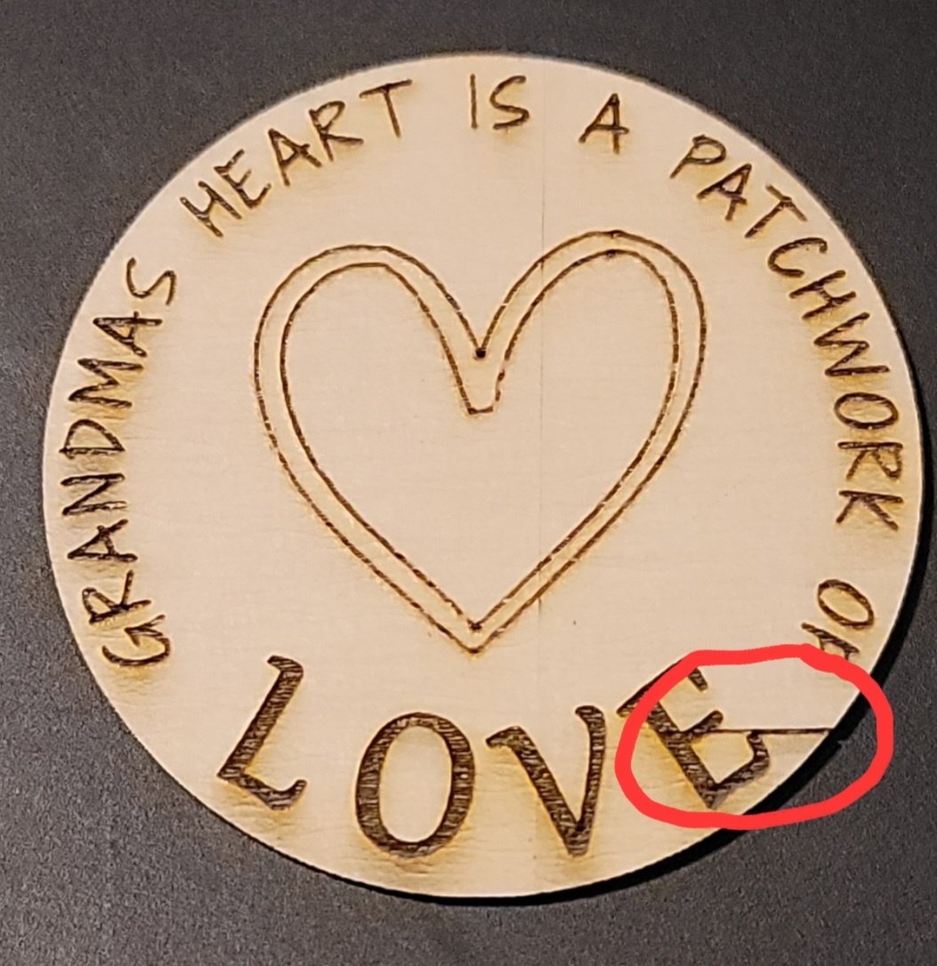

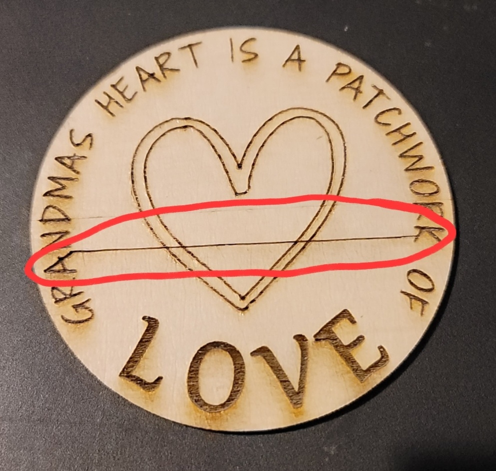

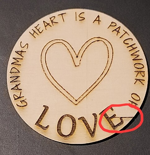

I’m experiencing a new issue I’ve never seen before after laser was idle for a while. Also recently upgraded to Latest version of LB (2.0.05). During engraving laser stays enabled during travel move but not consistent during run. The issue is repeatable when running same image back to back. I can’t find any settings to eliminate it but changing line interval will move the issue to another location. I tried different USB cables including shorter cables. Tried many various engraving settings including angle (0, 10, 45, 90), interval, changed the font, speed, laser power etc. Tried back-revving LB to 1.7, same issue. Two made from wood are during troubleshooting with different settings, other pic on cardboard shows repeated pattern when running file without changes the issue repeats in same place every time. In the past I never had issues like this but haven’t used the laser in a while till now and this issue is driving me nuts. Any ideas?
Changed to cardboard to minimize waste. Two on right are same file/settings ran twice one after the other (copied artwork and pasted), Left is angle changed to 10 degrees. I looked in the Gcode right around line 2200 and all travel moves have “S0” set for disabling laser during travel (see attached Gcode)

A repeatable failure means you can run the G-Code through a simulator, pause where the problem happens, and check what the power is set to at that point.
If the power is set to zero and the laser is still turned on, then it’s definitely a hardware problem.
A failing power supply or laser head need not cause random problems, because the pattern of operations may be what triggers the problem: the hardware is on the edge of failing and this particular sequence pushes it over the edge every time.

It turns out plenty of hardware problems are perfectly repeatable, because the job applies exactly the same motions & power levels every time. As a result, if the hardware only fails under those circumstances, it’ll fail every time they occur.
Have you verified the power level in the G-Code with a simulator to confirm or refute a software problem? If the power level is set correctly (at zero) in the G-Code, then it’s definitely a hardware problem.
I did look through the Gcode in a simulator at the lines around where the issue happens repeatedly. Indeed the power level is zero during those travel moves, So I agree it seems to be hardware, though I don’t know how Lightburn streams to the controller either. Is there a buffer at the controller that lightburn is keeping full? I have tried different USB cables, checked power, and motor cables to and from the controller. I think I’ll try reinstalling my old Arduino Mega Ramps setup I ran with for a while before upgrading to this 32bit controller.
