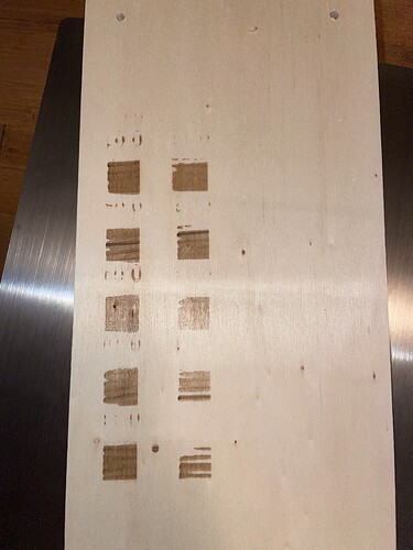

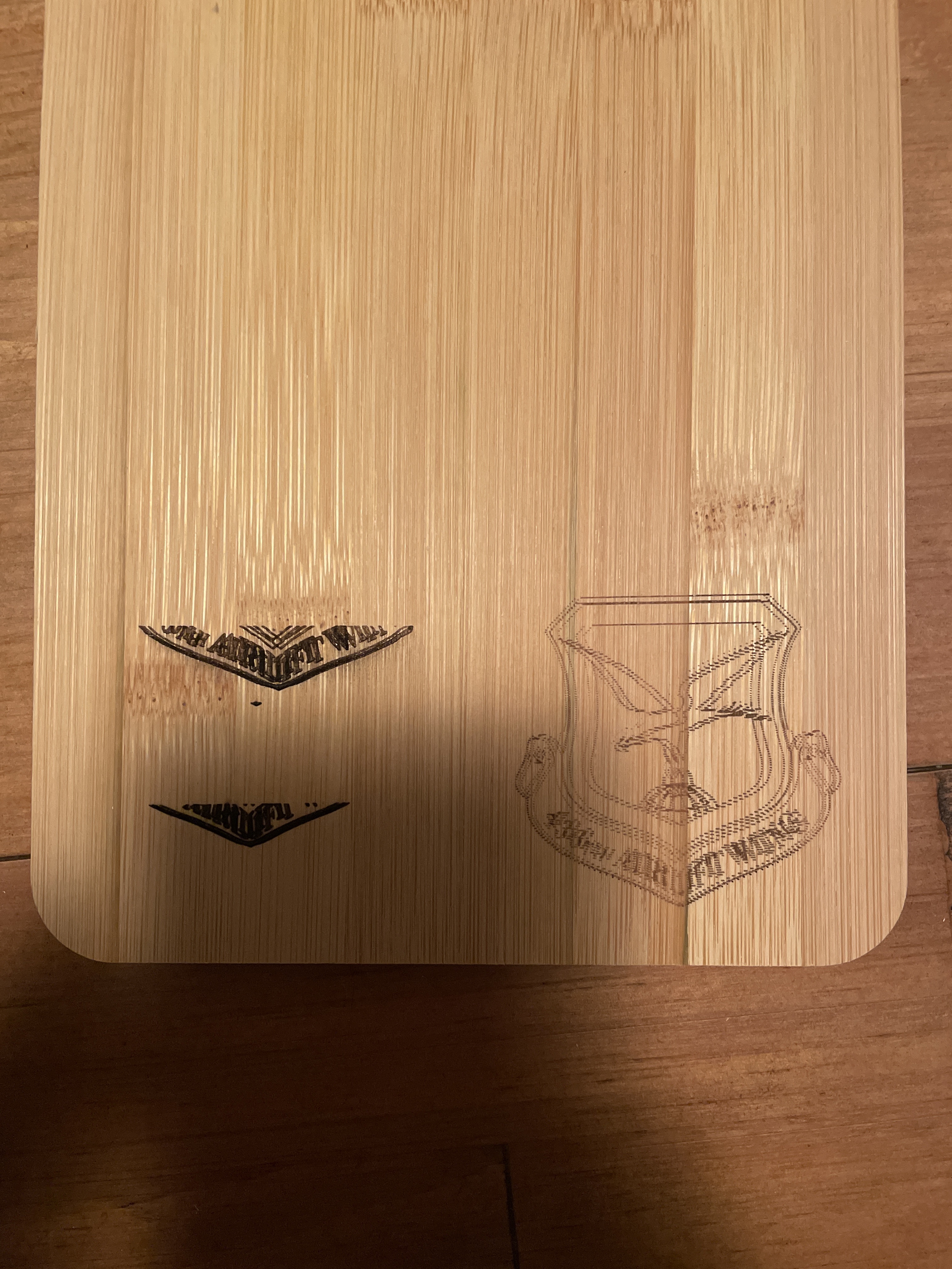

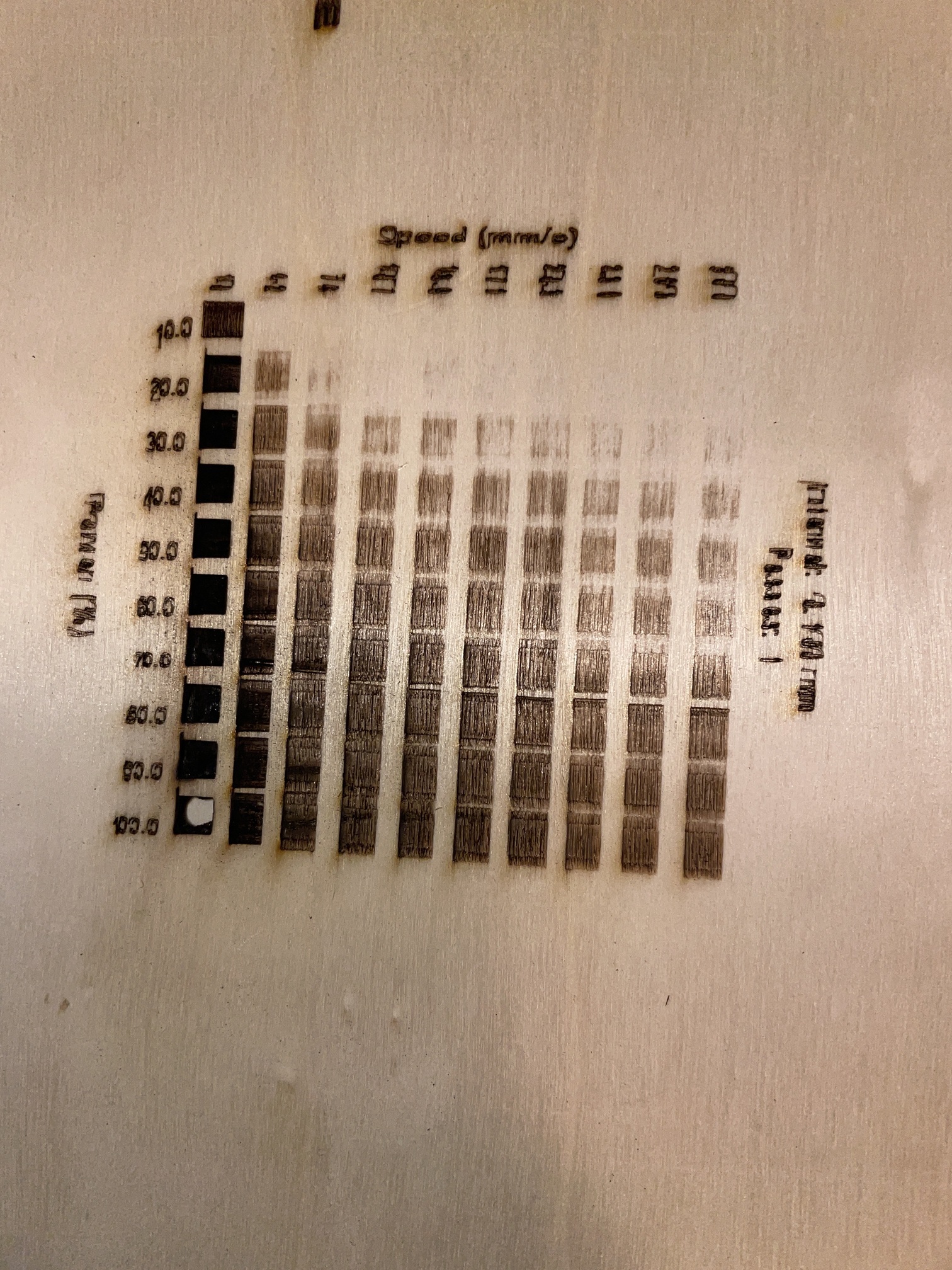

I just set up my ATEZR P10 Combo yesterday and haven’t been able to engrave any letters or numbers correctly. I don’t understand what I’m doing wrong I attempted to run the interval test and the numbers on that test still failed. I have never used an engraver before and just need help because I can not figure it out
The patterns suggest the laser is not focused correctly.
