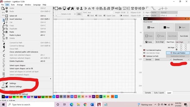

I have a Full Spectrum MLE-40 Smoothieware using a SmoothieBoard v1.1 as a controller. the laser fires and engrave, but images come out of scale/wrong size. A square 100x100mm comes out as 229mm wide by 70mm high. I have changed the steps per mm in the configuration with no changes at all. I ran the same test in another smaller laser running on grbl with the same results. The edit tab is not showing the machine settings option.
Please help.
What edit tab are you referring to? Screenshot please.

I got the machine from a friend that could not use it anymore due to poor health. I would have to ask, but the original board is broken.
I thought the same. I changed the steps per mm as low as 10 in the Alpha and as high as 160 on beta and changed vise-versa, with no change at all. I connected a small machine that I have, connected to Lightburn. It was recognized by Lightburn as GRBL, printed a circle with 60mm dimensions and it come out as an oval. The Y-axis is always shorter and the X is always larger than the desired size.
You’re looking in the wrong place for Machine Settings.
Go to Edit->Machine Settings to see your GRBL configuration. I don’t know what this looks like for Smoothieware, however.
Did you try to make any changes to remedy this? If so, where? First make sure there’s no mechanical problem causing one direction to bind. The laser head should move freely in all directions. If that’s not the problem then you can calibrate axes in Edit->Machine Settings->Calibrate Axis for the GRBL machine.
Can you show the exact before and after configuration change please?
The problem is that I can see the Machine Settings under the Edit section. Is this normal for smoothieboards?
Probably so since configuration for Smoothie is done in a configuration file.
