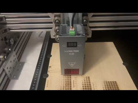

Hi All!
I have a Openbuilds Custom CNC that uses X32 blackbox controller running GRBL HAL (Build 20230501). My issue is that the machine stutters (likely taking pauses with every change in power value) leading to engraving being super slow. A 2 min engraving file (based on preview in Lightburn) takes well over 10min on the machine with speed no where close to my engraving speed of 12000mm/min. Running Grayscale image more of Jarvis - no constant engraving speed…the laser seems to be firing up correctly but engraving doesnt take place. When I run material test setting, I can get engraving even at 20000mm/min speeds. unsure what is going on but any help troubleshooting this would be appreciated

Also, have set S value max of 1000 in Lightburn
Please help!

Thanks for your response. Please see all the things you asked for below:
Device Settings Window:
Console Window:
I ended up recording a video to demonstrate the actual issue - please note that I decided not to supply power to the laser since I had already run this job with laser turned ON previously and decided to re-run the same program from same spot as previous. Video here:
The gcode file as you had requested here:
12K_Grey.gc (653.7 KB)
Lastly, this is the image I was trying to engrave:
And this is what I got below highlighted in the red rectangle:
As you can see only the darkest regions are getting engraved when I know that my laser is fully capable of engraving at 12000mm/min even with 30% power…
Hope this information helps… Really looking forward to fix this issue. Many Thanks!!
I see nothing wrong with the GCode that could cause the awkward pausing.
This is a very helpful image. Thank you.
This generally indicates that the selected engraving speed is too fast for the range of power applied. The 90% power setting is reasonable. You may find that selecting 9000 mm/min improves the gradiant of the engraving.
The GCode shows that your ‘Greyscale’ image is dithered. If you’re attempting to achieve Greyscale shading with a diode laser (without dithering), you’ll want to change your Image Mode in Cuts/Layers. Double-click the Image layer in the Cuts / Layers window to open the Cut Settings Editor, and when you are satisfied with the settings, click OK to make sure they are set.
The lower, speckled image in the work space is a faithful import of the GCode showing the dithering effect. The upper (selected) image is the image file you provided.
I haven’t tested the different Image Modes to see which is more memory intensive, but this may help.
