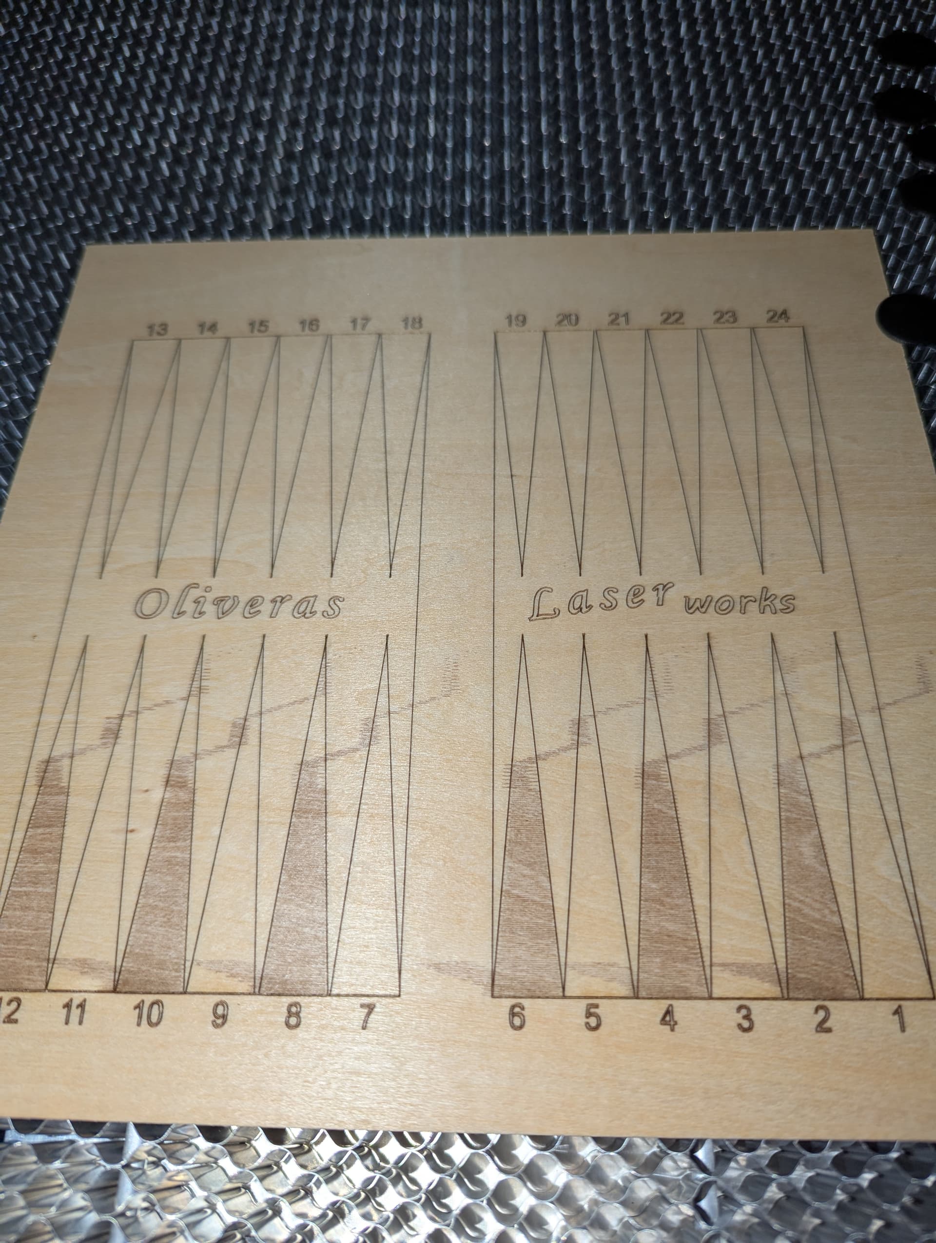

Dear friends: I’m new on laser engraving. I’m trying to make my first laser work but something is not working properly. I don’t know if the problem is from hardware or software. I am working on an Acmer P2 33w brand new. The problem is when filling. As seen on the picture all text and lines are ok, but the filling is mis aligned with the lines. Could somebody help me to solve this problem? I’m working on Light burn 1.7.08
If you halve the speed and power, do you get the same result?

Speed and power halved but same result.

Based on your image, I am guessing it is a hardware problem.
Hi Mike. Fortunately I found the problem. Speed and power was extremely hight. I lowered speed and power considerably and problem disappeared. Also I adjusted line intervals. Now I need to make a fine tuning for a perfect finish.
You would be surprised how often this causes a problem. Product specifications inflated cause this issue. Glad you got it figured out.

The advertised max speed of 30,000mm/min may have been achieved with the much lighter 5w module? …and possibly without regard for accuracy?

You can tell a laser to run any speed, it will limit that speed to whatever the controller is set and will not advise the user of the issue.

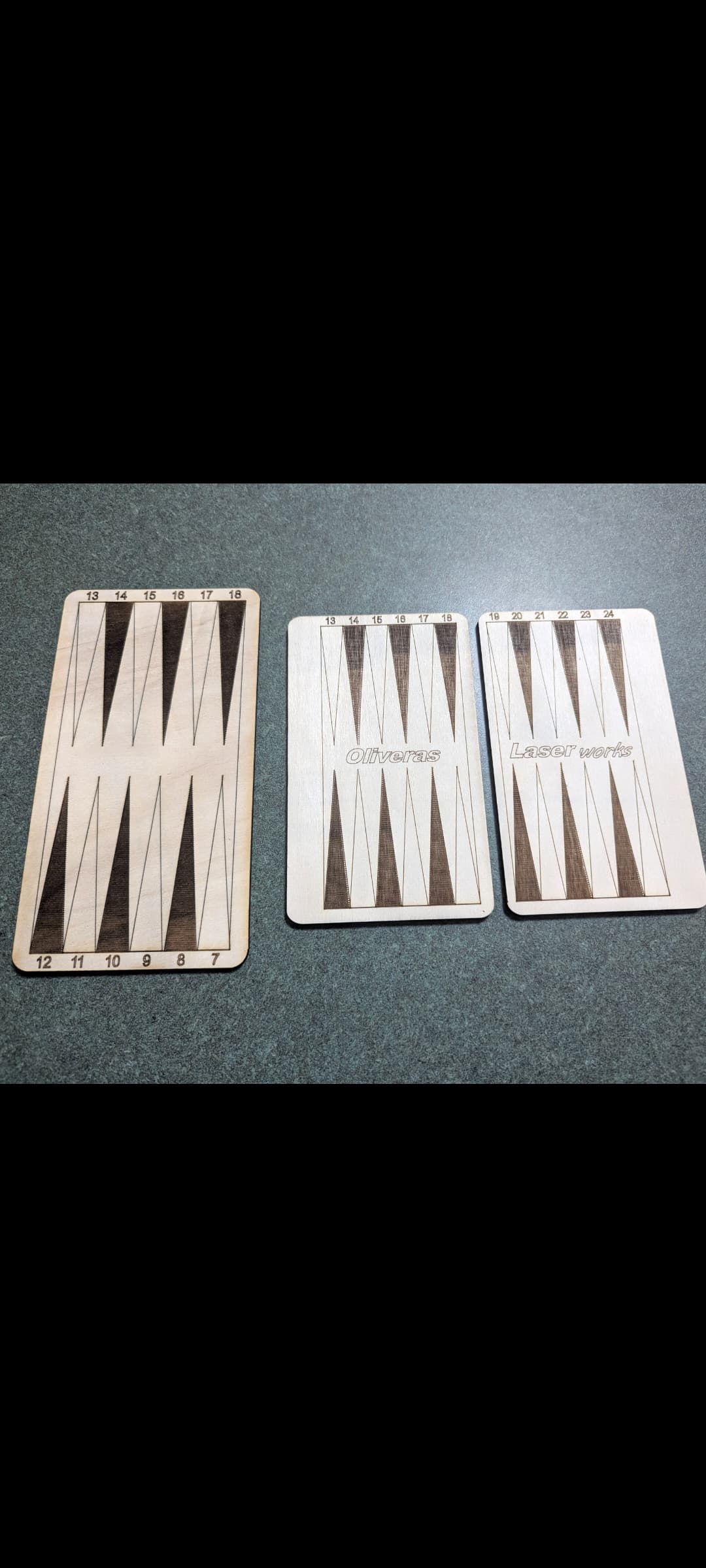

I’m using a brand new Acmer P2 33w laser diode machine. I set the speed to 1200mm/s @30% power and .300 line intervals for filling engraving parts of the design.
1200mm PER/MIN might work a lot better. I think you find it in Device settings.

Right. 1200mm/min.

I doubt that 33w diode is capable of this resolution. You are burning over already burned passes.
I would drop the LPI to about 254, or even less to save a lot of time.
Update: I looked at the file and your LPI settings appear to be appropriate for the layer being processed. I wonder now why you said “300”…?
