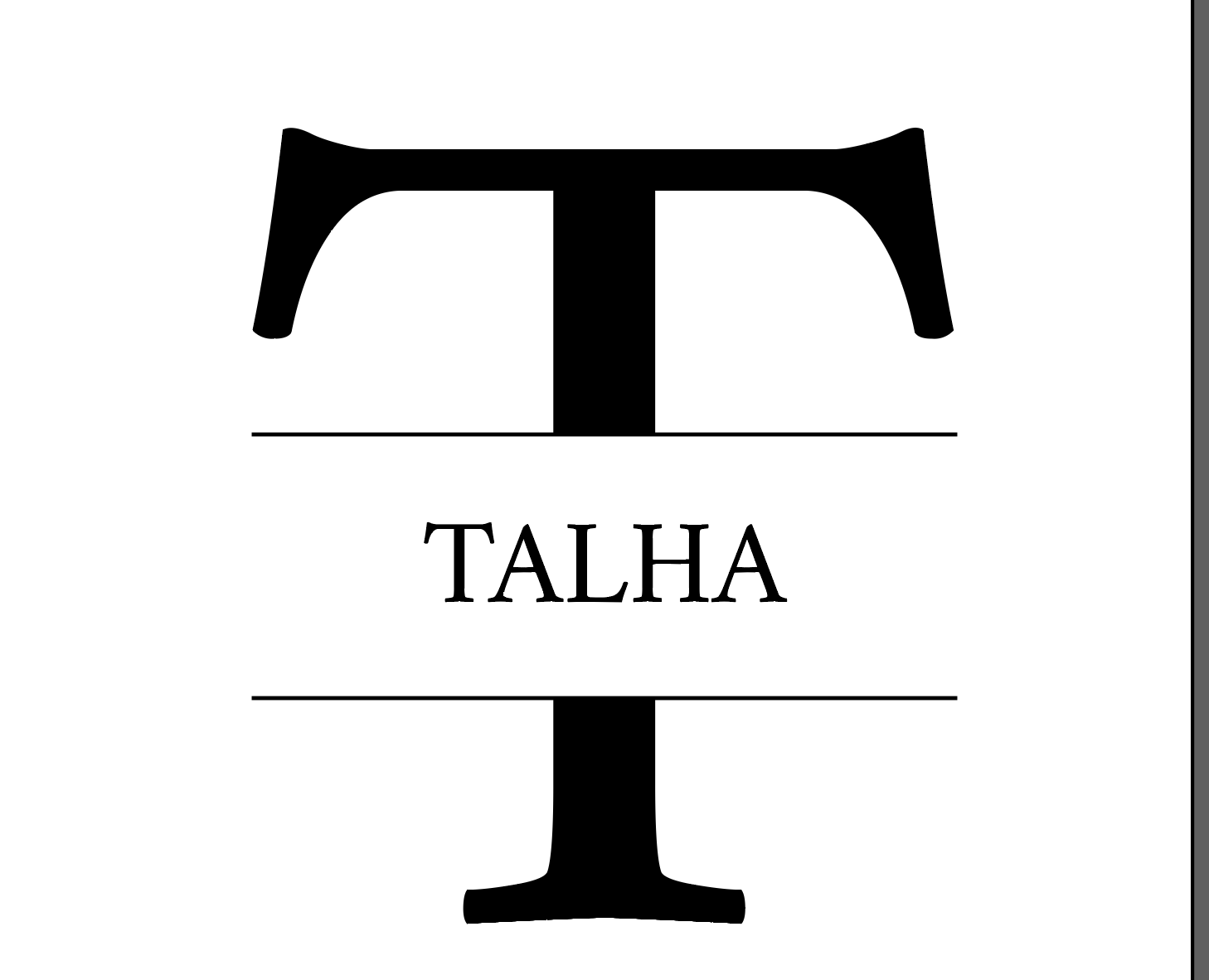

Hey, right now at this stage I’m just trying to make the templates and I’ve seen some tutorials but they custom modify every letter, I want something like a font where I have a bunch of templates like this, where I can just change the letter and the name, this design was made in Illustrator by me but its hard to make in Lightburn
Thanks, but how should I practice, I really don’t have the time to custom make every letter every time I get an order
You only have to make 26, right?
Make what you have drawn above, but put the letter on one layer and the text in the middle on a different layer. Then just edit the text layer when you get a new order.
Design your letter with bars in Adobe, then import into Lightburn. Do a trace on it and add text between the bars on a separate layer. Save it as a reusable template.

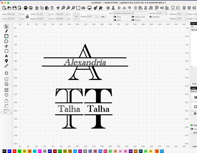

The little example here is made exclusively in LightBurn, with standard font and standard tools.
Time, I made coffee, read mail…and wondered how you can mark your question/problem as solved, when you haven’t understood it, - so - I would say I spent maybe 10 minutes in total for all 3 examples. (Mike’s explanation says it all, I just visualized it in LB.)

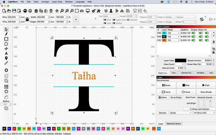

Hey, thanks Bernd, I have understood how to properly use lightburn and used a helper to help me find what tools I need, I have successfully made this template and hope to make many more
Here you go. Whole alphabet in split letters.
Download this file and change the extension to zip.
Then unzip the files
